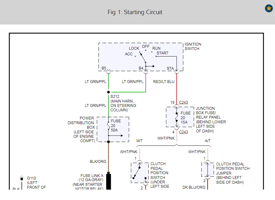

I turn the key and I hear one click then it all goes off.
Aug 19, 2019 at 8:22 AM
Good evening,
Sounds like you have a low battery. Check the actual battery voltage with a voltmeter and also make sure the cables are tight and clean connections.
Aug 19, 2019 at 8:45 AM
SCGRANTURISMO
  • 4,897 POSTS

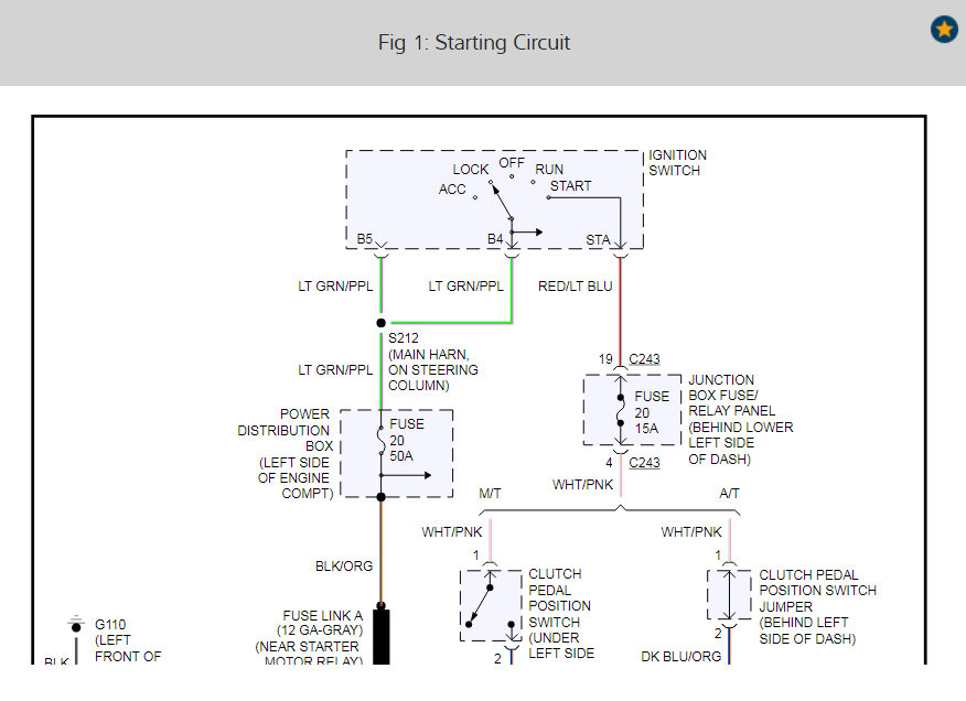

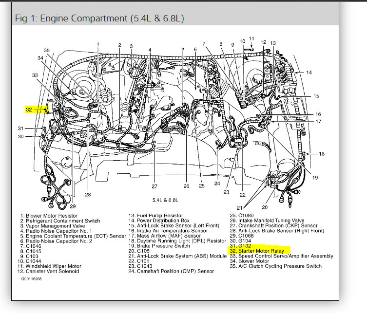

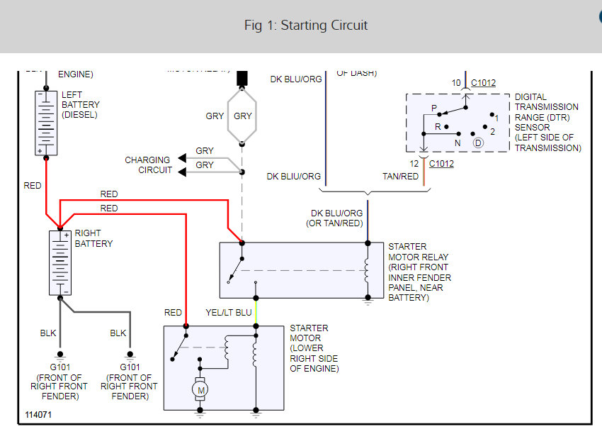

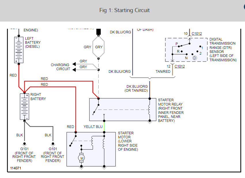

This sounds like you could be having a problem with the Starter Motor Relay which is located in the right front inner fender well, near the battery. In the diagrams down below I have included a wiring diagram of your vehicle's starting circuit as well as a diagram of the Starter Relay location for you. Here is a link for you to go to on how to test a relay:
Please go through these guides and get back to us with what you are able to find out.
