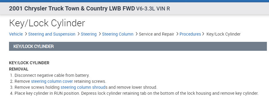

My ignition switch locked so it was replaced the key turns now but it will not crank it makes no noise at all. could the battery be drained, and could the battery being drained cause the ignition switch to lock?

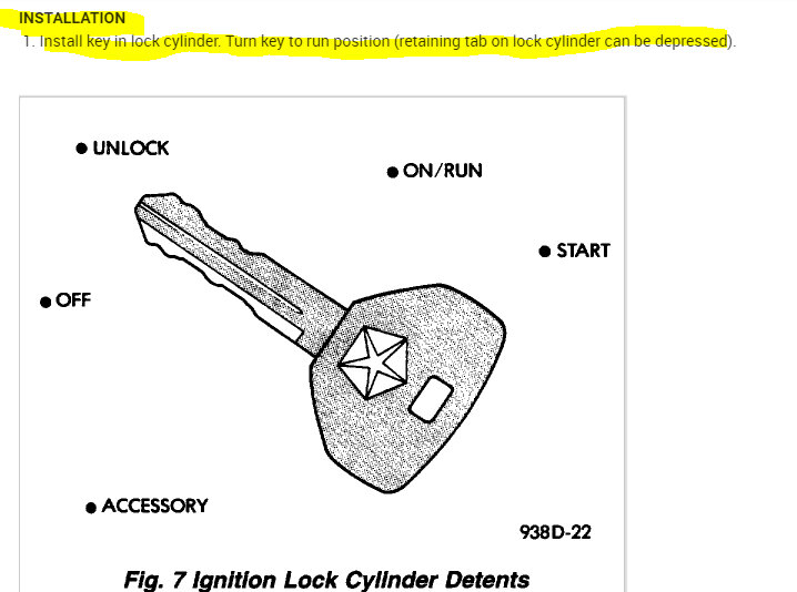

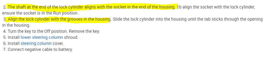

As far as the switch, was it the actual switch or the key/lock cylinder where the key goes? I ask because the lock cylinder is inserted at the end of the housing opposite the ignition switch. If it wasn't properly installed, it may not be making contact with the actual switch. Take a look at the directions below for replacing the lock cylinder.
I don't know if you or someone else did the work, but if it was you, see if there is anything in the directions you may have missed.
