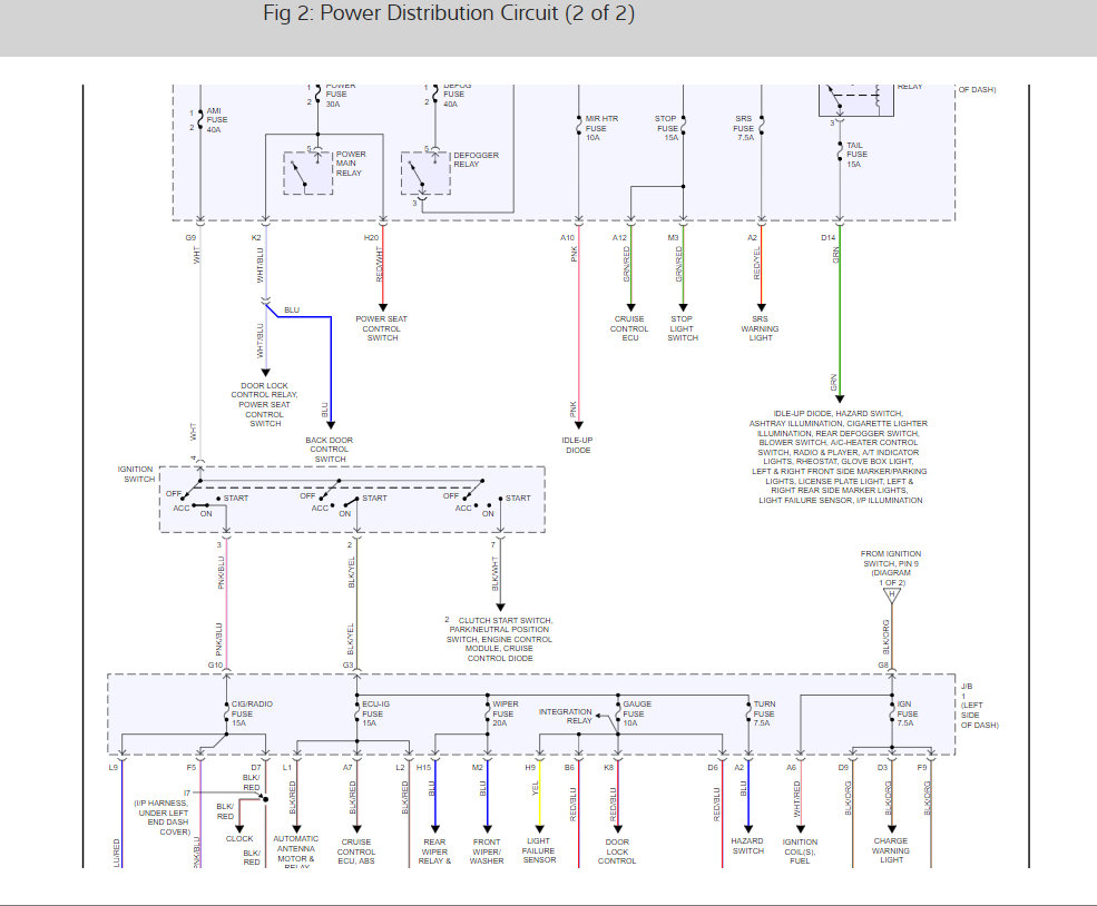

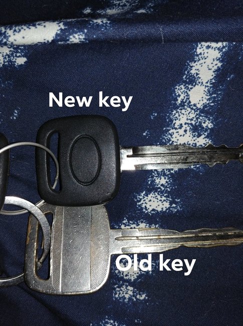

My car was running completely fine and then my key wouldn't turn past the lock position. so I changed both the key part as well as the electrical part of the ignition switch, but now it won't start. it acts like it wants to but it's not getting a connection somewhere. is there a fuse, ground wire or something else I need to check?

My keys don't have chips in them so there is nothing to program. is there something else that it could be?

If I can jump in here. it sounds like the electrical part of the switch is defective. I would get a replacement. To be sure here is a guide to help you check for power and the ignition switch wiring diagrams to help you confirm the issue:
Check out the diagrams (below). Please let us know what you find.

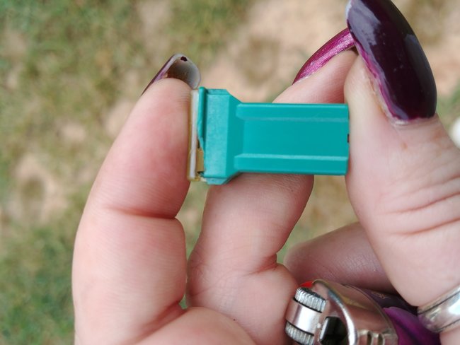

It was a $5.00 40A fuse that was hidden behind the air vent tube under the dash!

TRACY ALLTOP TEAGUE
This was the problem.
