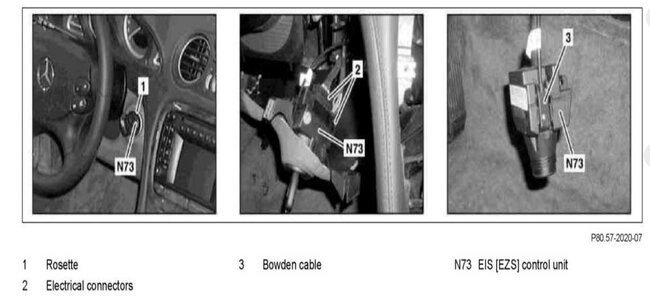

I bought an ignition with the key fob from a junkyard, is it compatible with my vehicle?
180,000 MILES • 0.5L • V8 • AUTOMATIC
PAULPAULPAUL
I have the vehicle listed above and I lost the keys. I called somebody that came out and said that they took the whole ignition out and said they needed to take it to get keyed. I have been able to get a hold of the guy who wants 2 weeks. so, my question is, if I purchase an ignition with the key fob from a junkyard from the same make model and year and engine size would it be compatible with my car?
Aug 16, 2024 at 12:33 PM
  • 55,770 POSTS
Hello Paul,

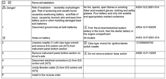

It will bolt in, but you cannot install it without having it reprogrammed. You might be able to get a preprogrammed unit if you search google or eBay. Also, I would call a mobile locksmith to come out to do the job/program the ignition key it should cost about $250.00. Here is more information on the repair. Check out the images (below). Let us know how it goes.
