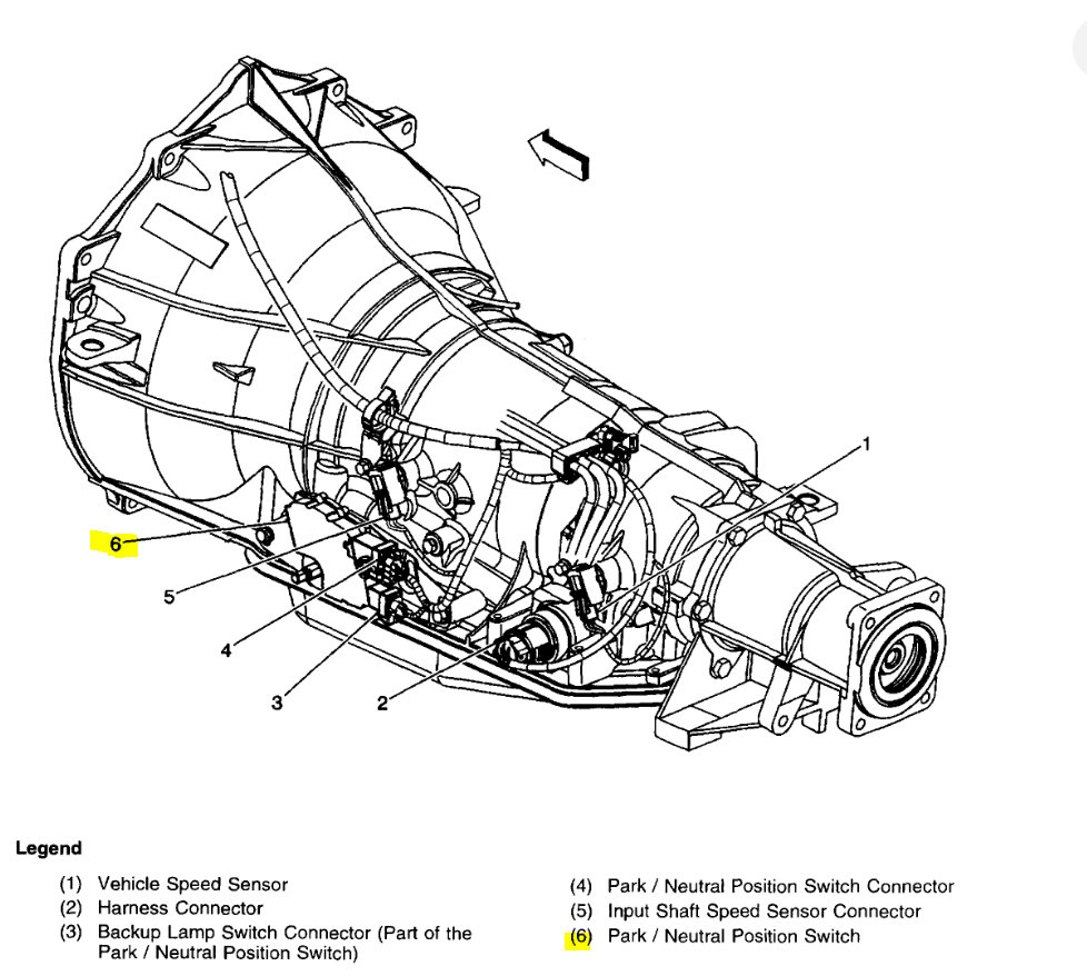

Okay. So, I had my 12v cigarette lighter plugged in too long and now half my day doesn't work nor does my radio. And when I go to start my engine while I'm parked it keeps turning itself over by itself. So, I switched it to neutral and it's starts okay. What do you think the problem is?

This could be due to a faulty neutral safety switch.
The neutral safety switch signals when the vehicle is in park and allow the engine to start.
It is located on the side of the transmission.
Here is a helpful guide:
https://www.2carpros.com/articles/how-a-neutral-safety-switch-works
I have attached a diagram below for your reference.
Let me know of any questions.
