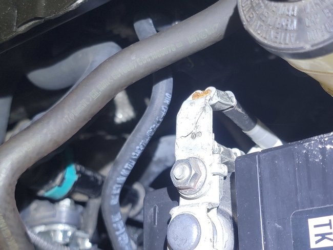

Was checking out my battery and noticed this. I don't know if it is new or it was always there.
Oct 1, 2021 at 3:40 PM
SQM
  • 6,383 POSTS

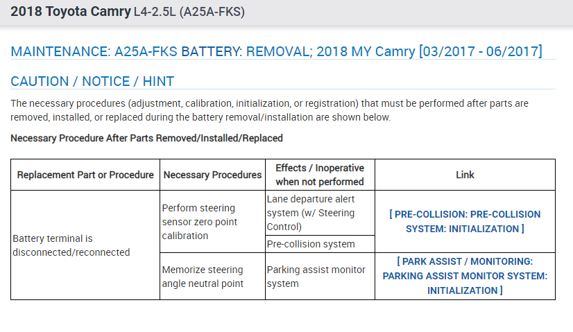

The battery cable is normal. I don't know why Toyota does not put an insulation on the wire at that connector.
Any time the alarm goes off you should be able to turn it off by pressing the lock and unlock button on the key fob. If that does not work, then you will have to put the key in the ignition and turn to on position.

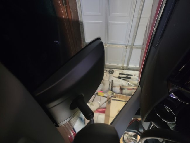

I want to install a dashcam for the front and back but my only concern is if it will affect the warranty (I have it for almost 3 years) the dashcam requires me to swap out the interior rear-view panel with a new one?
Oct 15, 2021 at 12:31 PM
KOUBEAR
  • 43 POSTS
Ever since my accident I been wanting too. Would you consider that a modification?
Oct 15, 2021 at 12:35 PM
KOUBEAR
  • 43 POSTS
The camera I want to install.
Oct 15, 2021 at 12:36 PM
SQM
  • 6,383 POSTS
As long this is a plug and play and you are not splicing wiring, this should not affect warranty.
