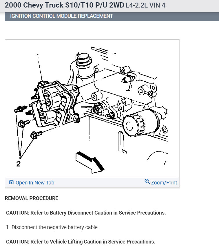

The ignition wires can cause this problem, if they are not correct or of good quality (AC Delco) the coils will not work right, also remove the coils so make sure the connection to the ignition module is good and clean. If you have crack one of the spark plugs on 1 or 4 you will have low spark as well.
https://www.2carpros.com/articles/how-to-change-spark-plugs

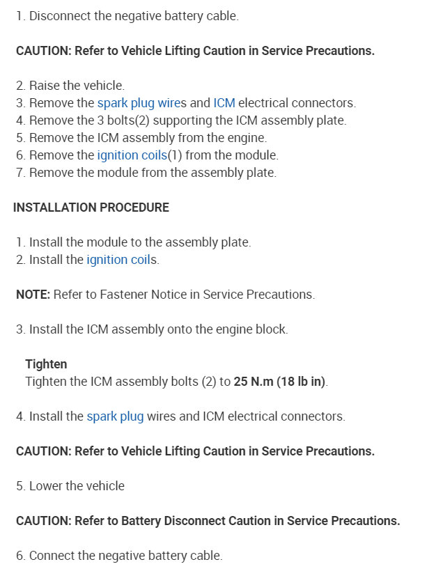

If everything checks out, I would replace the ignition module here are the instructions the diagrams below. Check out the diagrams (below). Let us know what happens and please upload pictures or videos of the problem.

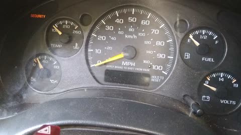

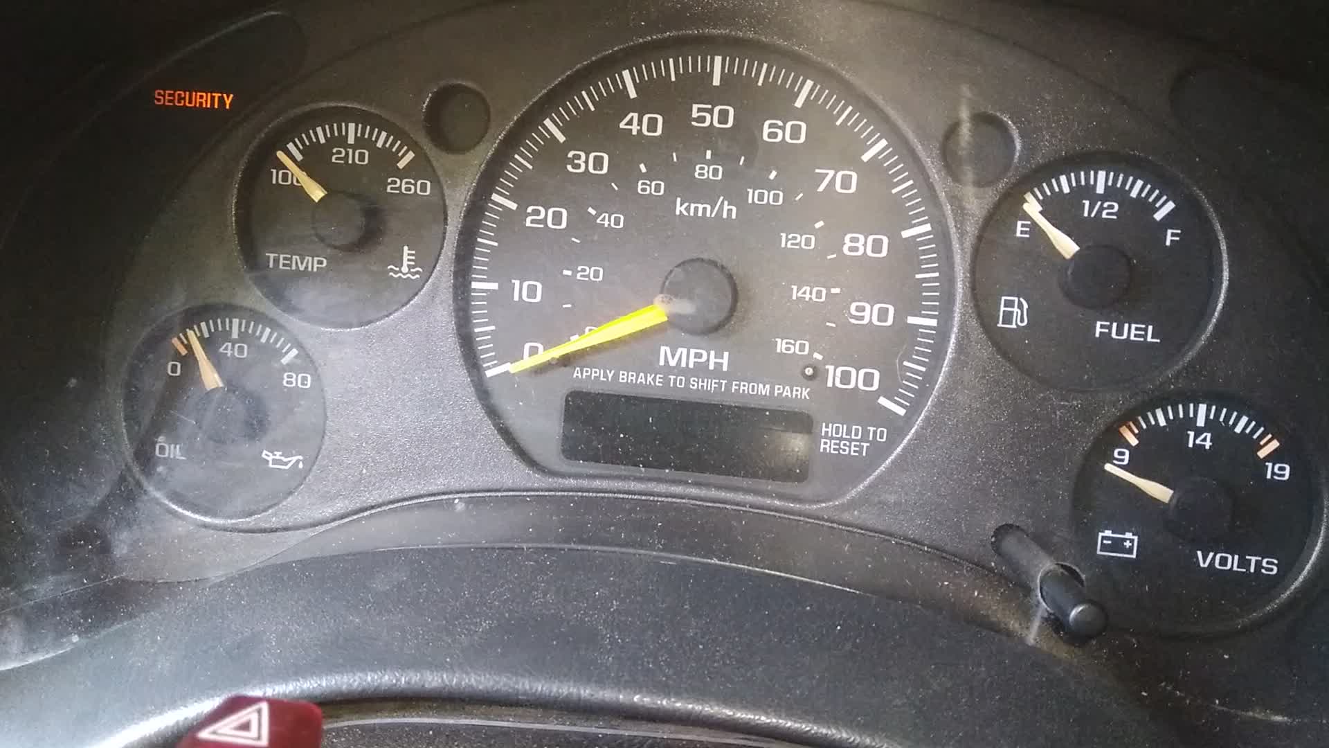

If you can take a short video and upload here in your response of the engine cranking over, I can tell for sure. Also, we only handle one question per thread, please start a new question about the stereo issue.

Okay, I will add two videos if I can. I am a double amputee so I'm not fast as regular people getting In and out of the truck.
Aug 9, 2022 at 1:27 AM
KEVINSWORLD812
  • 14 POSTS
Okay, that's the first video here's the second.
Aug 9, 2022 at 1:33 AM
  • 55,394 POSTS
Thanks for the videos, they help. It seem like you have a blown head gasket between to cylinders or you have burnt valve causing the low compression. You can get a compression gauge from the auto parts store, either for free or rent, it should be much, then follow the guide above.
