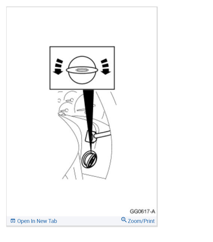

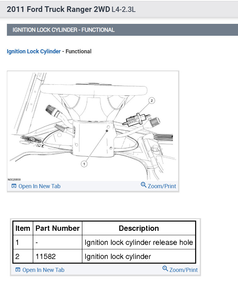

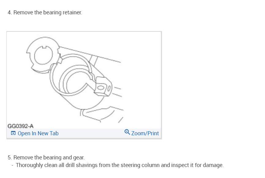

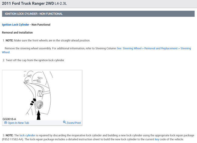

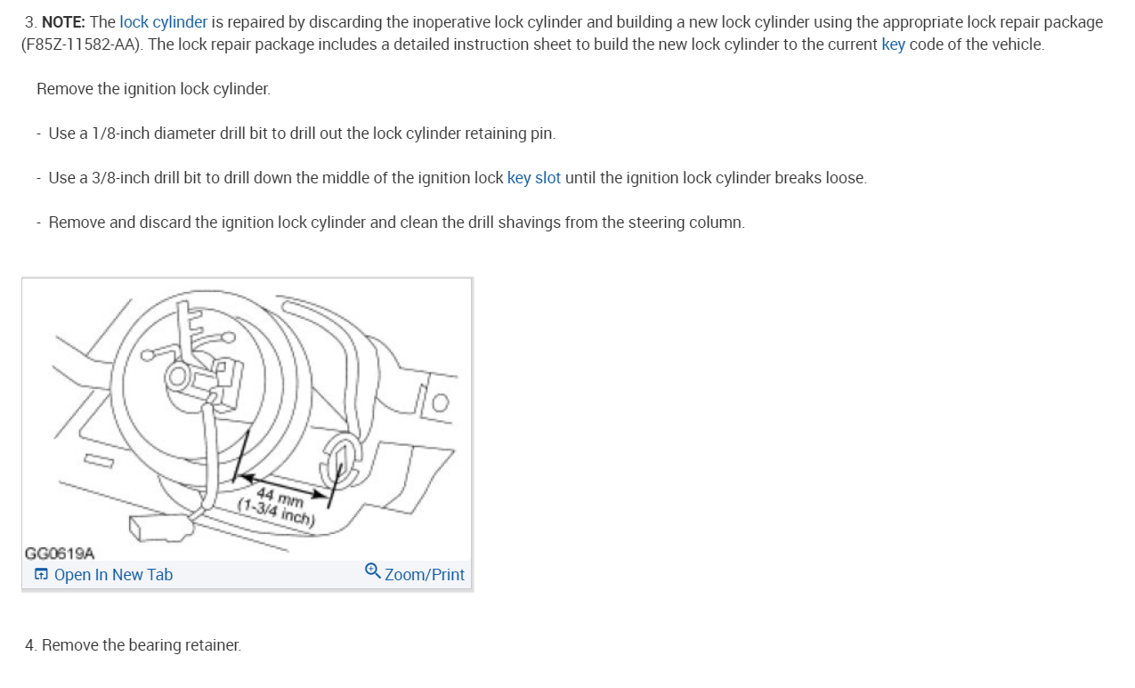

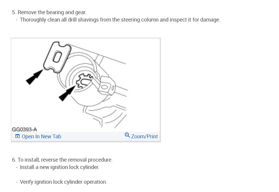

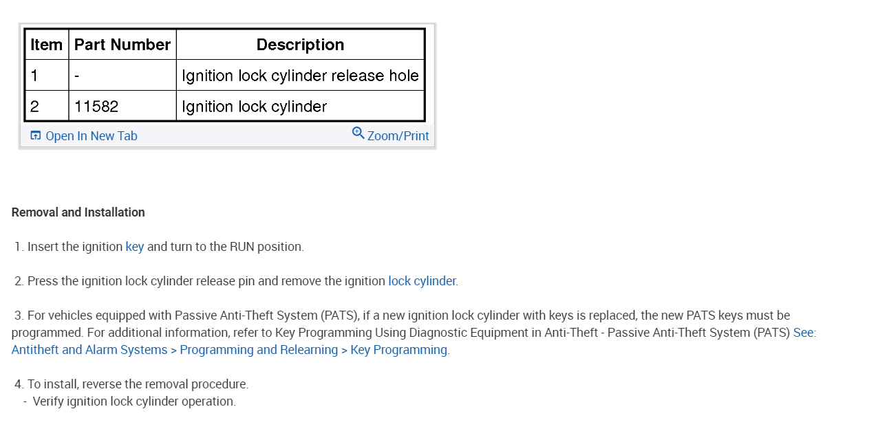

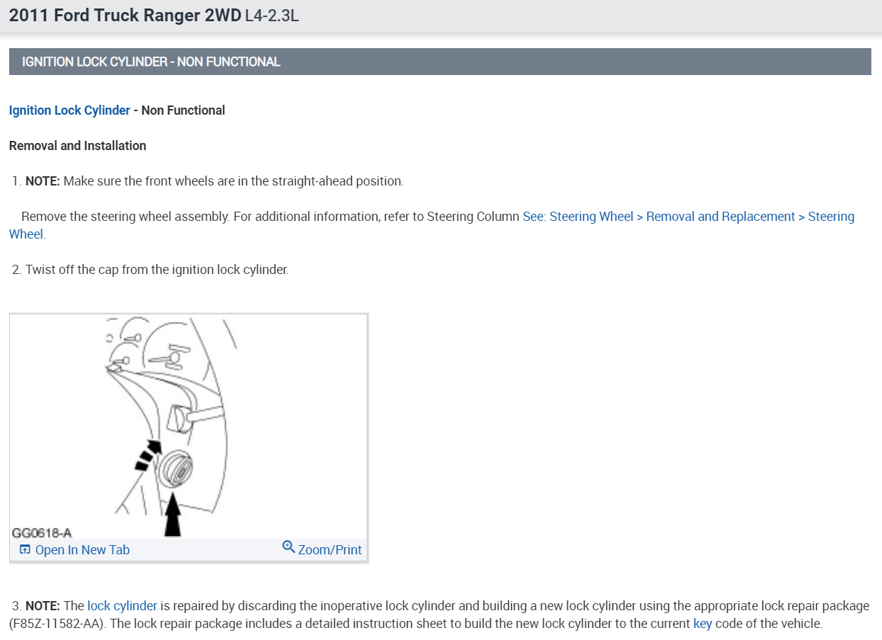

Here is the instructions on how to change the ignition lock out both operational and non operation replacements.

Check out the images (below). Please let us know if you need anything else to get the problem fixed.
