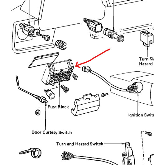

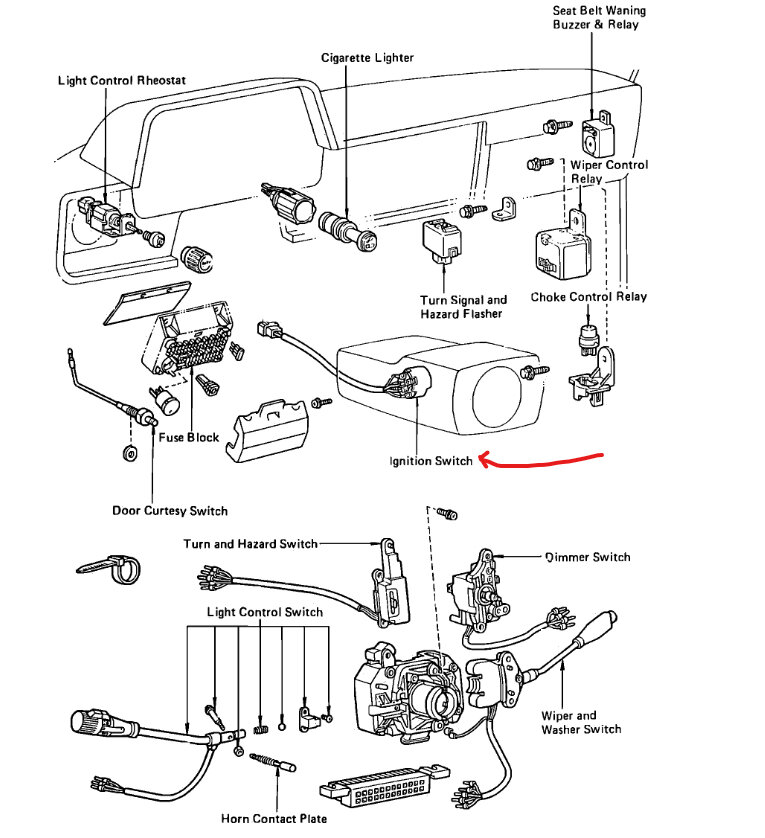

Starts right up and shuts off, if the key leaves the crank position. Will idle and run only while being cranked over.
Mar 5, 2023 at 8:27 AM
  • 55,456 POSTS
It sounds like the ignition switch is bad, but I would check all fuses as well. Here is a guide to help and if the fuses are okay, I would change the ignition switch out. Check out the images below.
Let me know how it goes. Check out the images (below). Please let us know what happens.
