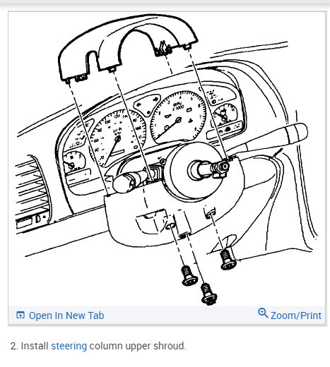

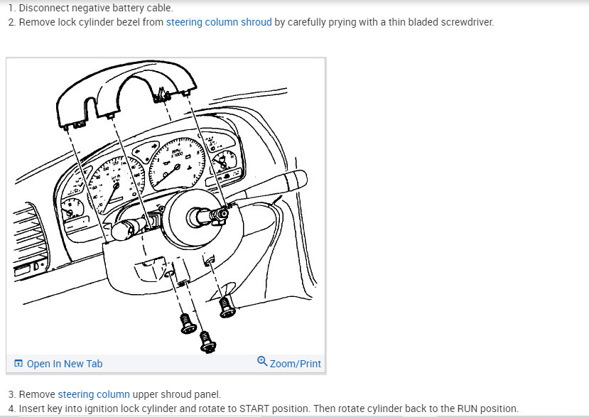

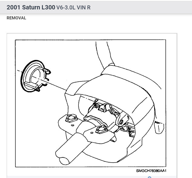

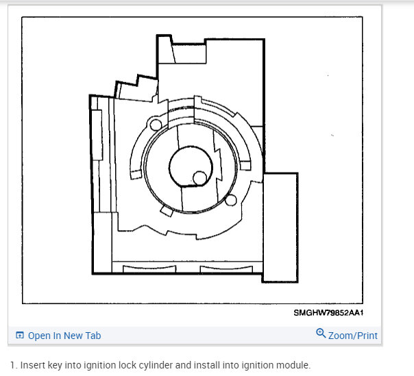

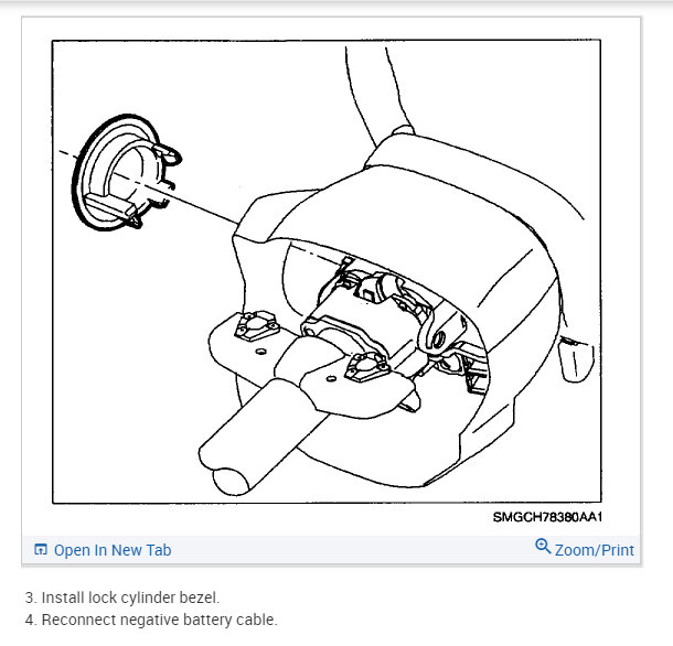

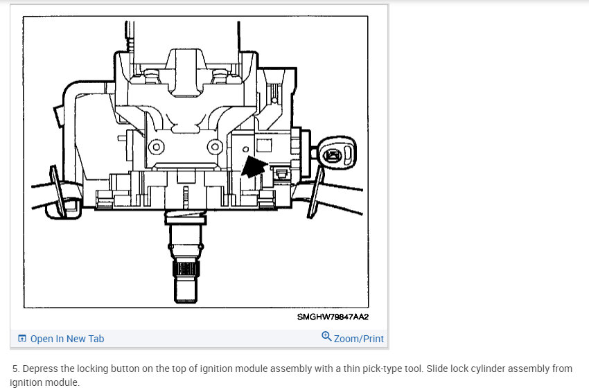

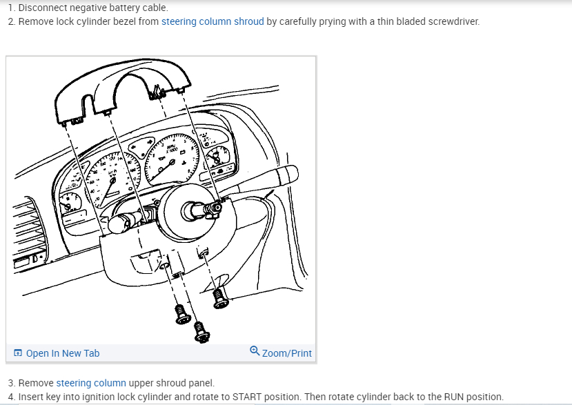

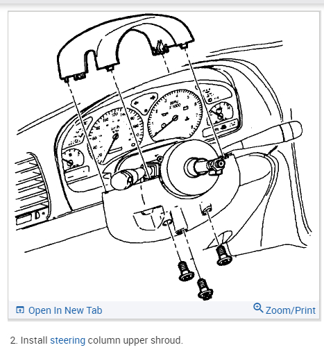

My ignition locked and my steering wheel locked we broke the ignition cylinder and now the car won't start.
Tuesday, October 4th, 2022 AT 4:56 PM
MECHANIC
109,724 POSTS
If the lock cylinder has been broken, it requires replacement. If you look below, I attached the directions for replacement.
Take a look through them and let me know if they help or if you have other questions.
