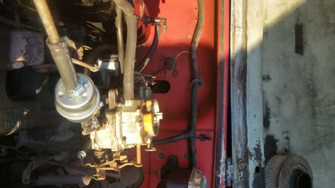

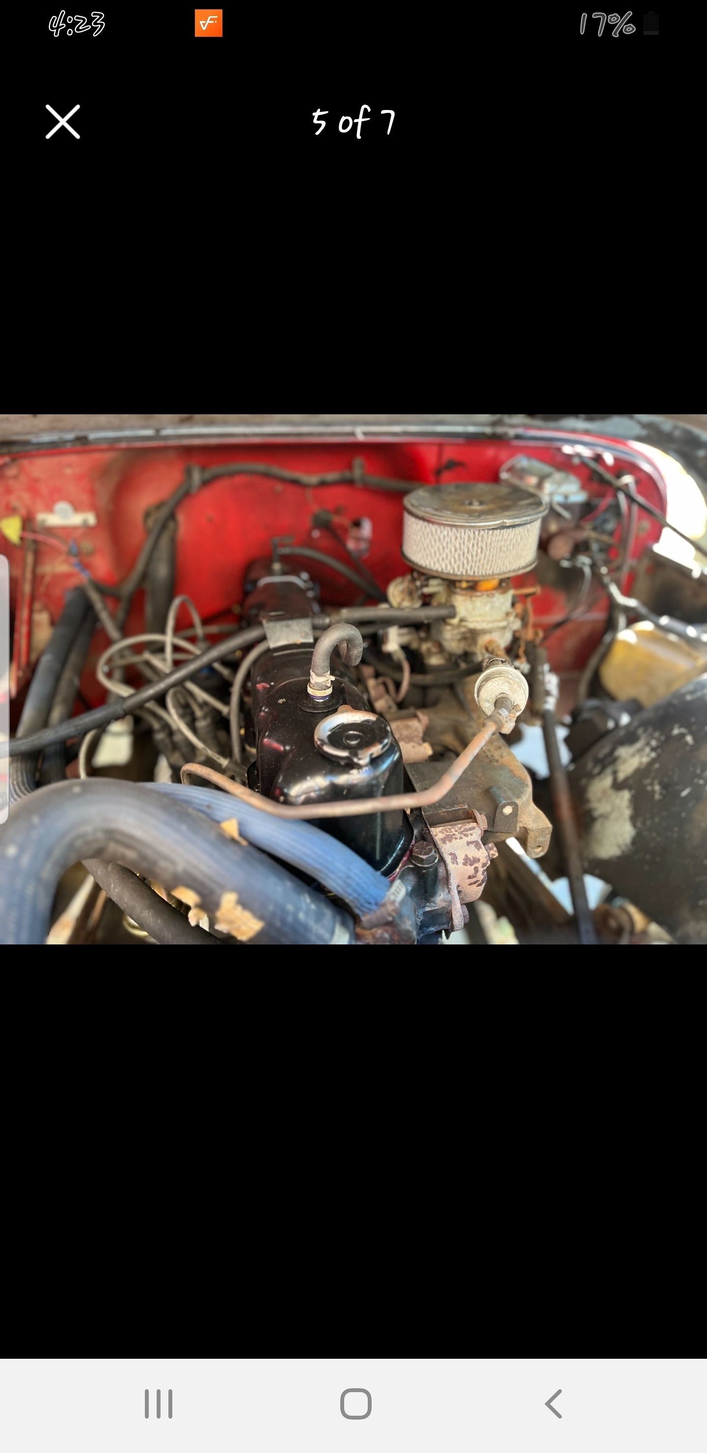

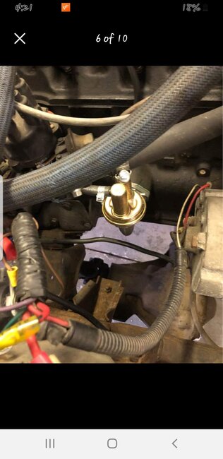

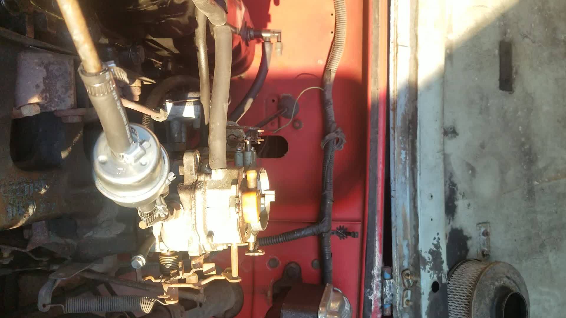

I bought a new 79 cj7. I drove it home a few weeks ago and it did fine. Next day I took it out for a spin, and it shut off on me initially thought ran out of fuel. Have put 7 gallons in it and changed fuel filter. Still not starting it cranks and fires for a second but when you release key it doesn't stay running. Changed ignition module same results.

Thanks for the video and images. Will it stay running if you hold your foot on the throttle slightly? It sounds like either the carburetor has a clogged idle circuit or there is a vacuum leak. I would start by removing the EGR valve and running this test in the video below.
https://youtu.be/DqUCbbKdWf4
If it passes have a helper hold the RPMs up slightly and use this guide to look for vacuum leak when the engine is cold:
Please go over these guides and get back to me.
