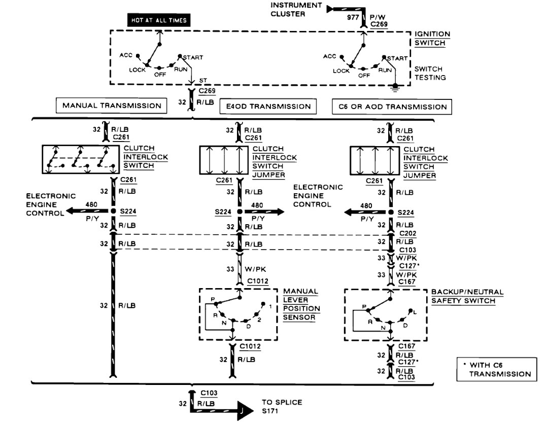

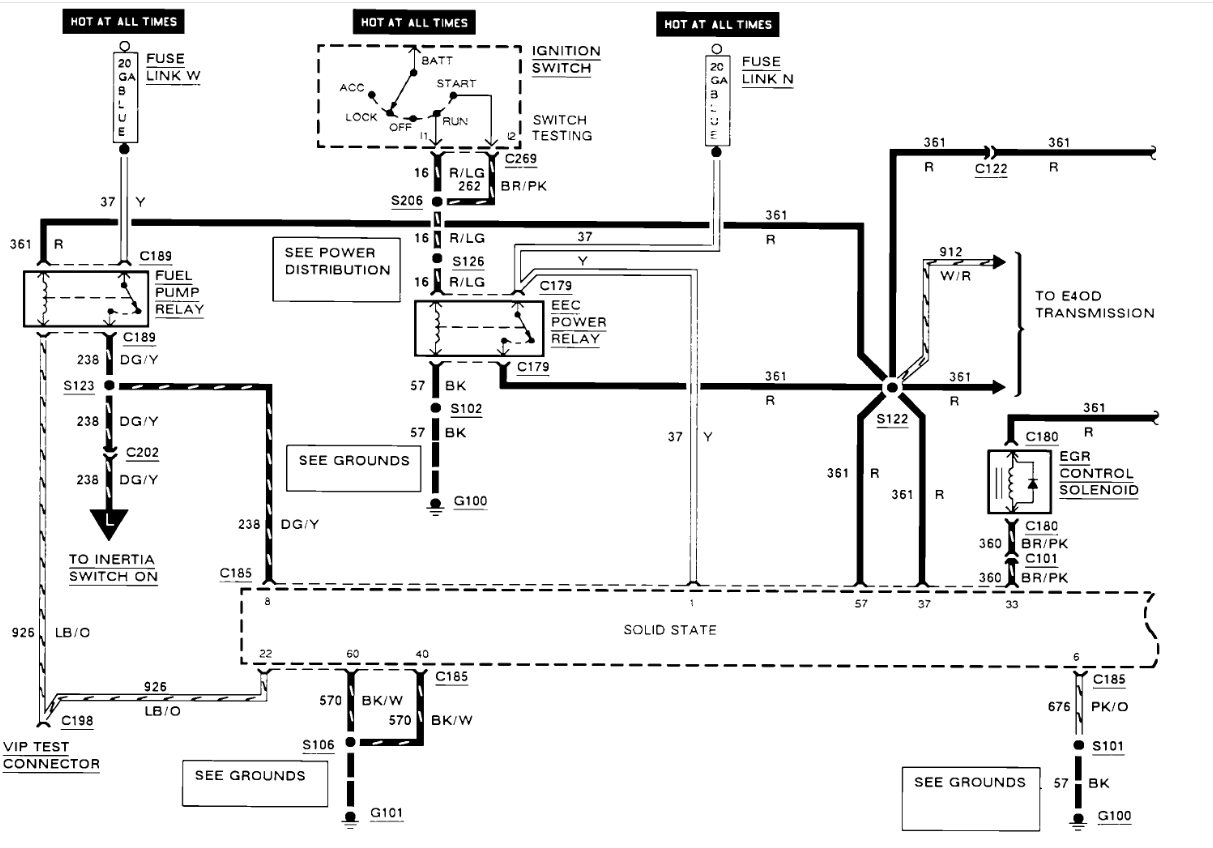

Need steps/photos for the ignition where the key goes the ignition tumbler.
Oct 28, 2026 at 11:00 AM
Experienced Mechanic
55,770 POSTS
Sure, here are the ignition switch wiring diagrams. Let me know if you need anything else.
