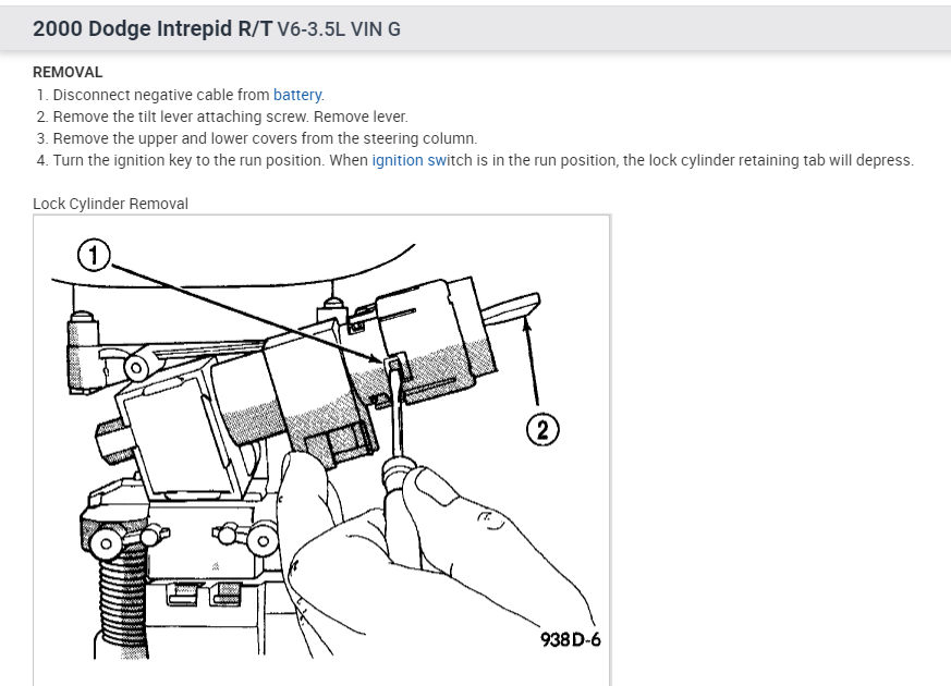

I have the car listed above RT. I had my vehicle stolen while I was in the store for a few minutes. They had punched out my ignition and doesn't look like there's damage on the steering column itself. so, I'm wondering what do I need to replace it so I do not need to use a screwdriver anymore because of them popping out the ignition and I have to jump start my car all the time after this has happened. so, I need to fix it and need to know what I need to get to fix it please.

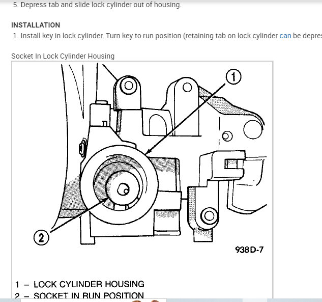

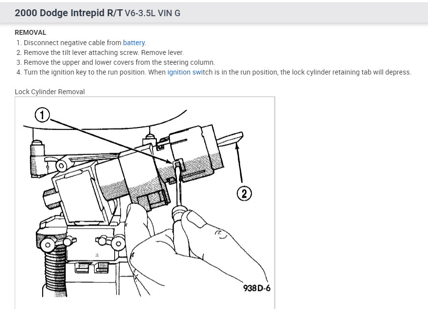

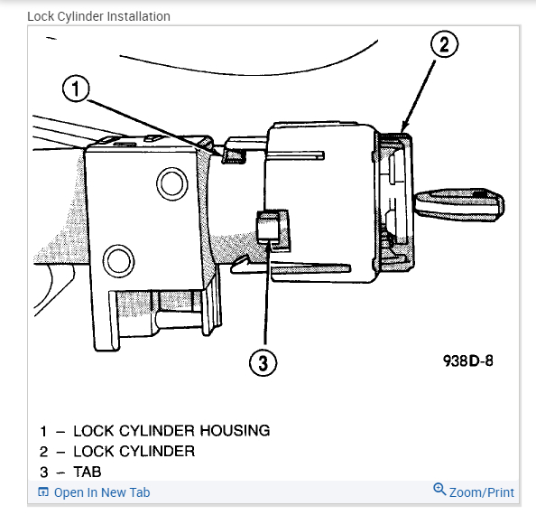

I can't be sure what needs to be replaced, but based on what you described, it sounds like the ignition key lock cylinder was damaged. Also, if the battery is being drained, there is a chance you are not getting the switch fully off.
If you look below, I provided the directions for the removal and replacement of the ignition key lock cylinder. Take a look through them and let me know if you have questions.

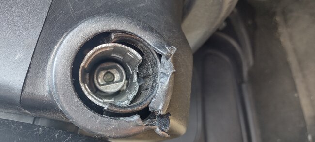

I'm trying to send you a picture of my ignition.
Jun 3, 2023 at 6:42 AM
  • 110,240 POSTS
They made a mess of it for you. You should be able to install a new key lock cylinder. That is what was removed.
Did you look at the directions above? They will help you through replacement.

Yes, thank you I did look at it, that will be very helpful once the cylinder gets in. So, do you think I need to get a new ignition switch? I can use a screwdriver to get my car to start and all. There is no resistance.

Chances are the switch is fine. Once you install the lock cylinder, it should return to normal.
Let me know if you have questions or if I can help.
