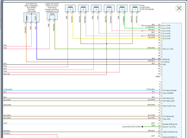

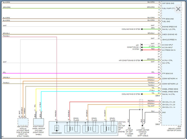

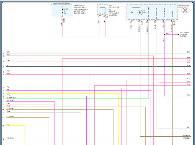

Need to know what color the fuel injection wire is that goes to the ignition coil and does that get hooked up to the ignition on a universal ignition switch?
Sep 16, 2021 at 12:40 PM

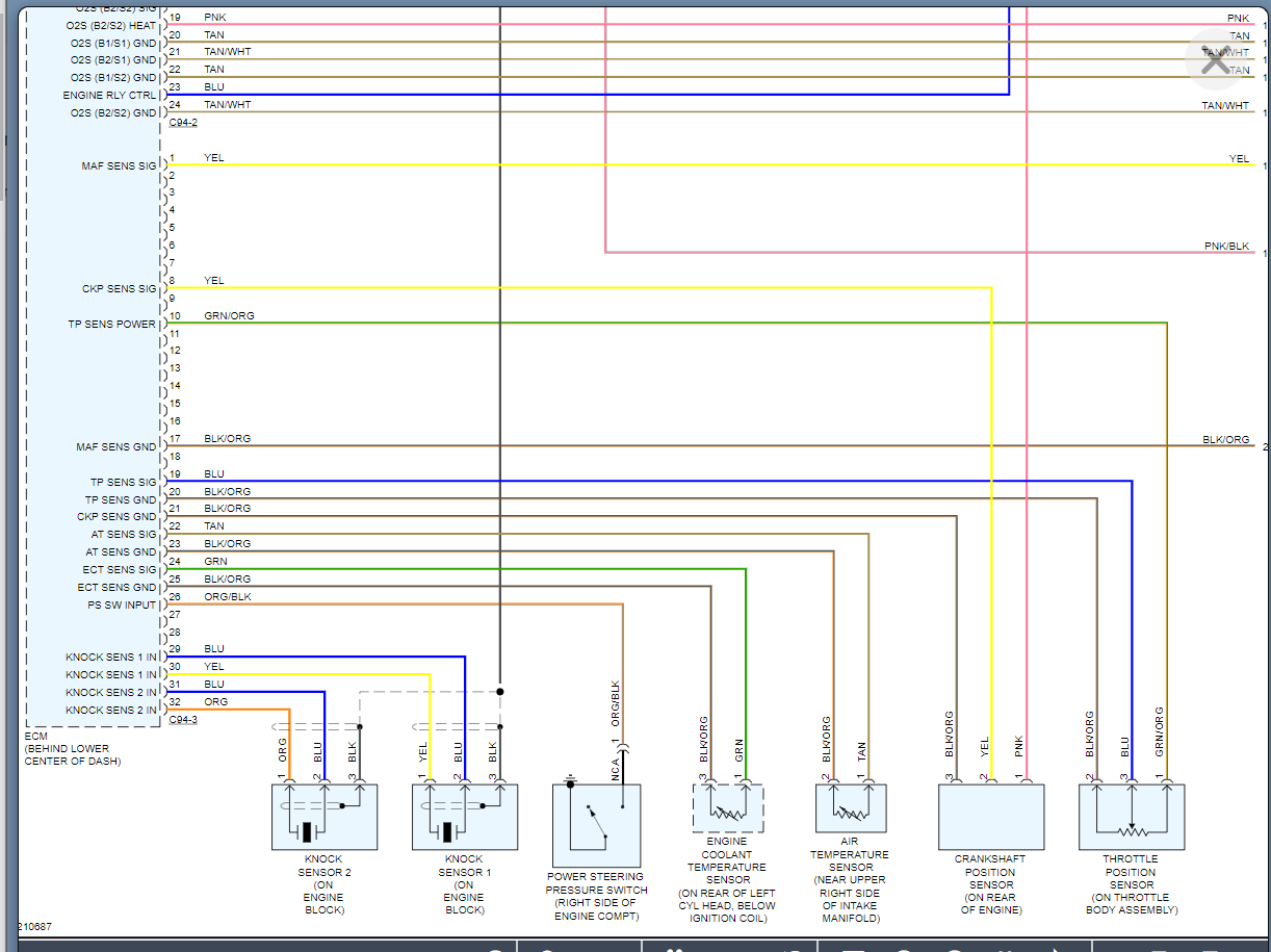

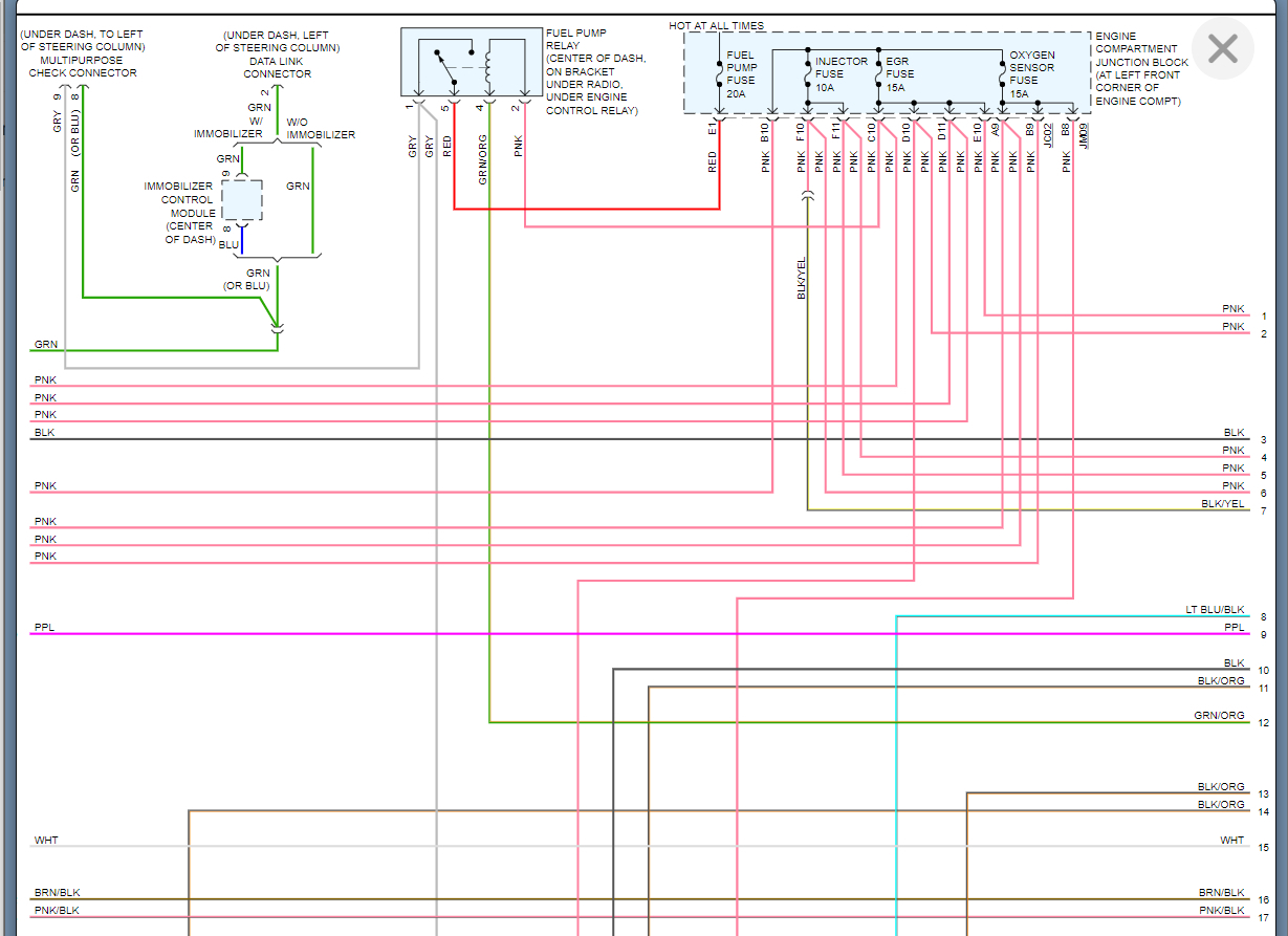

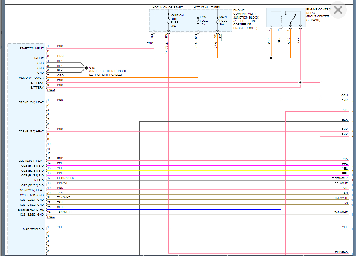

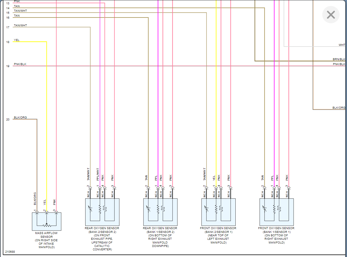

I am not sure I know which wire you are talking about. The fuel injection wire that goes to the coil is not on this wiring diagram.

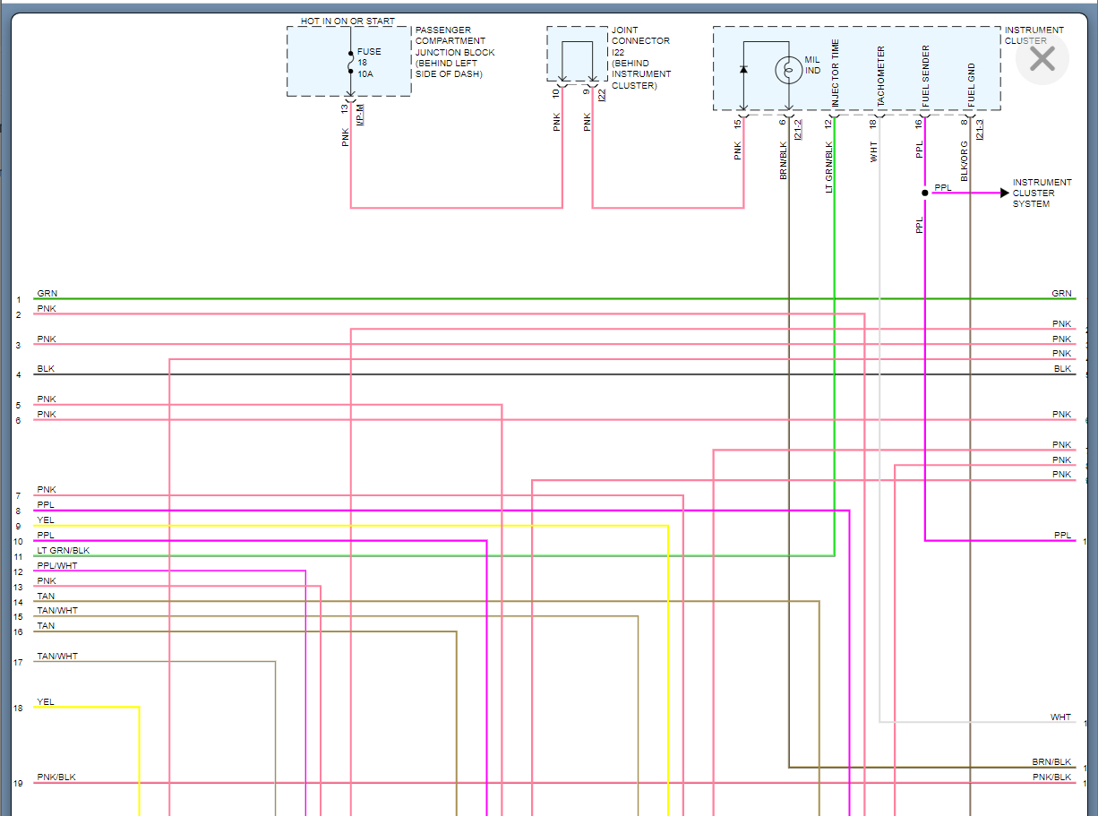

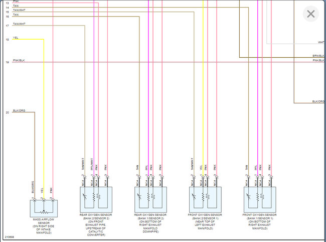

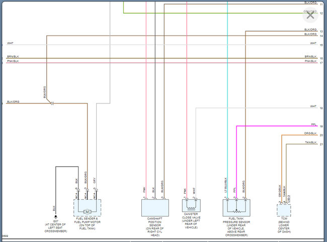

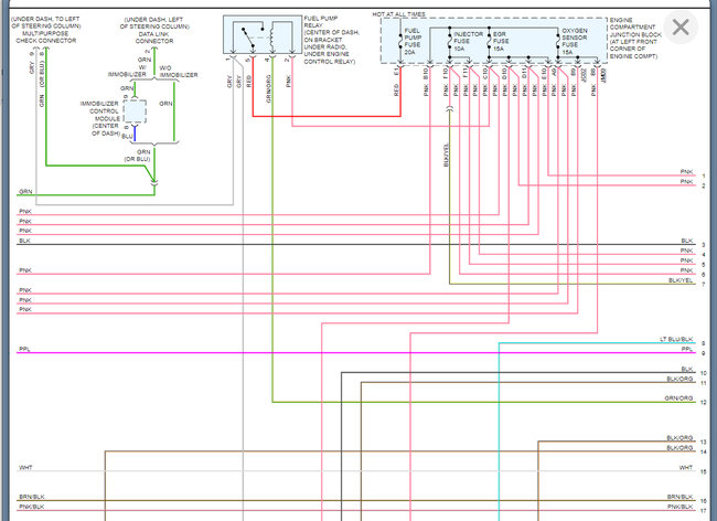

So I am attaching the entire diagram below for your review.
Also, here are a couple guides that will help with testing the voltage if needed:
Please see the wiring diagram below and let me know the details about what you are trying to find and I can be of more assistance if needed.
