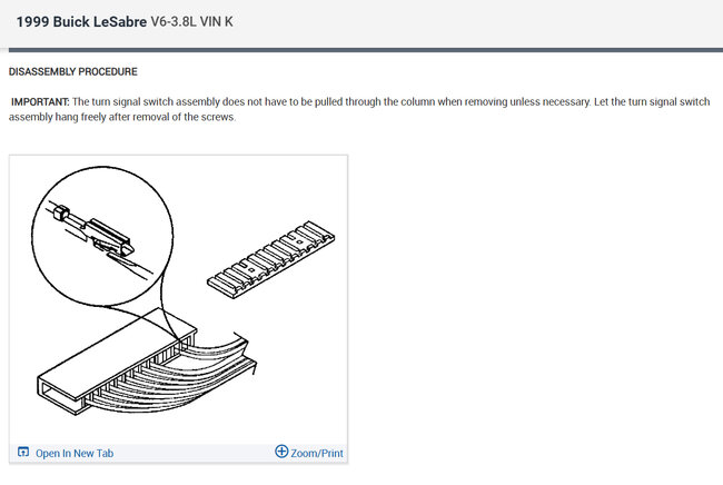

Key won't turn back to cut car off key is stuck.
Feb 1, 2025 at 10:22 PM
Experienced Mechanic
55,711 POSTS

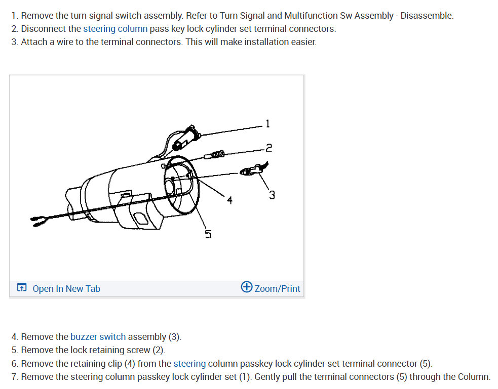

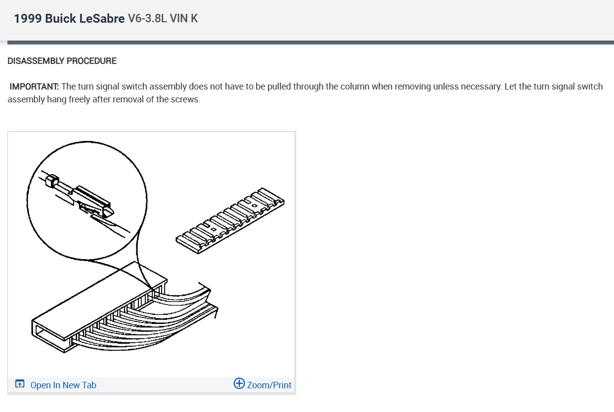

This happens when the ignition lock tumbler needs to be replaced. here is how the job is done to fix the problem. This guide can help as well:
https://www.2carpros.com/articles/ignition-switch-wont-turn-stuck
Check out the images (below). Please upload pictures or videos in your response of any problems so we can see what to help you with.
