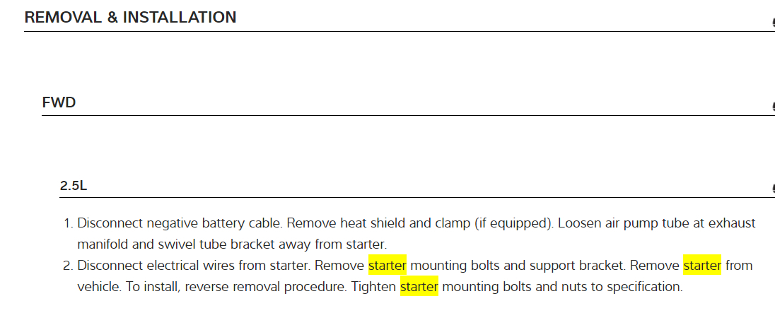

I turn the key and it make a ugly noise like the starter is falling apart. Or it wont turn over then it would but wont start. What could it be?

This sounds like your vehicle's starter is starting to fail. Starters some times have bad brushes or a worn dirty armature that can cause "flat spots" where the starter wont turn or it will drag because of the unwanted resistance that this can cause. Here is a link below on how to replace a starter:
In the diagrams down below I have included instructions on how to remove and replace your vehicle's starter. Please get back to us with how turns out.
