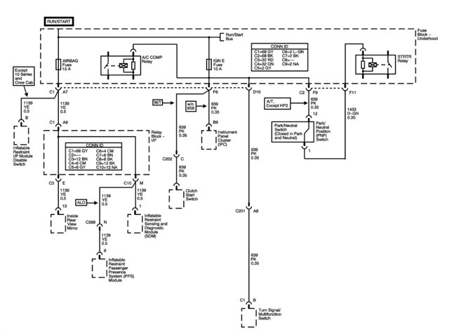

so for about a couple months I'd be driving down a road somewhere and the A/C is blowing cold and typically when it's really hot outside and the truck starts trying to overheat (but never seriously) the A/C would start blowing hot. well i decided one day to pull over, turn the truck off and then back on and for a while now about a month or so that itself would get it to blowing cold again, then i had starter i had to replace and a water pump, it's been a month or two since that. Well now about a week ago i found my ign e fuse blown and not able to start truck unless i bypassed the starter relay with a wire, which is what I've had to do every time all week long. and without having that ign e fuse in and not blowing every time a new one is put in, i have no cold A/C, no turn signals (but my hazards still work) my tachometer gauge won't work. just today i invested in a multimeter to make figuring this out a lot easier but I've never used one but have become familiar with what all the things mean on it. i don't know how to go about the process of elimination checks. Please help. i also found some wiring diagrams on AutoZone's website for my vehicle but i might end up buying the repair manual.

Okay, there are three items on this circuit, the AC compressor relay which I think it the problem, the clutch coil on the front of the compressor goes out and shorts the fuse. You can unplug the compressor and drive it around to see if the fuse blows. The other items is the instrument cluster, neutral safety switch and the turn signal switch. Here is instructions on how to use the voltmeter in case you need it.

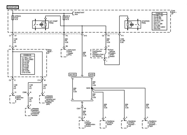

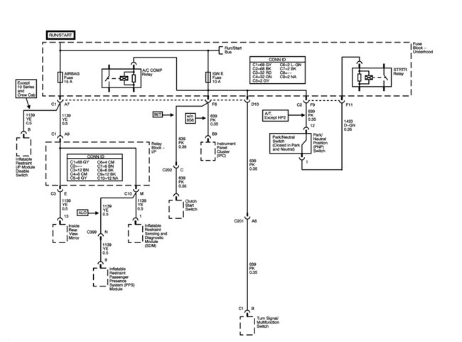

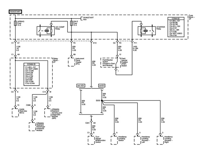

i also noticed today on my way back from work that when I'm driving around daily i notice my voltage gauge shows 15- 16 volt reading. which i thought was normal but googled it and I guess it's overcharging. And what diagram is that you sent? i was finally able to get to access a Chilton repair manual, and it has all kinds of stuff but the diagrams i have got show this, keep in mind this is my first time ever messing with an electrical side of mechanic work so thanks for all the help you can give.

You can see in the first wiring diagram it is the same as the one I posted. I would try unplugging the A/C compressor and replace the fuse to see if it blows again. I would search google for a guide to help you understand wiring diagrams, we do have a guide to help you with testing the wiring.

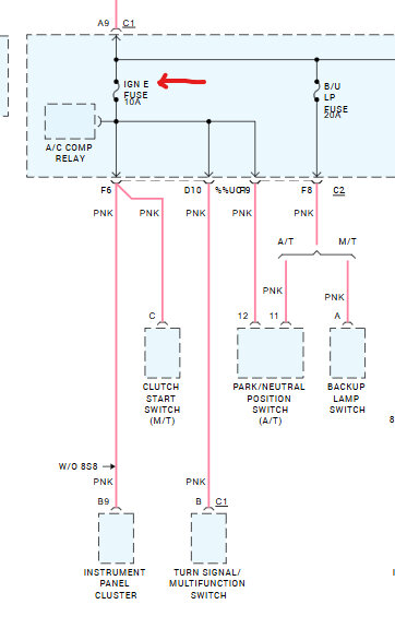

well that's the thing, i didn't really do anything except leave the ign e fuse out for 2 days and finally stopped to get a box of fuses and popped one in and started the truck, the next morning i did the recalibration process for the HVAC system, and since then it's not blowing the fuse anymore, could something either like melting wire or a blend door actuator binding up or even the clutch on the compressor faulting cause a short that blows that fuse.

This still can be the clutch coil, they can go bad intermittently. Keep an eye on it and if it starts going it again I would unplug the clutch coil to confirm.
