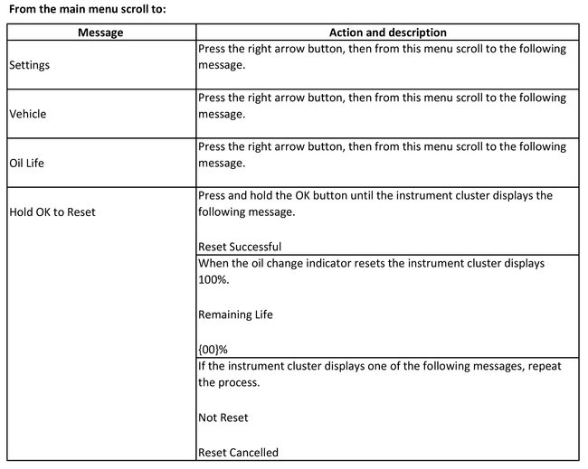

No, you would need to go into your setting to reset at the steering wheel. Sorry no images available on my end but this information.
Oil Change Indicator Reset
Use the information display controls on the steering wheel to reset the oil change indicator.
The instructions are each setting you go into to reset the oil life. Hope the information is useful.
