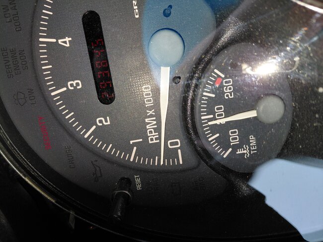

I am having an idling issue with my 2000 grand am. I have replaced the idol air control value about 3 to 4 time with different senses but I still have a problem will the rpms sitting low yet when at sit at atop sign an it's warm runs fine on when in motion can someone help me fix my problem

Thanks Ken for replying back to me. I have replaced vacuum lines and replaced all the sensors on my throttle body an I still have the same idol problem wish I can get it running right. I called a couple shops but they want to run i diagnostic test on it but can't afford it I been working on my own for for years. I have a picture for you hope you can still help me out with the problem. Thanks again

This is the car running but it only does it when it's all warmed up the idol is low. I do have alot of blow by an when I take the oil cap off I have air coming out so I may think it could be rings an seal issue but don't know. I have tried everything replaced just about everything sense in the car fixed all the vacuum lines everything so don't know what it could be.
