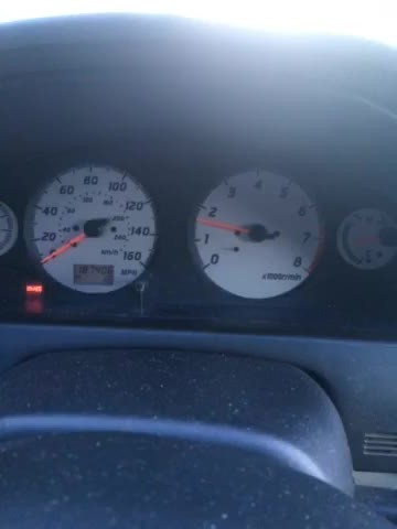

Car just idles up and down when engine is warm.

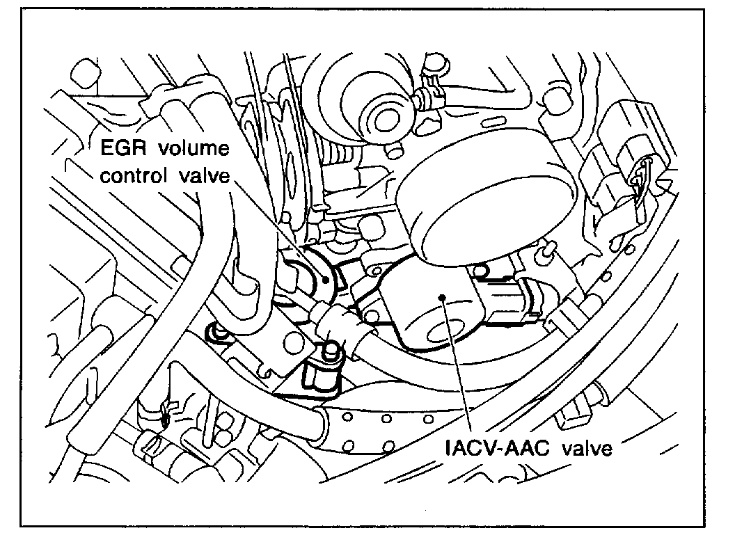

Based on your description, it sounds like there is a problem with the IACV-AAC valve. This system automatically controls engine idle speed to a specified level. Idle speed is controlled through fine adjustment of the amount of air which by-passes the throttle valve via IACV-AAC valve. The IACV-AAC valve changes the opening of the air by-pass passage to control the amount of auxiliary air.
Now before just replacing the valve, check to make sure there is no carbon build up on the throttle plate. If it appears clean and closing properly, then remove the IACV-AAC valve and inspect it for carbon or any dirt.
I have attached a picture of the component and location for you. If the valve is to be replaced, there is a relearn process that requires Consult II scanner or equal. Here is the relearn process with a manual transmission. Starting with picture 2, the remaining pictures correlate with these directions.

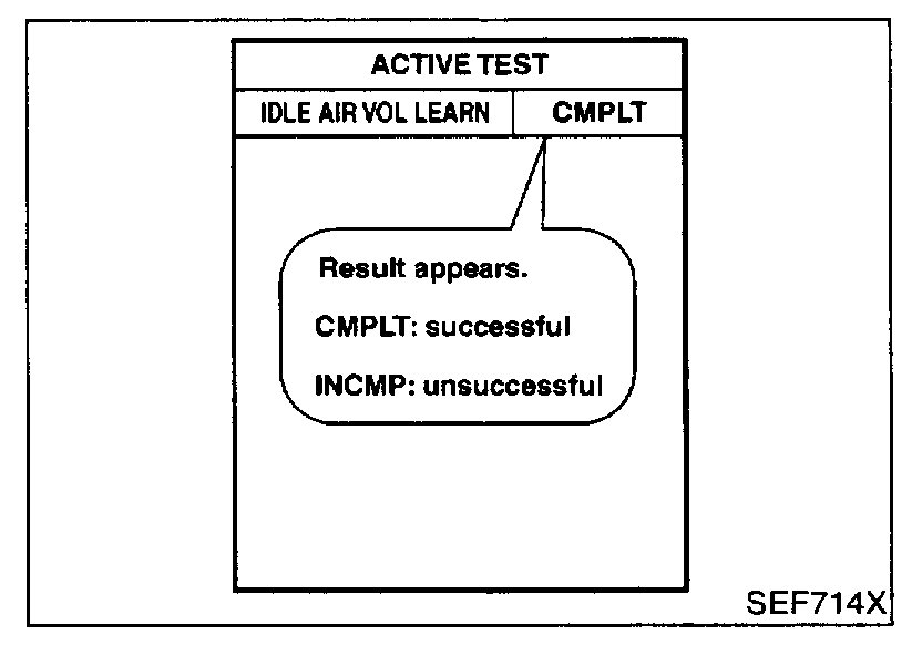

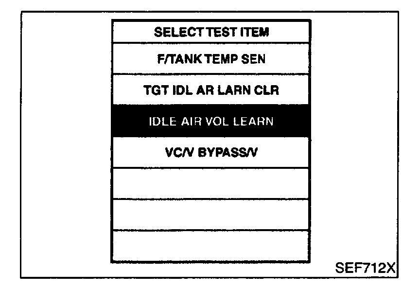

5. Select "IDLE AIR VOL LEARN" in "ACTIVE TEST" mode.

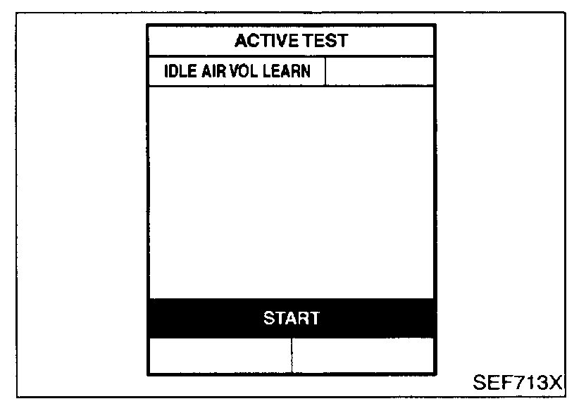

6. Touch "START' and wait 20 seconds.
7. Make sure that "CMPLT" is displayed on CONSULT-II screen. If "INCMP" is displayed, "Idle Air Volume Learning" will not be carried out successfully. In this case, find the cause of the problem by referring to the NOTE below.

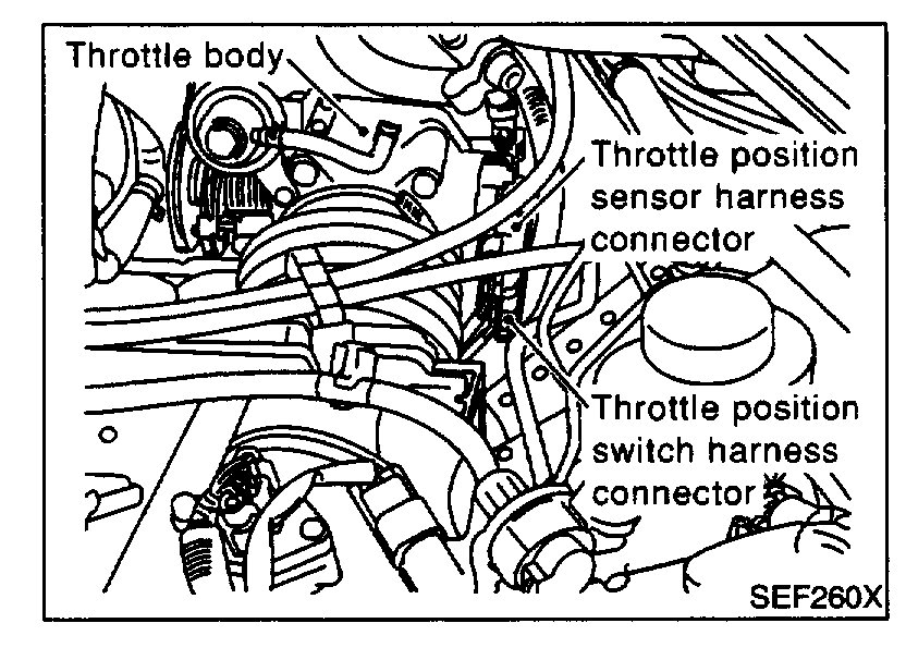

5. Disconnect throttle position sensor harness connector (brown), then reconnect it within 5 seconds.

Well, I checked the valve and it looks fine. I cleaned the throttle body and still having problems. So this up and down rpm's are happening when I press the clutch in. And it happens when I cruise in neutral or at a stop. And it seems the car wants to accelerate on its own. Seems as if the the throttle is engaged at all times. I have no clue. This morning it was hard to start. Kept stalling until engine was warm and then the rpm's started jumping.

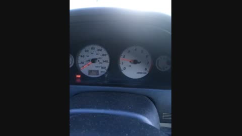

Hey again. So after I thought I had the problem fixed the car now stalls if I take my feet off the gas. As soon as I press the clutch to come to stop, the rpm's drop and car shuts off. I do not know what that is. Do you have any idea what it can be? Thanks. Happens when car is cold or warm.
Nov 6, 2018 at 6:49 AM
TONIO SELLERS
  • 7 POSTS
Here is a video.
Nov 6, 2018 at 3:27 PM
TONIO SELLERS
  • 7 POSTS
https://www.2carpros.com/files/temp/7318132128.mov
Nov 6, 2018 at 3:29 PM

Has the check engine light come on? Also, check the wiring at the IACV. Wiggle the connector with the engine running to see if it changes anything. It is acting like the IACV is bad.

Thanks for replying. But no engine light has come on at all. So this morning I decided to clean the air intake and the MAF sensor. And also sprayed the throttle body again. And the video I posted shows what happened after that. The car stalling went away but the up and down revving started again. I have no idea what it is.
Nov 6, 2018 at 6:11 PM

Interesting. I still feel it has something to do with the IACV. Try moving the harness around and wires to see if it changes. Also, remove it and inspect for debris/carbon.
