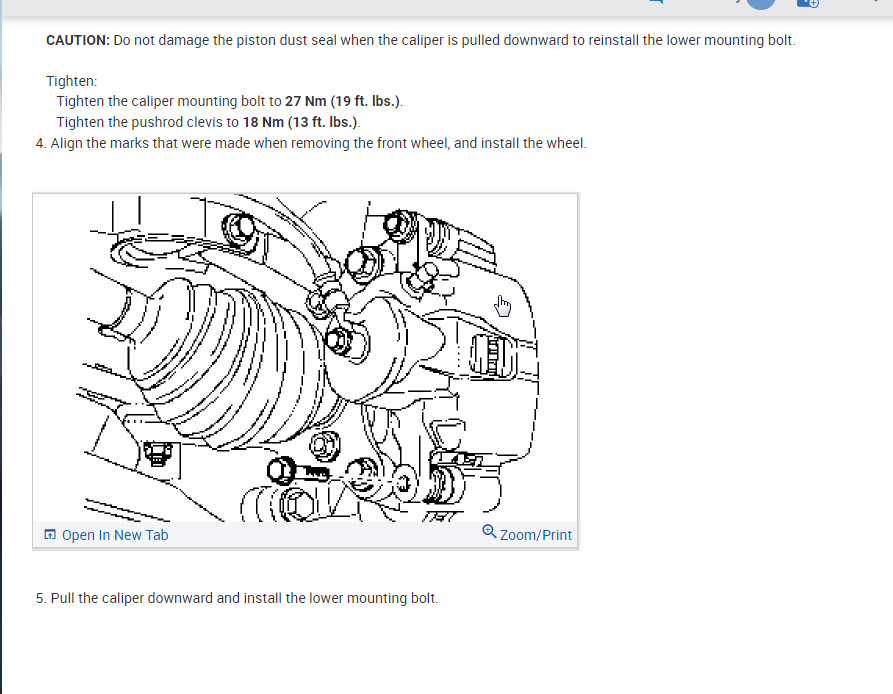

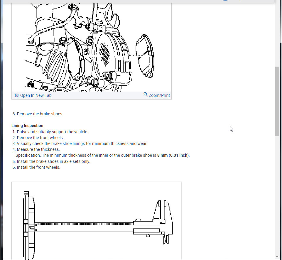

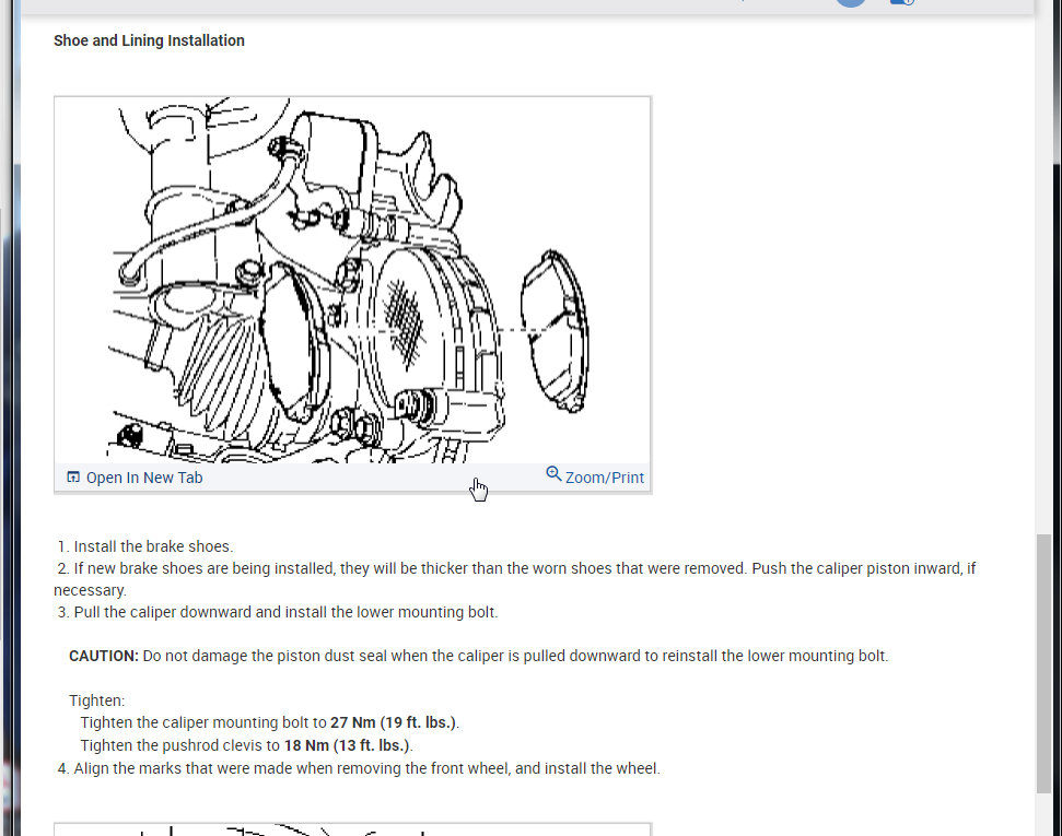

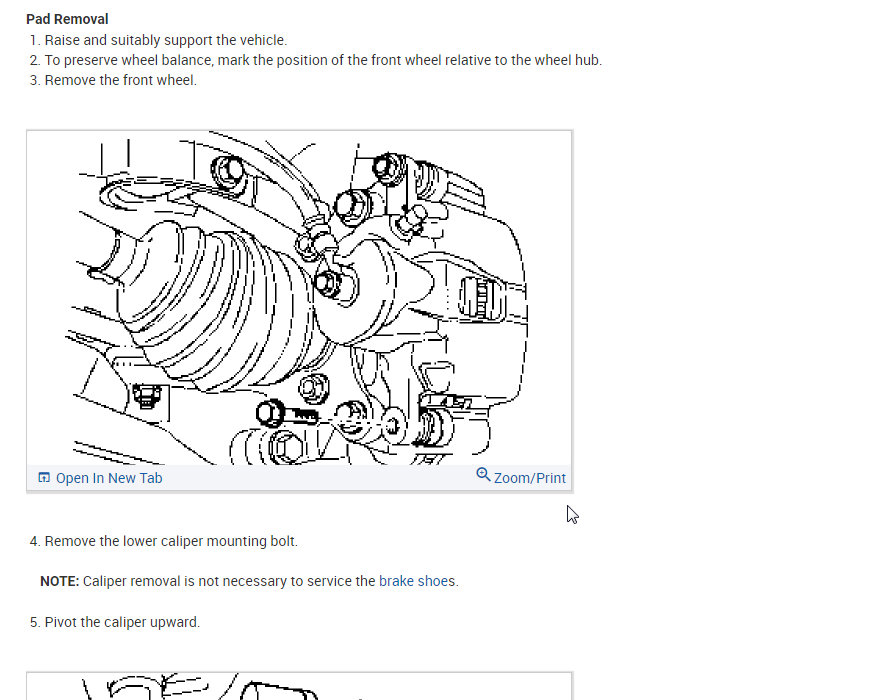

Here is a guide that will help with this:
Below you will find the process from the manual that will help as well in replacing the pads and rotors. Please run through this material and let us know if you have questions. Thanks
