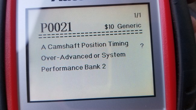

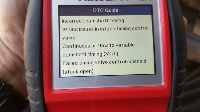

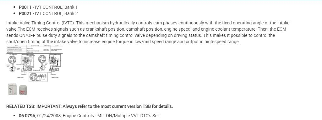

Hey Roy, I checked compression it's 150 on all cylinders bellingers. Then I did a scan, and I got a P0021 code. attached images.

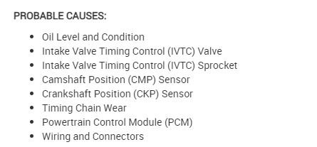

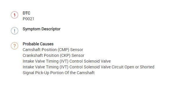

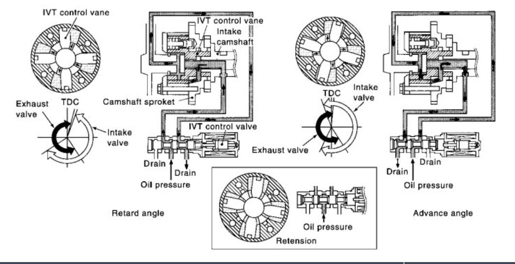

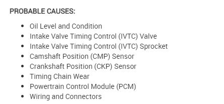

Okay, I attached the flow chart for code 21. It is related to the VVT for the cam.
I would start with changing the oil and filter and see if it runs better. Dirt gets in the oil passages and changes the timing.

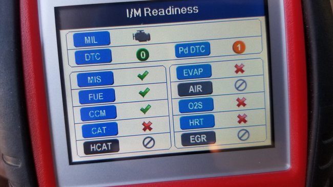

I changed the oil; it was very black. I just purchased this car a little over a month ago. I bought the filter and oil right away and was going to change it but got doing other things on the car such as new tires new suspension all the way around a new CD axle and hub bearings on the left and I'm going to do the one on the right if I can get this thing running correctly. So, I erase the pending code after changing the oil and starting the engine and it's still rough idle and kind of hesitates when I rev the engine. Is the new variable valve timing control soul annoyed will be in today so I will switch that out. If you have any other suggestions, please let me know.

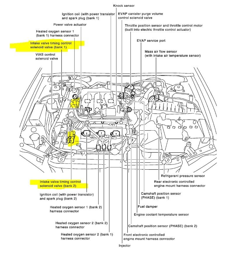

You can also remove the two-intake camshaft VVT solenoids and check the little screens on them for sludge or debris. Sometimes they can get a buildup on them restricting the oil flow. I've attached the locations for you.

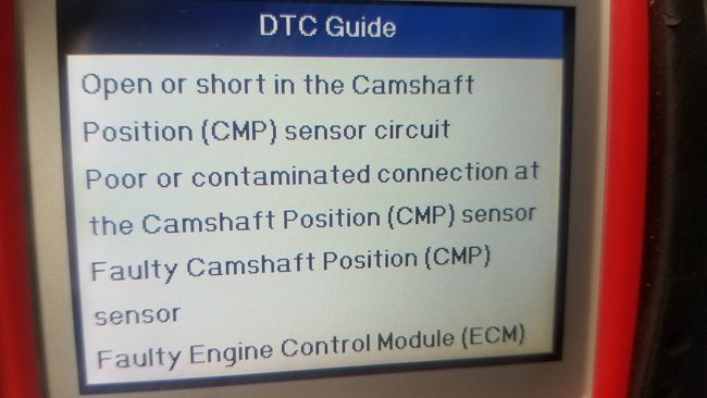

Yes, 125 cylinder #2. So, I had a code P0341341I replaced both of the camshaft position sensors I repaired the plug on the bank one center the electrical connector. Started the car still idling rough. It did and I erased code P0341 before I started it again and the code is back.. I need help.

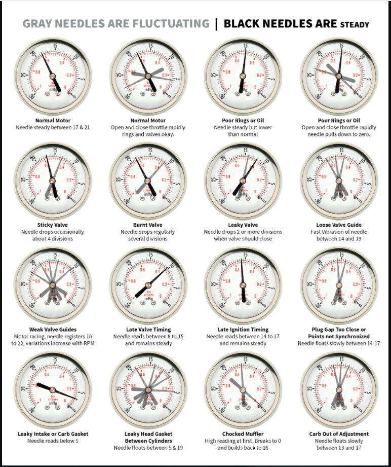

Just to jump in. Sorry for the delay in responses. We are independent contractors that respond to peoples questions when we are able to. Unfortunately this doesn't lend to immediate responses. Sorry for any delays that this causes.
As for finding a broken valve spring there are a number of ways. You can visually inspect them but you can also do what is called a running compression check, lastly would be to check the vacuum on the engine with a vacuum gauge. If the intake spring is the issue then the vacuum will not be stable. Take a look at the chart below that will show this.
Nov 4, 2021 at 10:11 AM

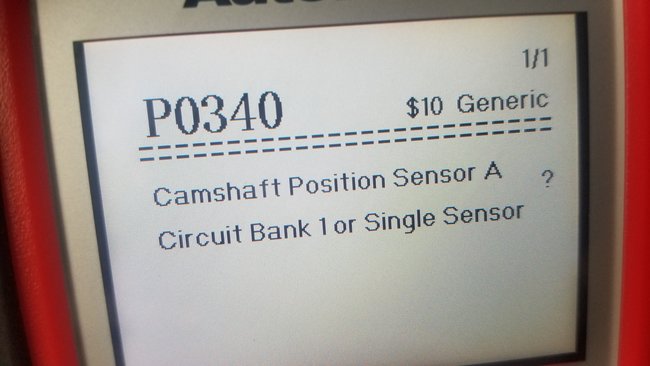

I replaced both camshaft position control sensors. Cleared codes started engine. P0340 code came back.
