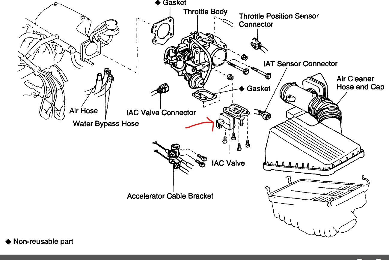

This is common when the idle air control valve needs service. please check out this video and the instructions below in the images for your car.
https://youtu.be/XMB16Gg-qNg?si=rK62B8-Ukk6ElCDR
This guide may help as well:
Check out the images (below). Please upload pictures or videos in your response of any problems so we can see what to help you with.
