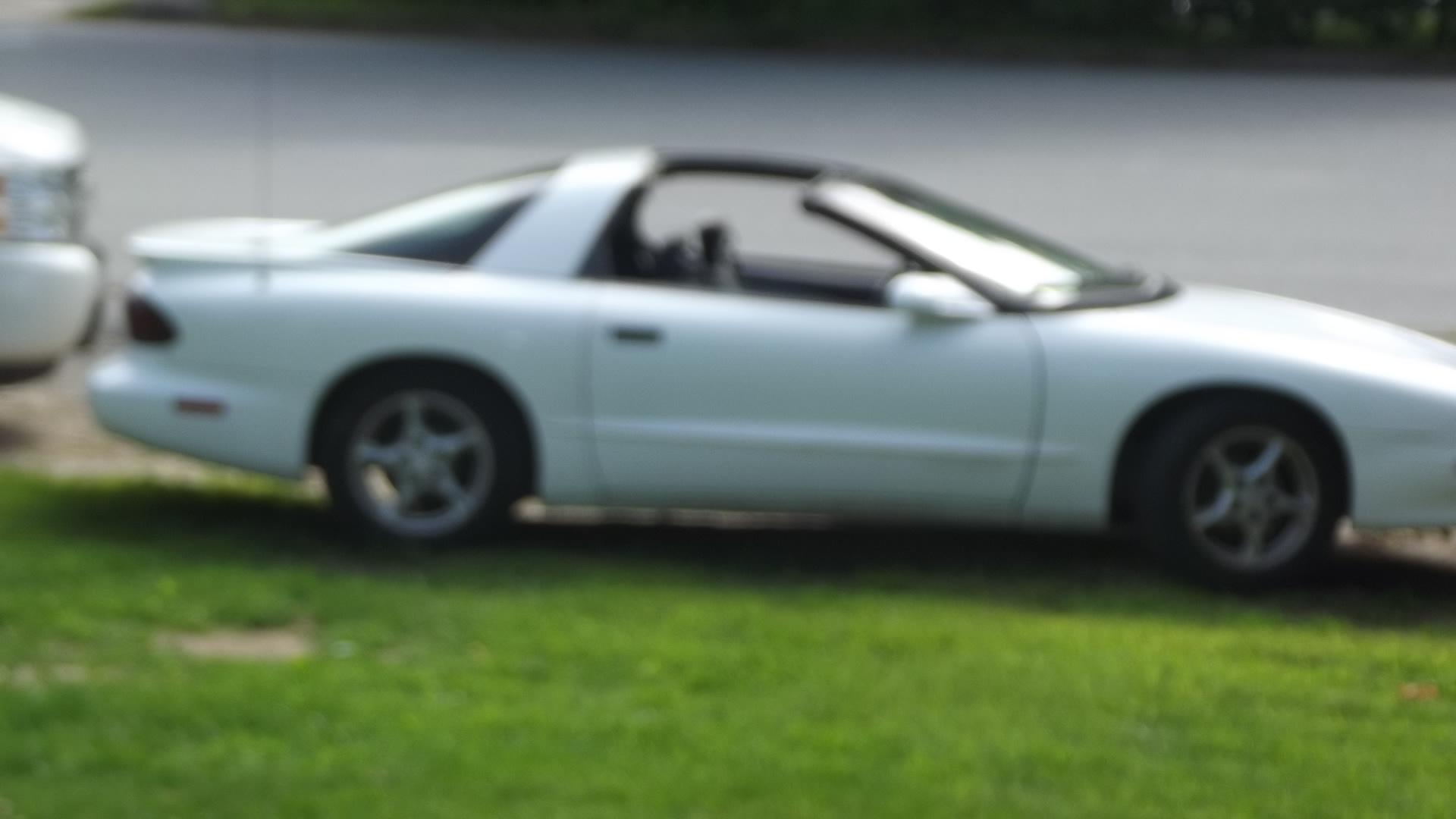

My car starts and runs great when it is cold. Once it start to warm up the idle will become erratic, it will sputter for thirty seconds or so then rev up to about 1500 rpm's then it levels out at about 950 rpm's, which seems high, this is when the car is in park or neutral. When it is in gear it will do the same, only if I turn the wheel a bit it, the sputtering becomes worse and the car will stall. I have replaced the IACV, TPS, and the coolant sensor. I also have a new catalytic converter. I have searched many times for vacuum leaks, but have found none. The car also has a hesitation when going down the road and seems to become flat at times, only to take off like a rocket. I seems to be using a lot of fuel and the gas mileage is down. The check engine light is on. I am confused at this point! Do you think I may just need a tuneup? The gas filter is new and the air filter is also new.

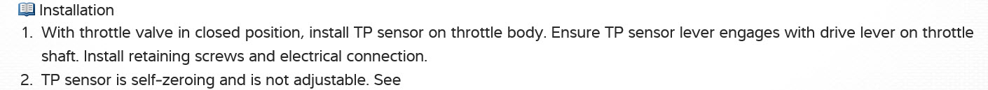

I forgot what code was, but I was told TPS, when I put a new one on the check engine light goes out, but the car runs even worse with a lot of smoke coming from the engine and it just goes right to a stall unless you keep your foot on the pedal. Did I do something wrong changing it? Seems to be pretty straight forward. So I put the old one back on and the check engine light reappears, the car runs better then it still sputters out. Is cleaning the throttle plate a hard job for a back yard mechanic? Not really sure where to start.

Anything I have sent you is fairly easy to do, we have an article on this site under how to repair under fuel to check pressure. Your tps may have an adjustment on it if the screw holes are slotted then it is not adjustable, also check for a vacuum leak it may have one and check for hoses that are cracks/broken etc.
