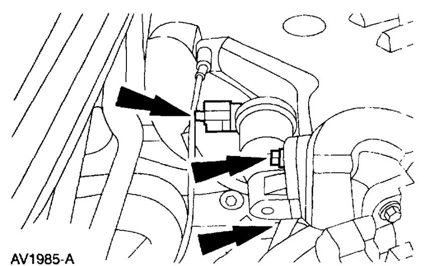

vehicle idles high even after warming up and has an odor only while idling. The odor does not smell like oil.
Jan 13, 2021 at 1:38 PM
Good morning,
This could be from either the throttle body being dirty or the idle air control valve which is very common.
https://www.2carpros.com/articles/engine-idles-too-high

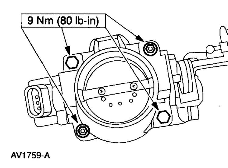

I would start by cleaning the throttle body of all carbon residue.
Beyond that, I would replace the idle air control valve as that was a very common issue for high idling.
https://www.2carpros.com/articles/how-to-replace-an-idle-speed-control-motor-iac

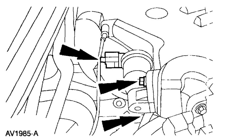

REMOVAL
1. Disconnect the battery ground cable.
2. Remove the IAC valve:
Disconnect the connector.
Remove the two bolts, the IAC valve and the gasket.
NOTE: Discard the Idle Air Control (IAC) valve gasket.
INSTALLATION
1. To install, reverse the removal procedure.
