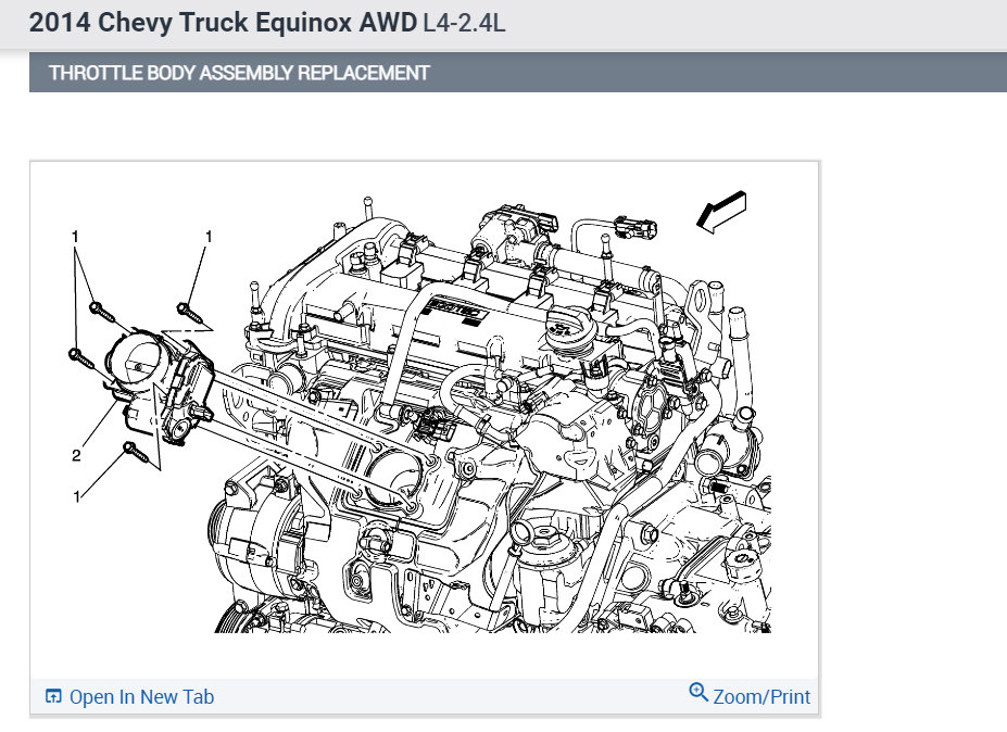

My car is acting like it needs an inhaler or something! The idling thingy keeps jumping... The spark plugs have been changed the air filter has been changed and the oil has been changed... The diagnosis showed no error codes... Not sure what else to look for?
May 30, 2022 at 2:48 PM
  • 55,649 POSTS

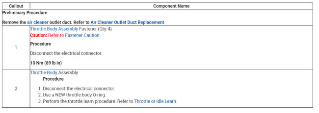

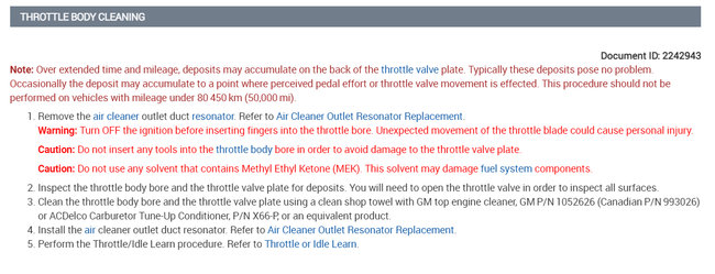

This happens when the throttle body is dirty and needs to be cleaned. Here are two guides to help you fix the problem with specific instructions for your car in the diagrams below:
