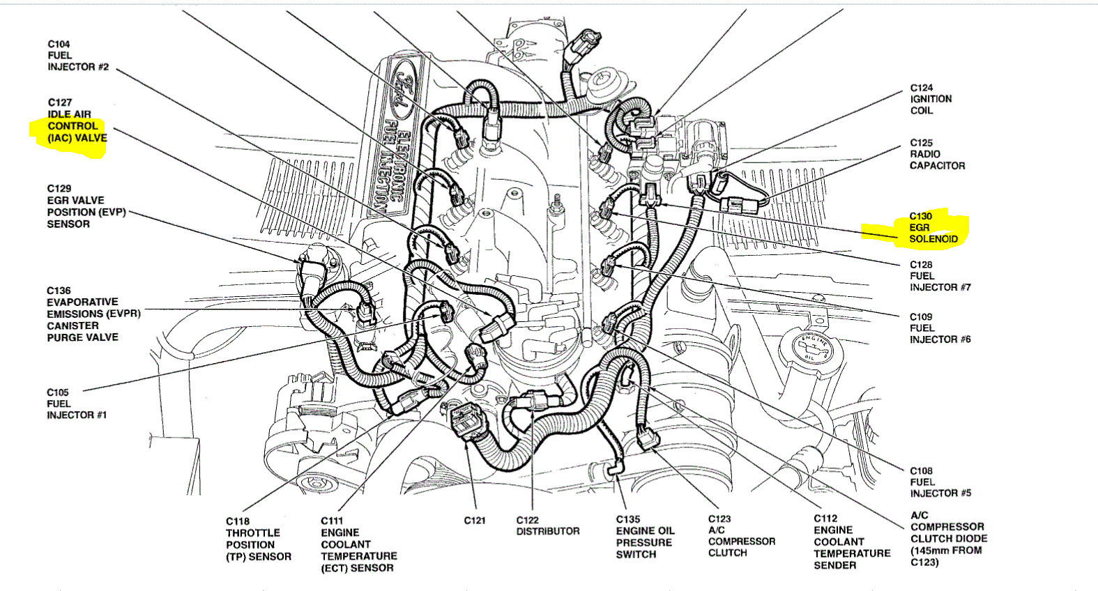

Van idles very high at will.

Also, your vehicle has what is called an idle air control valve. It is located on the throttle body and is responsible for maintaining a steady idle speed. If you find there are no vacuum leaks, that is the next thing I would check. However, before I can provide additional information related to it, I need to know if the engine is a 5.0L or the 5.8L.
_____________
I attached a pic below and highlighted the IAC and the EGR. Check around the EGR for any vacuum issues as well. Next, take a look at the IAC and make sure the electrical connector is tight, not corroded, and not damaged.
