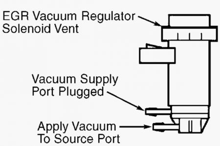

New EVR may help try unplugging and blocking the vacuum lines.
https://images.2carpros.com/forum/automotive_pictures/62217_evr_2.jpg
This part regulates the egr. Test both EGR and EVR this way: EGR Valve 1. Ensure all vacuum hoses are correctly routed and securely attached. Replace any crimped or broken hoses. Ensure there is less than one in. Hg vacuum to EGR valve at idle with engine at normal operating temperature. 2. Install tachometer. Disconnect Idle Air Control (IAC) wiring harness connector. Remove and plug vacuum hose at EGR valve. Start engine and allow to idle in Neutral. Note idle speed. Using hand vacuum pump, slowly apply 5-10 in. Hg vacuum to EGR valve. When vacuum is fully applied, engine should do one or more of the following:  Engine should stall.  Idle speed should drop more than 100 RPM.  Idle speed should return to normal when vacuum is released. Service or replace EGR valve if engine does not stall or idle speed does not respond as specified. Reconnect IAC harness connector. Unplug and reconnect vacuum hose at EGR valve. EGR Vacuum Regulator Solenoid Turn ignition off. Disconnect EGR Vacuum Regulator (EVR) solenoid wiring harness connector. Measure resistance across EVR solenoid terminals. If resistance is not 26-40 ohms, replace EVR solenoid. For additional testing, go to CIRCUIT TEST HE under CIRCUIT TESTS in appropriate G - TEST W/CODES article. I need your engine size and on the white label I also need to know if it has EEC V or EEC IV?
