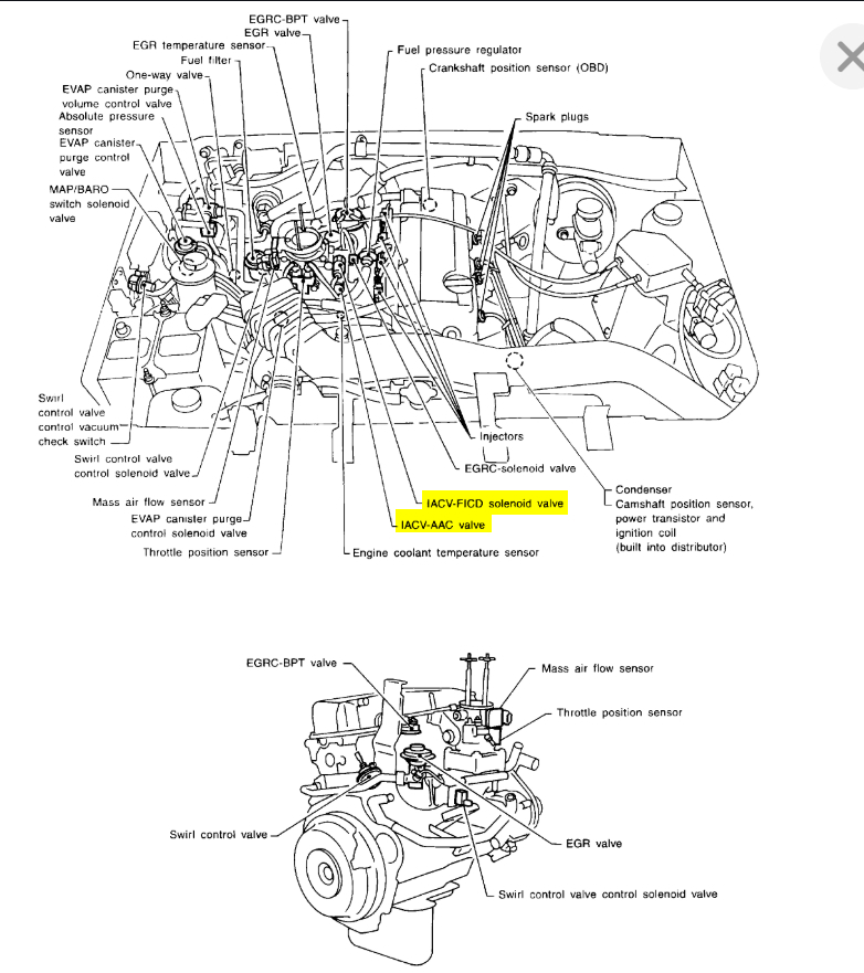

I was thinking it might be the idle control valve I call it. I don't know the technical name for it .
Does the idle control valve give me a check engine code if it's bad or does the IAC give a code is it goes bad ?

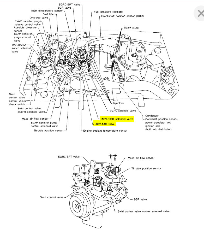

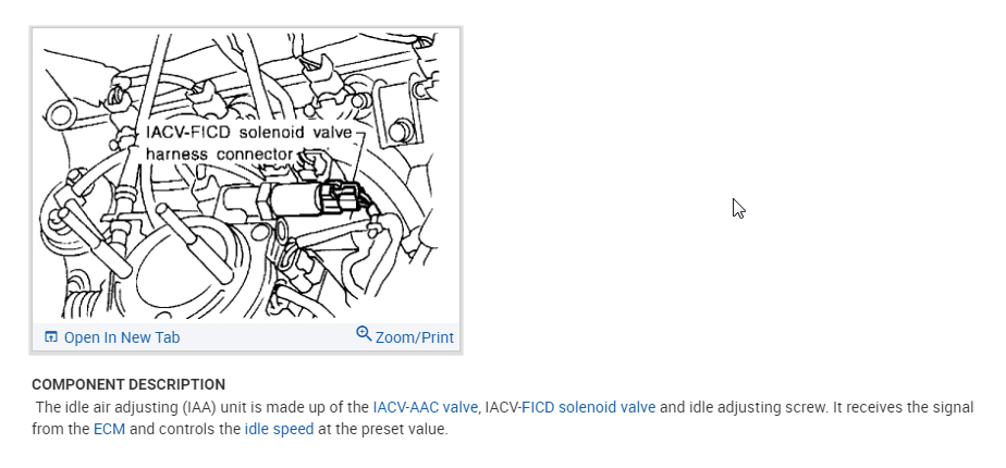

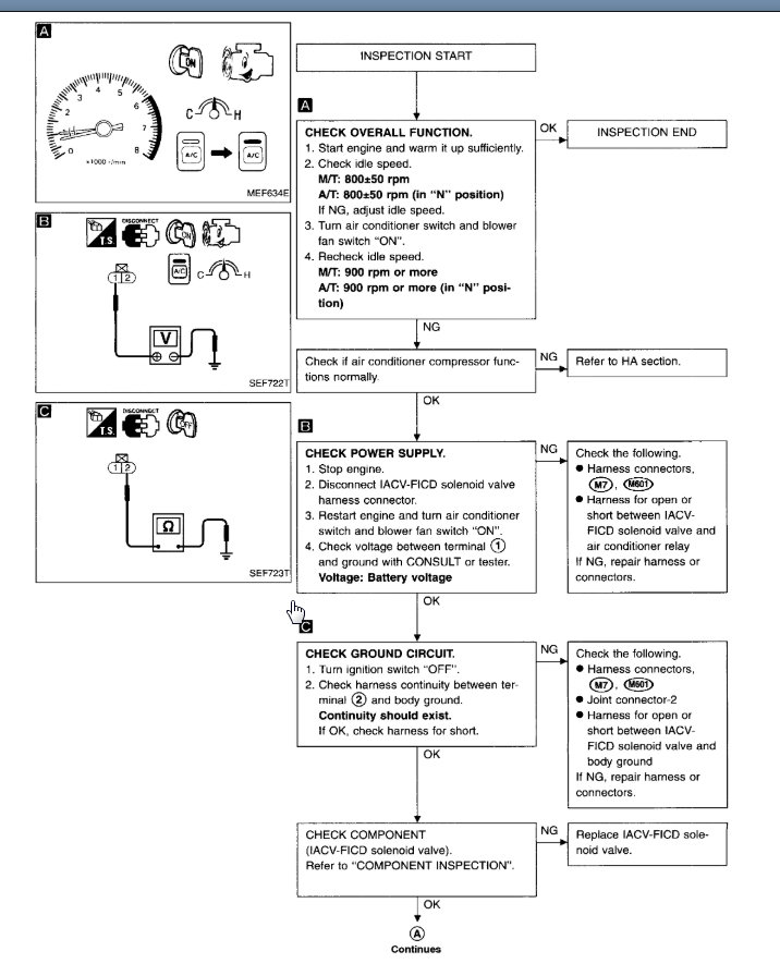

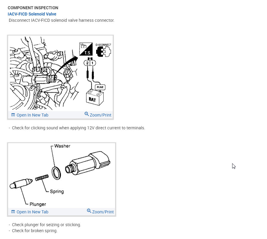

More than likely you are correct that it is the idle control valve. Your specific component is called the idle air adjusting unit.
If it were me I would go ahead and replace it. You can clean them but again, they are cheap enough I would just go with new one and then clean the old one so you always have a spare.

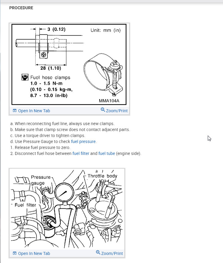

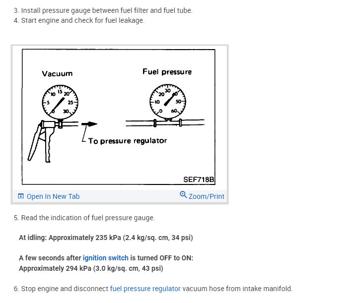

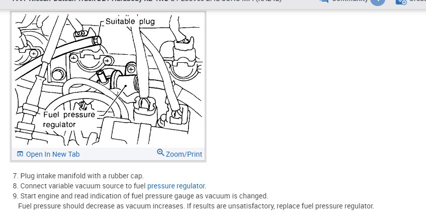

It could but if you monitor the fuel pressure you should see a change that corresponds with the surging if it is fuel related. If you don't then it is air control related.
