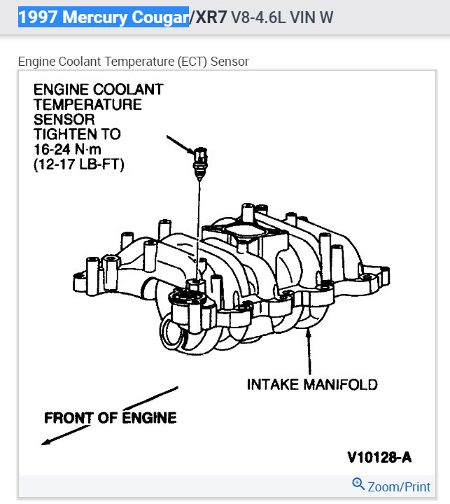

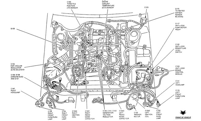

Use the image upload link here at the bottom of the text box to the left. It sounds like you have an engine coolant temperature sensor that is not working right. Here is a guide to help you see what you are in for when doing the job and a diagram to show you where is it in your car:

We hooked it up to the computer and got code p0320. For 90% of vehicles that is a crank shaft sensor. The part was $30.00 and my neighbor charged $30.00 labor. It took him about one hour to change. I let the car idle for about an hour before driving. I shut it off and restarted several times after that hour. I have been taking short drives and not had any problems. Thank you for your help, but you missed the mark this time.
