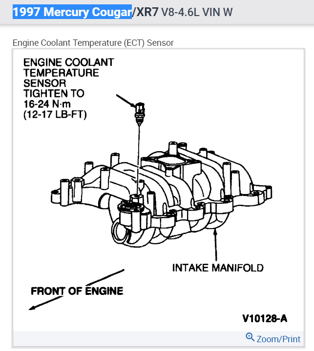

I was wrong, what I thought was PCV valve was only a connector. I did replace the hose on it though. Also cleaned the throttle body with carburetor cleaner. After reading your reply, I checked all vacuum connections with no variance in idle speed. It did still stall out after about forty five minuted of idling and would not start without starting fluid. My neighbor, who is a part-time mechanic suggested the air flow controller (not sure exactly what he called it, I will attach picture of it). We will be hooking up to a diagnostic computer shortly but waiting on another neighbor to help out. Engine runs and accelerates great until around the forty five minute mark.

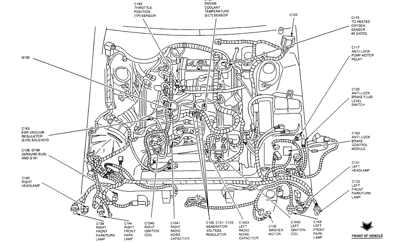

Use the image upload link here at the bottom of the text box to the left. It sounds like you have an engine coolant temperature sensor that is not working right. Here is a guide to help you see what you are in for when doing the job and a diagram to show you where is it in your car:
https://www.2carpros.com/articles/coolant-temperature-sensor-cts-replacement
