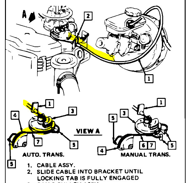

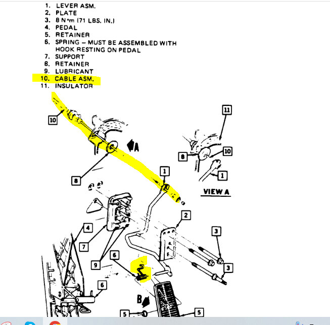

How high is the idle speed? Also, have you checked to see if there are diagnostic trouble codes stored in the computer?
This vehicle has an OBD1 system that doesn't require a scan tool to retrieve codes. All you need is a short jumper wire or even a paper clip.
Here is a link that explains how to retrieve codes:
https://www.2carpros.com/articles/buick-cadillac-chevy-gmc-oldsmobile-pontiac-gm-1983-1995-obd1-code-definitions-and-retrieval-method
Try this and let me know the results. Also, let me know if you have checked for engine vacuum leaks. Additionally, confirm there is nothing binding on the throttle cable preventing the throttle plate from fully closing. See pics below
Let me know what you find.

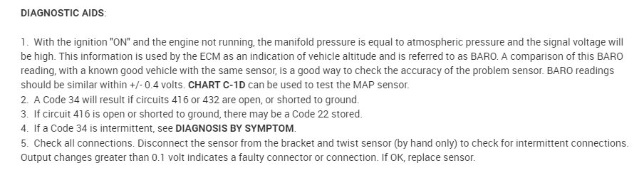

Yes, did the trouble codes gave a code of 34 which was the IAC replaced that did not fix the problem. Have checked the cable that seems to be good no vacuum leaks. Also, there are times when the car is idle high that it seems to just drive on its own without anyone pushing on the gas.
Jun 2, 2023 at 2:51 PM
  • 110,240 POSTS

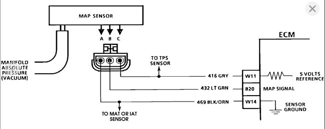

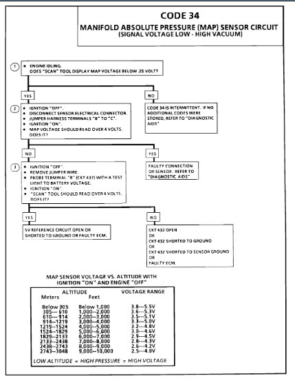

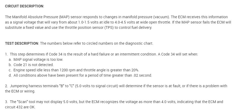

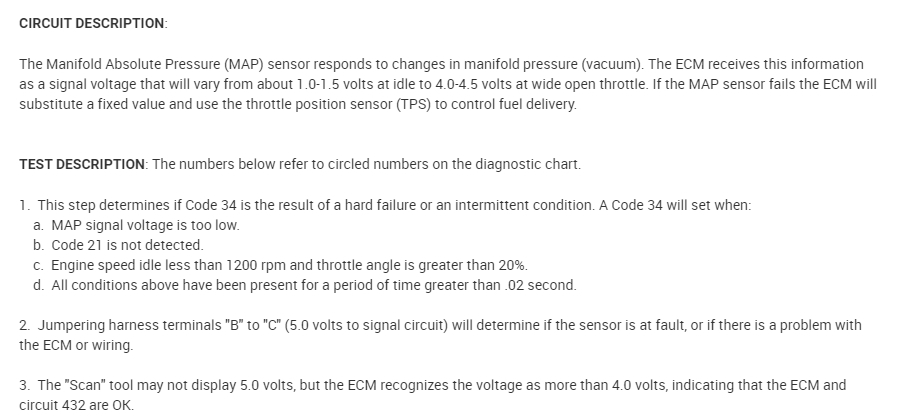

Code 34 is related to the manifold absolute pressure sensor (MAP). That could be causing the issue.
I attached the diagnostics below for code 34. Take a look through them and let me know if you are comfortable performing them.
Also, I attached a pic showing the location of the MAP.

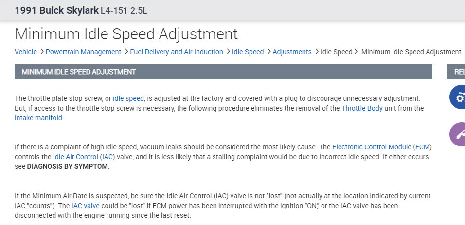

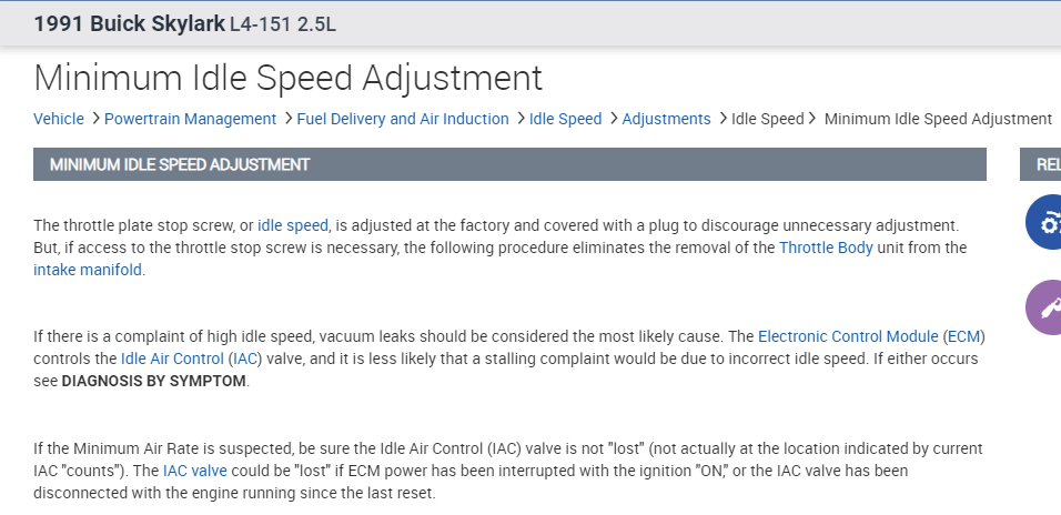

  • 110,240 POSTS

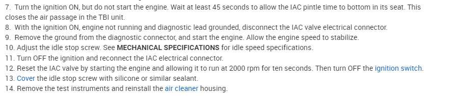

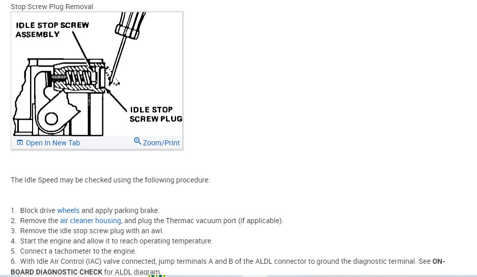

Okay, if you haven't already, check and confirm there are no engine vacuum leaks.
Here is a link that explains how this is done:.
If there are no leaks, take a look at the directions for idle speed adjustment. Since you already replaced the IAC, follow the directions where it discusses relearning the IAC. It starts with the number 6 toward the end of the pics.
