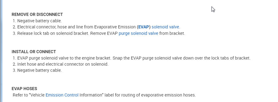

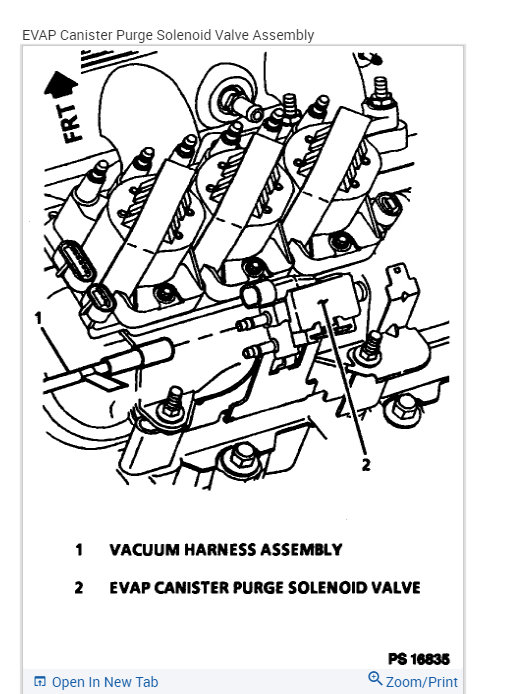

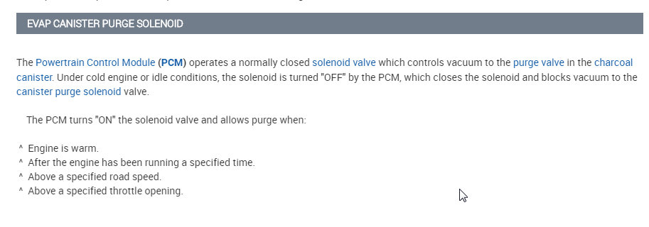

I suspect you have an issue with the purge valve. If these get stuck open then it can cause this issue. Basically the engine runs to rich and it will do what you are seeing.
I would remove the purge valve and inspect it to see if it looks like it has some charcoal build up in it. If it does then I bet you have raw fuel in the charcoal canister which breakdown the charcoal and causes the valve to stick.
Let me know what you find and we can go from there. Thanks
