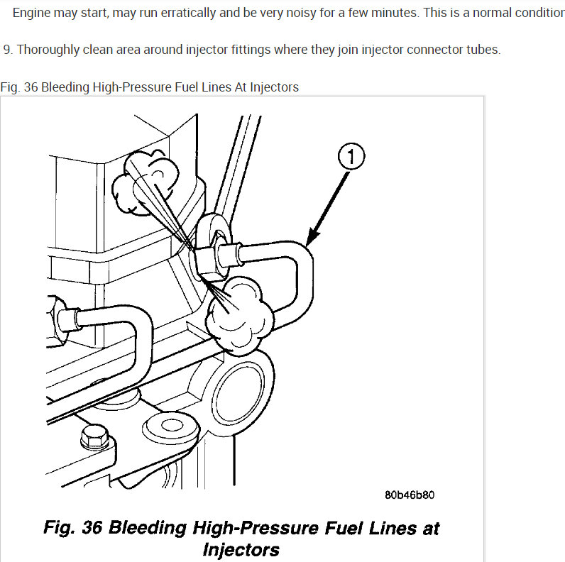

Okay, so i have a 24 v Cummins. She idles beautifully but after about 4 minutes she starts to rev up violently almost I feel like. Almost like she is bucking.
Oct 14, 2024 at 3:18 AM
  • 55,447 POSTS

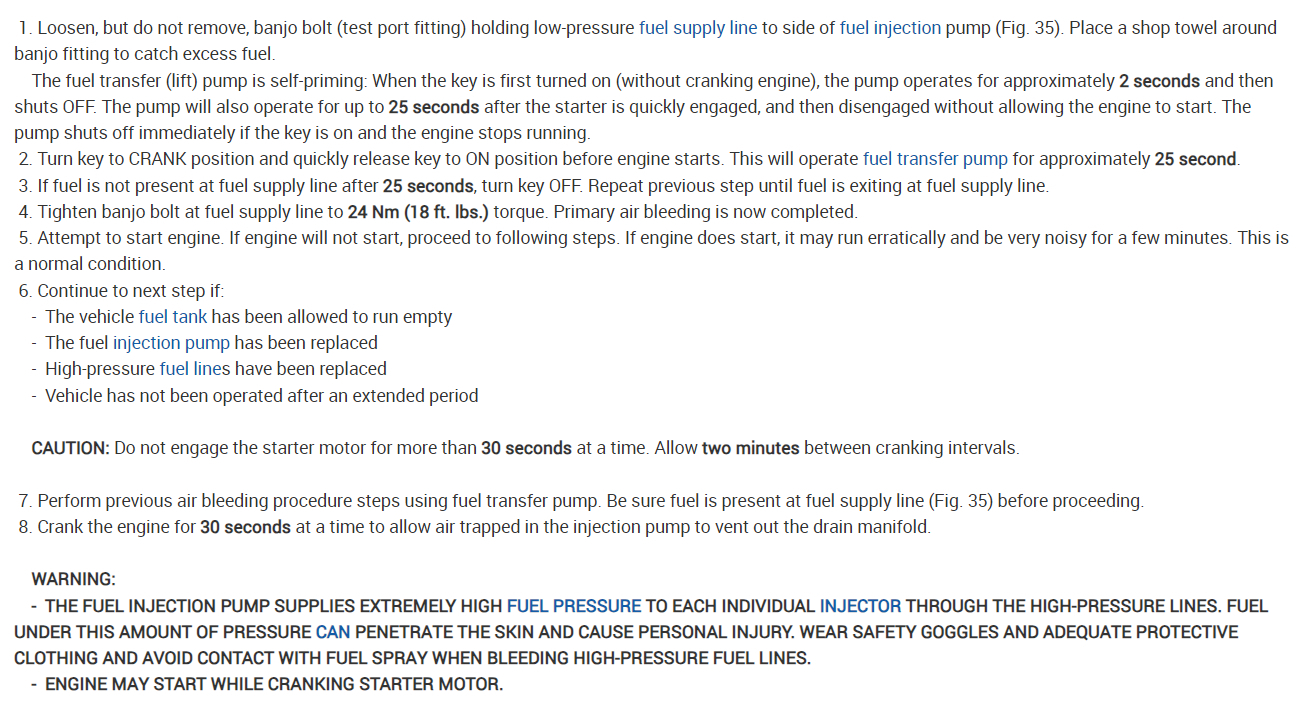

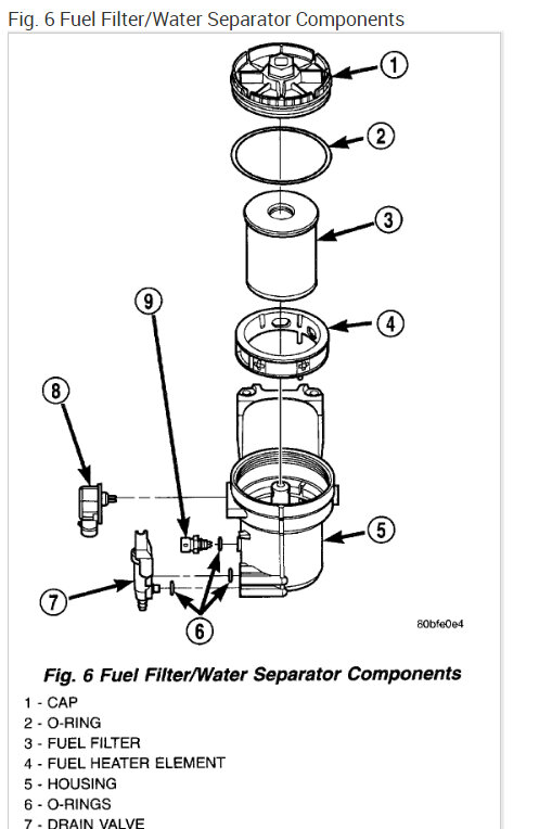

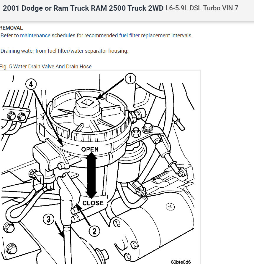

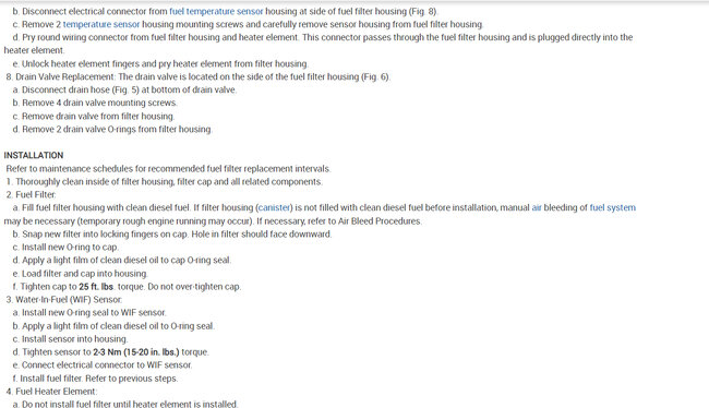

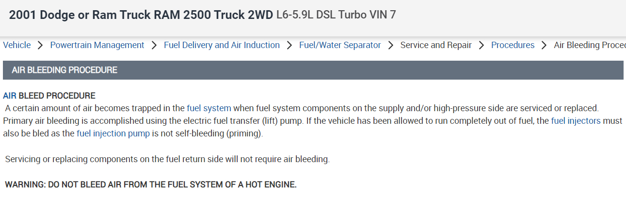

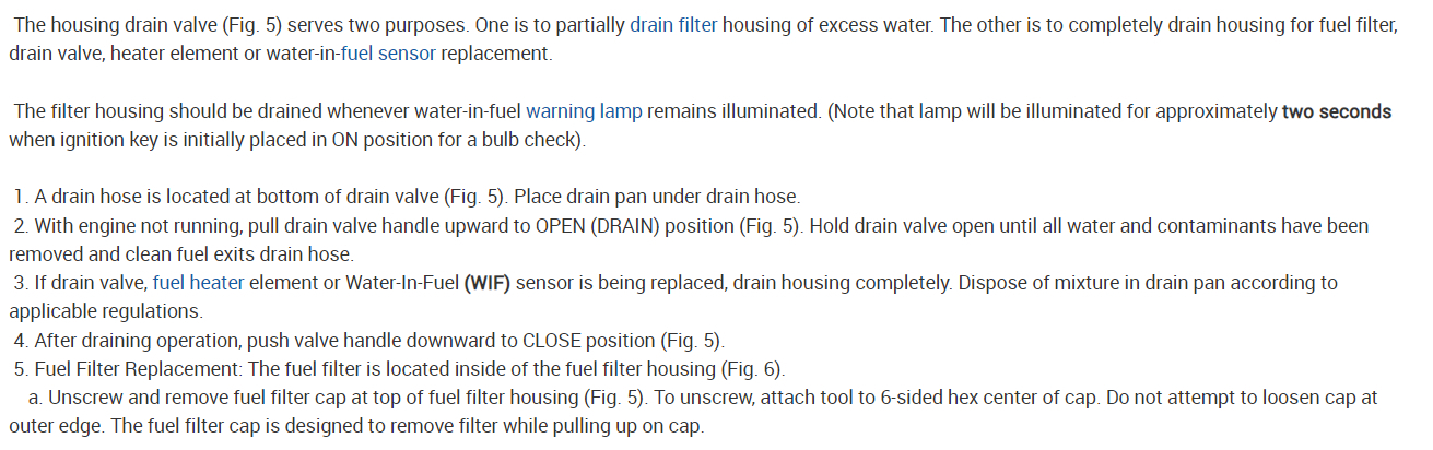

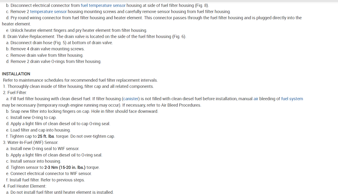

The #1 issue with diesel engine is the fuel filter and water separator. Here is how to change it out and I have included how to bleed the air out of the system as well, also, do you have check engine light on? If so, we should run the codes to see which ones are stored, this guide can help:
Check out the images (below). Please upload pictures or videos in your response of any problems so we can see what to help you with.
