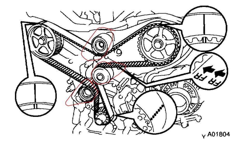

The noise and backfiring could be something with the valve train has failed.
https://www.2carpros.com/articles/engine-noises
https://www.2carpros.com/articles/engine-backfires-while-running

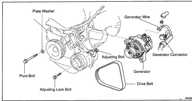

This sounds like a bearing from either the serpentine belt or timing belt. One of the pulley bearings may be making the noise.
https://www.2carpros.com/articles/vehicle-scraping-noise
I would remove the drive belt and see if the noise is still there.
https://www.2carpros.com/articles/serpentine-belt-tensioner-replacement
