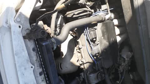

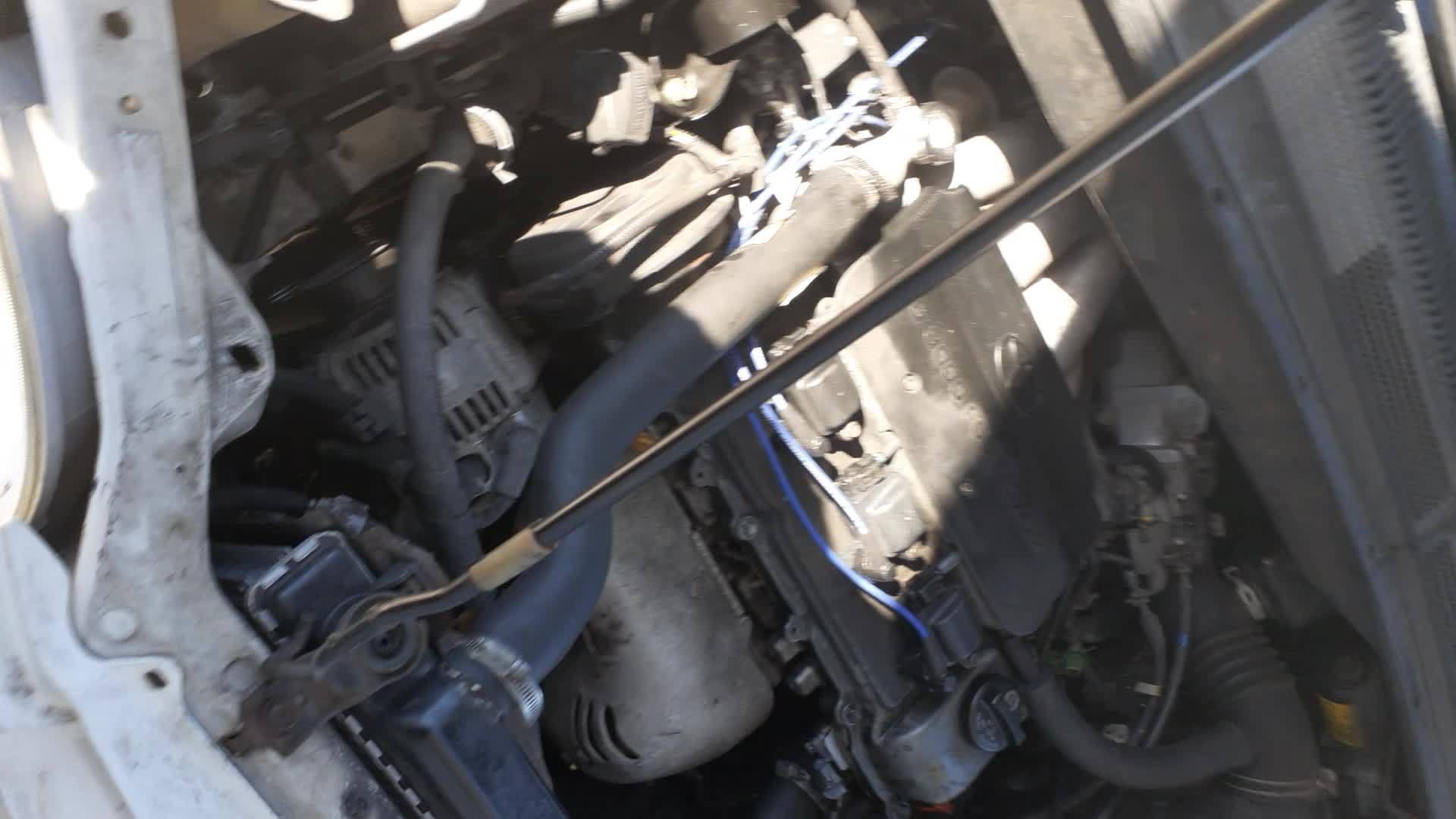

Sorry for the delay in uploading the video but here it is.
Thank you
Wednesday, January 20th, 2021 AT 8:09 AM

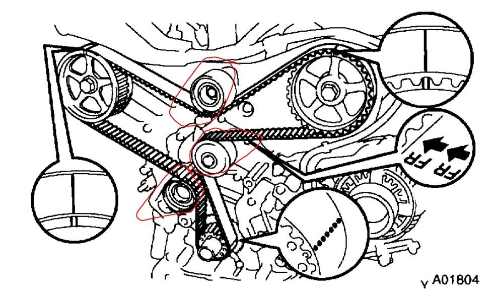

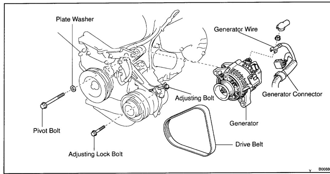

  • 52,797 POSTS
This sounds like a bearing from either the serpentine belt or timing belt. One of the pulley bearings may be making the noise.
https://www.2carpros.com/articles/vehicle-scraping-noise
I would remove the drive belt and see if the noise is still there.
https://www.2carpros.com/articles/serpentine-belt-tensioner-replacement

  • 52,797 POSTS
Low power could be from low compression, timing belt worn or cat converter being clogged.
https://www.2carpros.com/articles/engine-has-low-power-output
https://www.2carpros.com/articles/how-a-timing-belt-works
