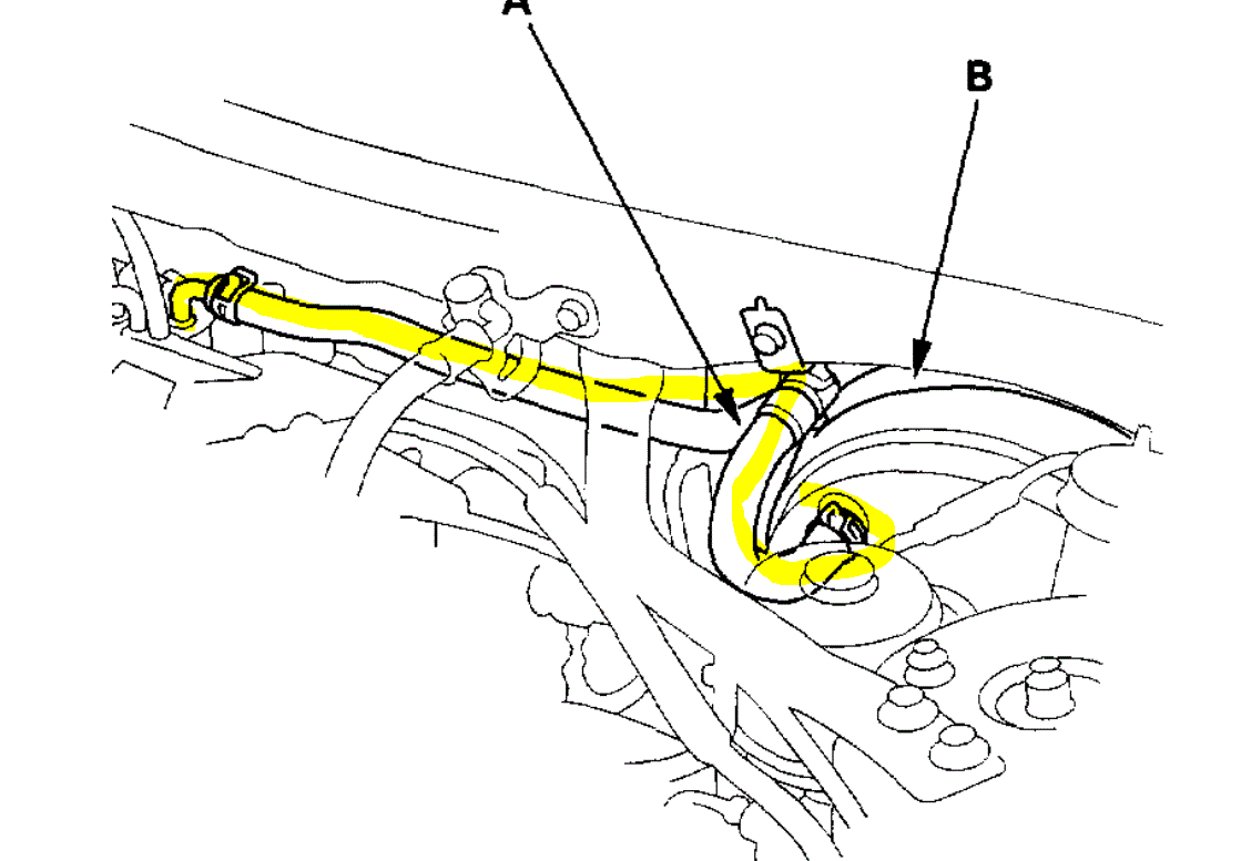

If you were able to remove a vacuum hose and it made no difference, that may be the hose leaking. How old is the gas? Also, are you sure fuel pressure is within specification? As far as a vacuum leak, here is a link you may find helpful. It explains in general how to locate and repair a vacuum leak.
Try that when it is at an idle and see if there is anything that causes the RPMs to increase.
Also, confirm there is a vacuum at idle to the power brake booster. See pic 1 below.
