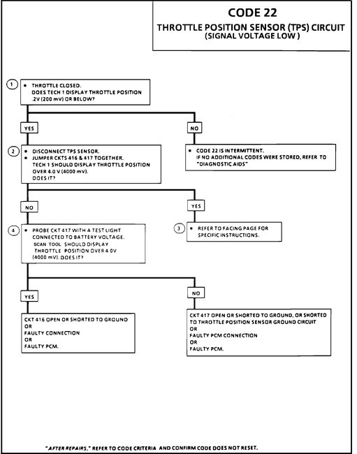

I have the SUV listed above 5.7L 350. I drove my truck one day and had zero problems with it. Came out later that day and she didn't want to start. Got her started and she idles fine. but when you put her in drive or reverse and give it some gas, she starts kinda sputtering and bogs down. I've checked plugs, wires, distributor cap and rotor. EGR valve seems to working fine. i can give her gas at idle and it does fine. it's only when in drive or reverse. any help would be greatly appreciated.

Okay. Pulled code. Got a code 22. Replaced TPS sensor, fuel filter, spark plugs and wires and distributor cap. still having the same issue.
Injectors are working great. Unplugged each one while running and engine stalled. What in the fudge is up with this thing, lol?

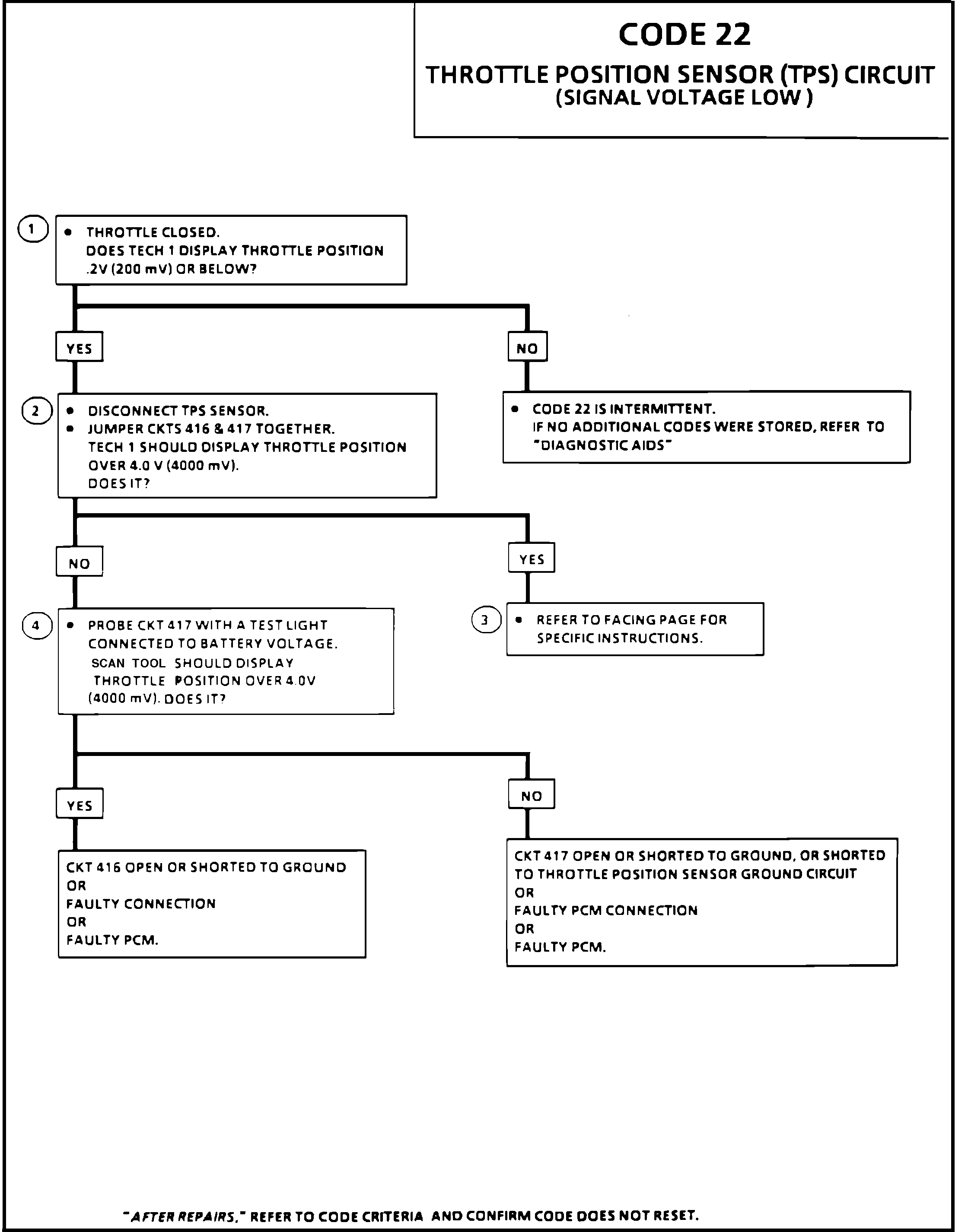

The code that you retrieved indicates the signal voltage is low. It could be a few different things. I have diagnostics for the code, but they indicate the use of a scan tool which will be hard to find.
Here are the diagnostics. The attached pics correlate with these directions.

Vehicle ALL Diagnostic Trouble Codes ( DTC ) Testing and Inspection Manufacturer Code Charts DTC 22 Power-train Controls - ECM/PCM With 4L80 Automatic Transmission
WITH 4L80 AUTOMATIC TRANSMISSION
Code 22 Throttle Position Sensor Circuit
See pic 1

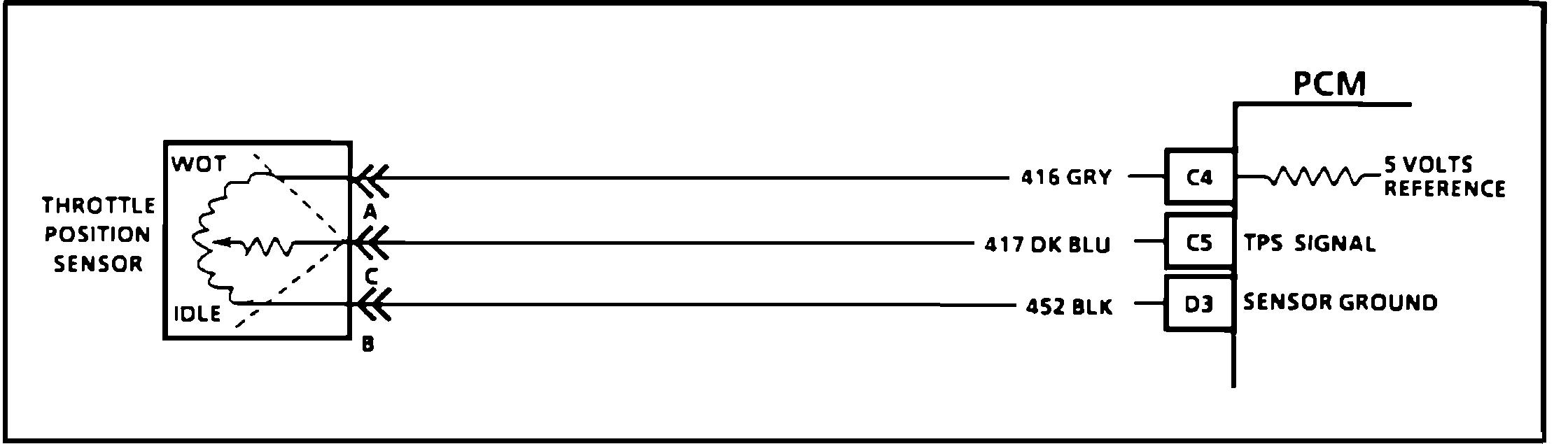

Wiring Diagram For Code 22 Throttle Position Sensor Circuit
See pic 2
CODE 22 - THROTTLE POSITION SENSOR (TPS) CIRCUIT
CIRCUIT DESCRIPTION:
The Throttle Position Sensor (TPS) provides a voltage signal that changes relative to the throttle blade. Signal voltage will vary from about .5 at idle to about 5 volts at wide open throttle.
The TPS signal is one of the most important inputs used by the PCM for fuel control and for most of the PCM control outputs.
TEST DESCRIPTION: Step numbers refer to step numbers on diagnostic chart.
1. Code 22 will set if:
^ Engine running
^ TPS signal voltage is less than about .2 volt for 1 second.
2. Simulates Code 21: (high voltage) If the PCM recognizes the high signal voltage the PCM and wiring are OK.
3. Replace TPS.
4. This simulates a high signal voltage to check for an open in CKT 417.
DIAGNOSTIC AIDS:
A "Scan" tool reads throttle position in volts. Should read about .45 volts 1.25 volts with throttle closed and ignition on or at idle. Voltage should increase at a steady rate as throttle is moved toward WOT.
An open or short to ground in CKTs 416 or 417 will result in a Code 22.
See DIAGNOSIS BY SYMPTOM - NO TROUBLE CODES STORED.
"Scan" TPS while depressing accelerator pedal with engine stopped and ignition "ON". Display should vary from below 1.25 volts (1250 mv) when throttle was closed, to over 4.5 volts (4500 mv) when throttle is held at wide open throttle position.
________________________________________
If you have a scan tool for this vehicle, use it. If not, the next thing I would suggest is to confirm a 5 volt reference to the grey wire at the TPS and then check for continuity at the black wire at the TPS. See pic 2
Make sure the connections at the PCM are clean, tight, and not corroded.
