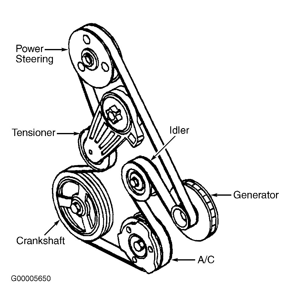

Replaced serpentine belt two months ago. Car starting making a squealing sound while driving, my friend said it is the idler pulley. Is that correct?

You could also have some grease on one or more of the pulleys, causing the belt to slip and squeal. Personally, I would take the belt off and use an old towel to clean off the pulleys. Then put the belt back on and see how it does. I am also attaching the belt routing diagram, in case your car does not have it under the hood any more.
