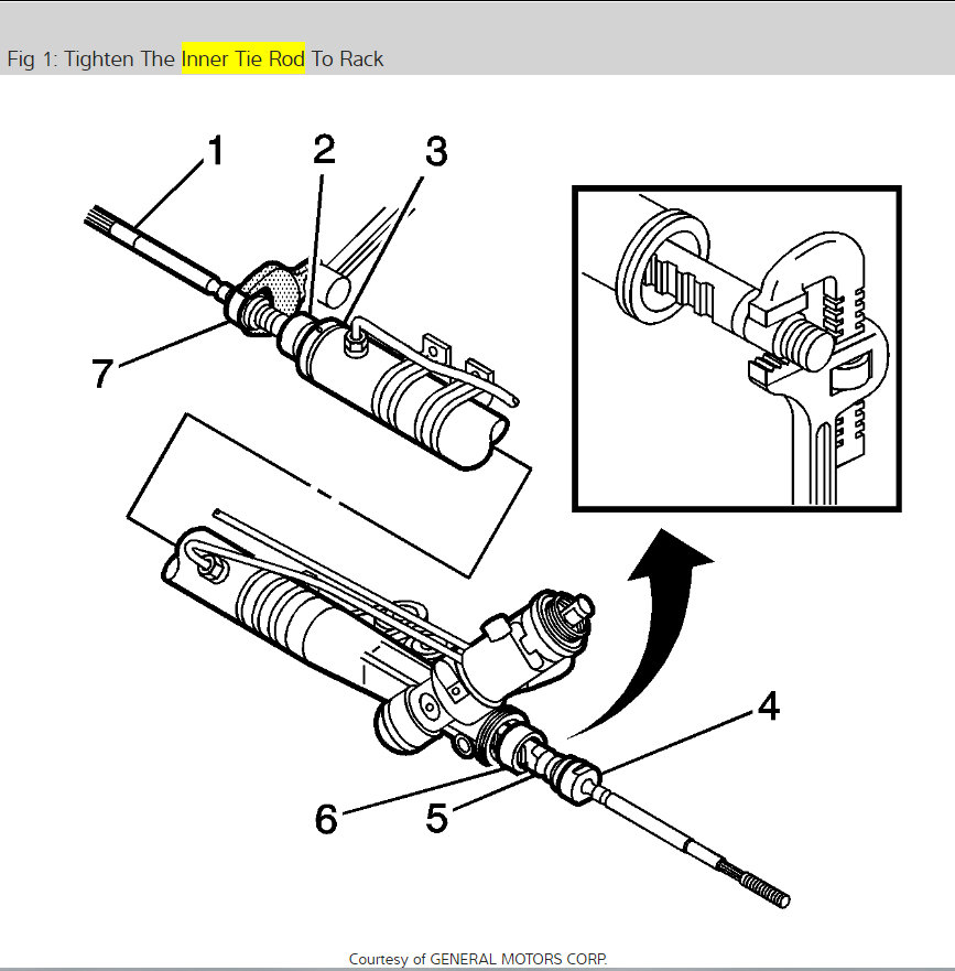

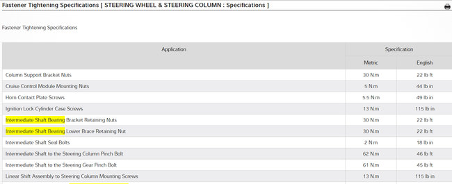

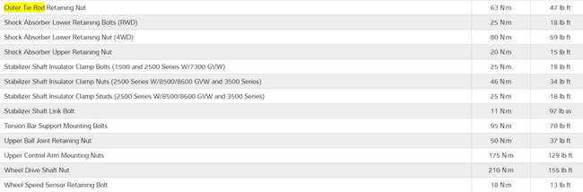

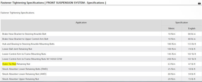

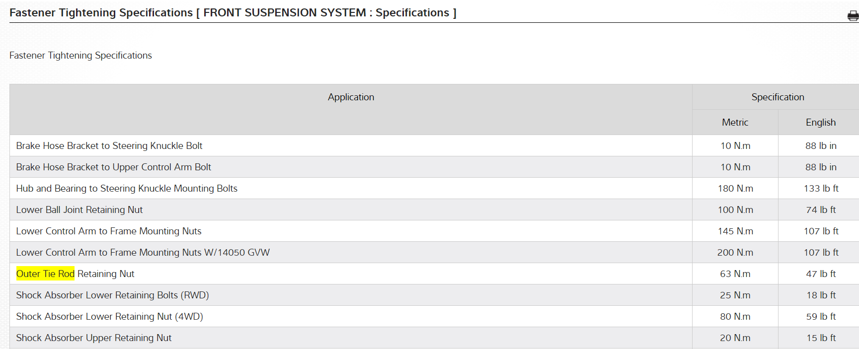

I am replacing the idler arm on my vehicle. And I need to know what the torque specs for the bracket to frame and the arm to the bracket.
Feb 25, 2019 at 5:14 AM
SCGRANTURISMO
  • 4,897 POSTS

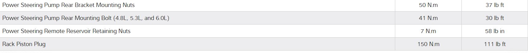

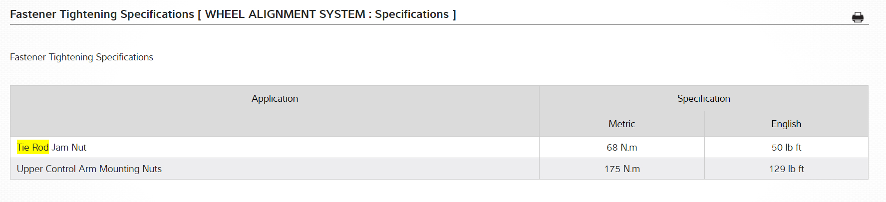

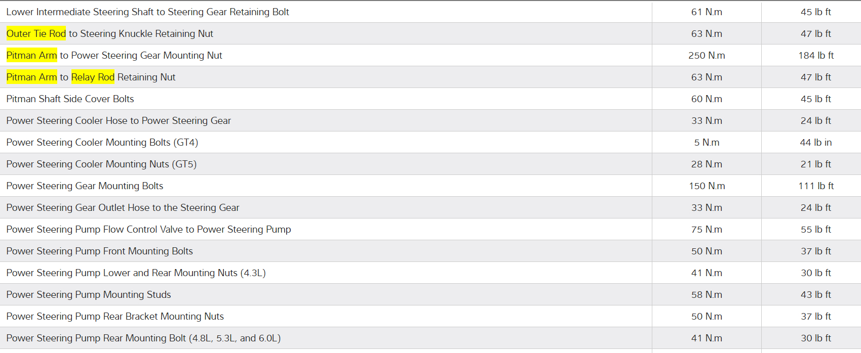

The information you requested is in the diagrams down below. I hope this helps.
Thanks,
Alex
2CarPros
Feb 25, 2019 at 3:05 PM
CONRADISH006
  • 53 POSTS

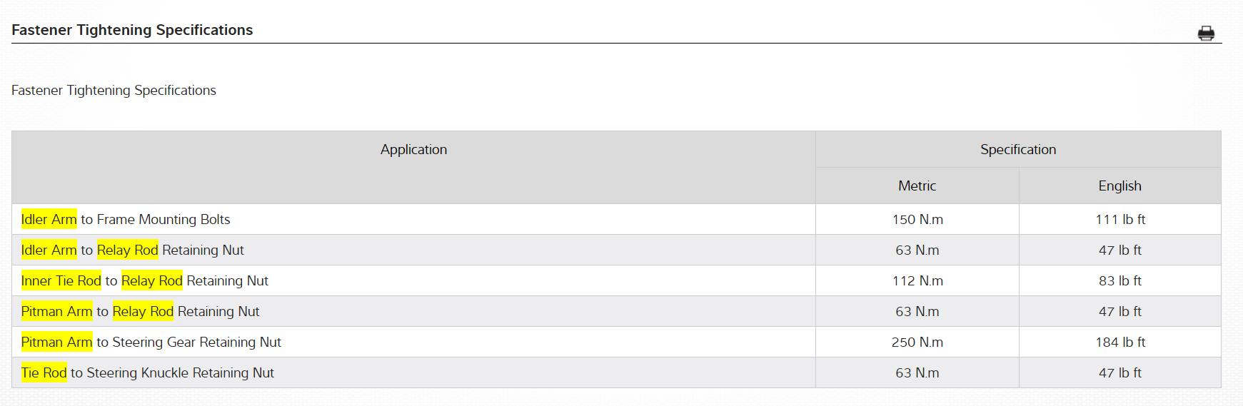

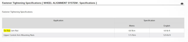

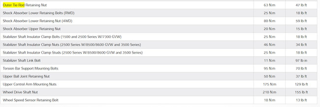

Are the mounting bracket to frame specs in there?
Feb 25, 2019 at 5:29 PM
SCGRANTURISMO
  • 4,897 POSTS

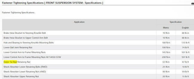

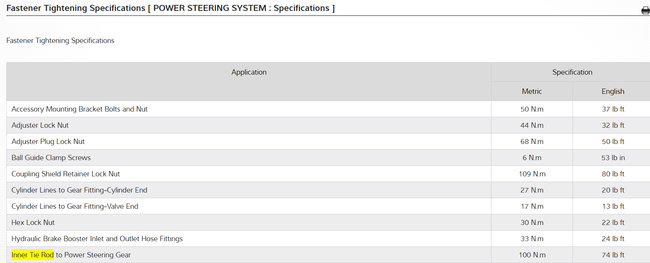

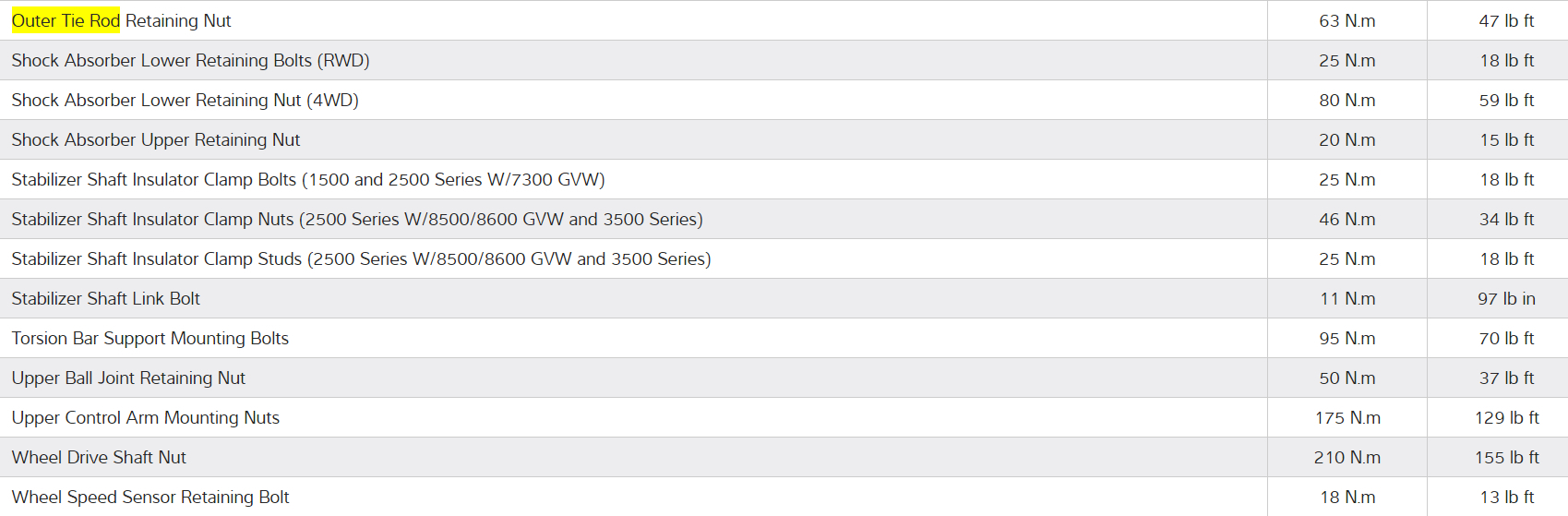

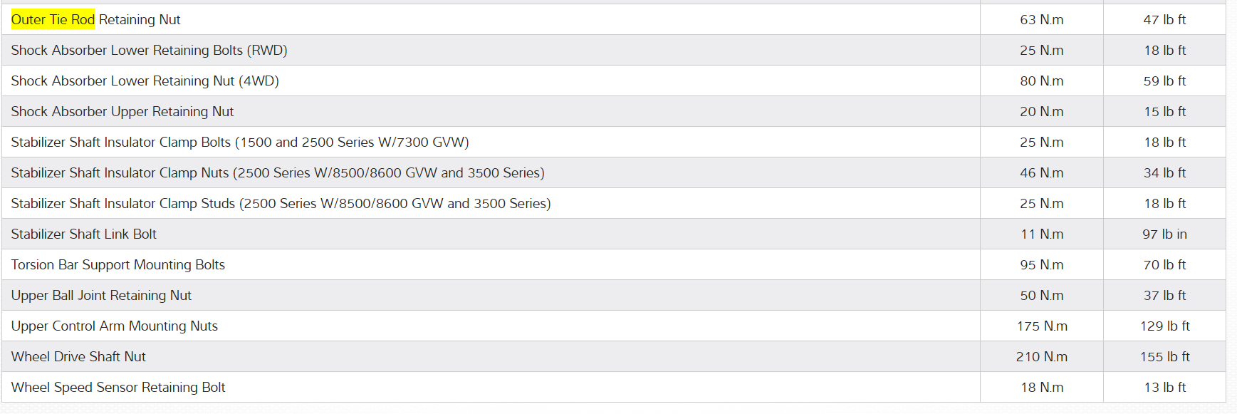

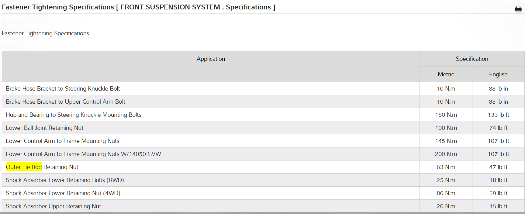

Hello again,
I'm sorry about that. I thought I had included that in my prior answer to you. I have the entire front suspension torque values listed in the diagrams below for you. I hope this helps.
Thanks,
Alex
2CarPros
Feb 26, 2019 at 2:28 AM
CONRADISH006
  • 53 POSTS

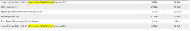

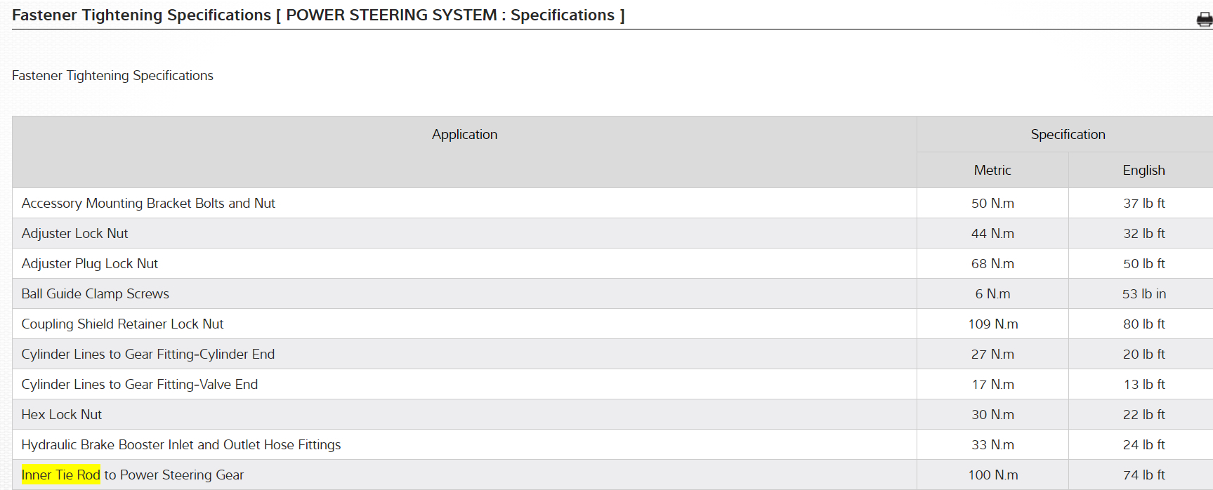

So if I am reading those pages correctly the idler arm gets torqued to the bracket to 111 FT-LB. And the bracket gets torqued to the frame to 71 FT-LB. And the idler arm gets torqued to the intermediate shaft to 47 FT-LB.

I forgot to say that my van is a 3500. And 9600 lb GVWR.

Hello again,
The torque specs are the same for the 2500 and 3500.

I am correct? About the torque specs.

Hello again,
Yes.
