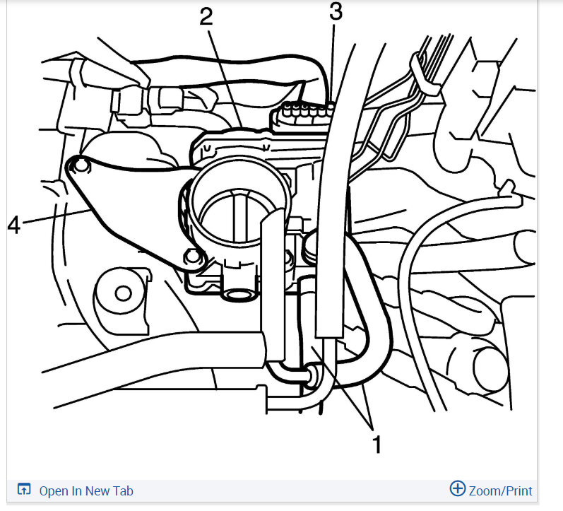

Where is the Idler air control valve located?

Location of idler air control valve with pictures.

This car does not have an idle air control motor. The idle speed is controlled by the throttle body, what problem are you having? Stalling at idle? This guide can help:

Has low idle not running rough, just low idle.

Was wondering if idle can be adjusted.

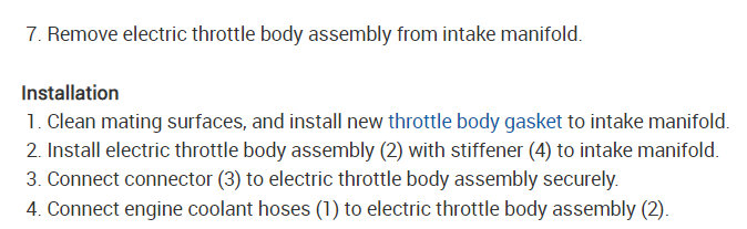

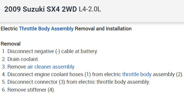

It cannot be adjusted; the computer sets the idle speed. I would service the throttle bore and check for vacuum leaks. This guide will help, and I have included instructions for your car in the images below:
Use this guide when the engine is cold only:
Check out the images (below). Please upload pictures or videos in your response of any problems so we can see what to help you with.
