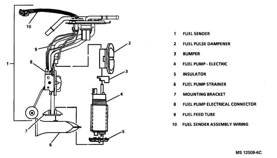

Thanks. The pressure needs to be 45 lbs.
https://www.2carpros.com/articles/how-to-replace-an-electric-fuel-pump
You need a fuel pump.
procedure
CAUTION:
- Do Not handle the fuel sender by the fuel pipes. Due to the length of the pipes, the amount of leverage generated by handling the pipes could damage the solder joints.
- Always replace fuel sender O-rings when reinstalling fuel sender assembly.
REMOVE OR DISCONNECT
1. Negative battery cable.
2. Perform Fuel Pressure Release procedure.
3. Drain fuel tank.
4. Fuel tank.
5. Fuel sender assembly.
FUEL PUMP STRAINER
1. Support pump with one hand and grasp strainer with other hand.
- Rotate strainer in one direction and pull off of pump. Discard strainer after inspection.
Inspect
- Fuel pump strainer. If strainer is contaminated, the fuel tank should be cleaned.
- Fuel pump inlet for dirt and debris. If found, fuel pump should be replaced.
FUEL PUMP
1. Fuel pump electrical connector.
2. Place fuel sender assembly upside down on bench.
3. Pull fuel pump downward to remove from mounting bracket, then tilt pump outward and remove from fuel pulse dampener.
CAUTION: Do Not run fuel pump unless submerged in fuel.
FUEL PULSE DAMPENER
1. Note position of fuel pulse dampener on inlet pipe, then remove fuel pulse dampener from pipe.
Inspect
- Dry fuel pulse dampener with a shop towel.
- Shake fuel pulse dampener while listening for trapped fuel movement inside.
- If fuel is heard inside fuel pulse dampener, replace.
FUEL SENDER
1. Transfer fuel pump and fuel pulse dampener to new fuel sender.
ASSEMBLE
1. Fuel pulse dampener in same position as noted during disassembly.
2. Rubber bumper and rubber insulator on fuel pump.
3. Position fuel sender assembly upside down.
- Install fuel pump between fuel pulse dampener and mounting bracket.
4. Fuel pump electrical connector.
NOTICE: Always install a new pump strainer when installing fuel pump.
5. New fuel pump strainer on fuel pump and push on outer edge of ferrule until fully seated.
INSTALL OR CONNECT
1. Fuel sender assembly.
2. Fuel tank.
3. Add fuel and install fuel filler cap.
4. Negative battery cable.
INSPECT
Turn ignition switch to "ON," position for two seconds, then turn to "OFF" for ten seconds. Again turn to "ON" position, and check for fuel leaks.
