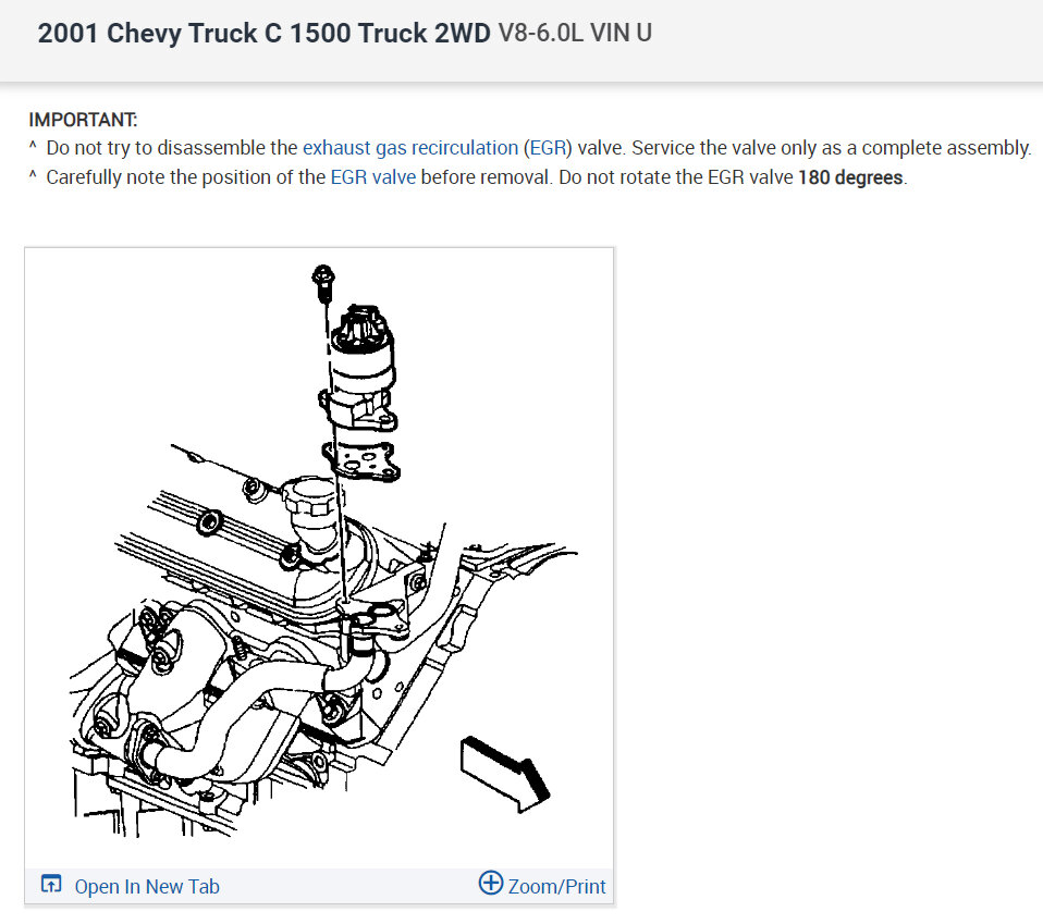

The P0507 code indicates an issue with the Idle Control System RPM being higher than expected. This can be due to a sticking EGR valve, or a vacuum leak, I would follow this guide when the engine is cold:
and here is the location of the EGR and how to test it, check out the video below:
https://youtu.be/DqUCbbKdWf4?si=y1UuWeEzcUJzA9K5
Check out the images (below). Let us know how it goes.

Since my truck is old, I replaced the EGR valve. I attached a smoke machine and saw smoke coming out of the EGR pipe going into the intake manifold. I fixed that and confirmed that by no smoke coming out

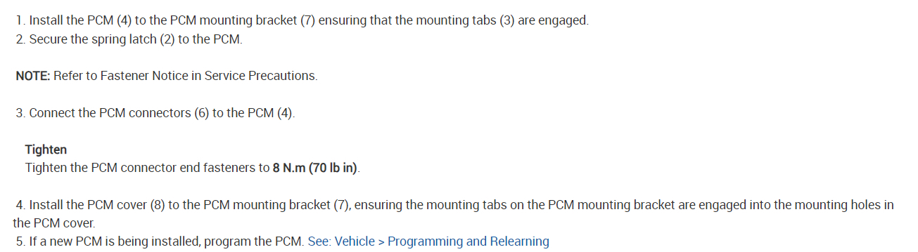

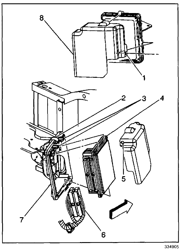

If you have no vacuum leaks and you replaced the IAC motor it sounds like you have a bad PCM. I would send it in for testing which you can find by searching google or eBay. Check out the images (below). Please let us know what happens.
Jun 21, 2024 at 2:56 AM

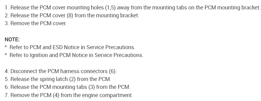

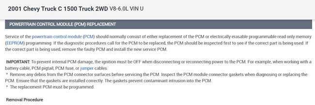

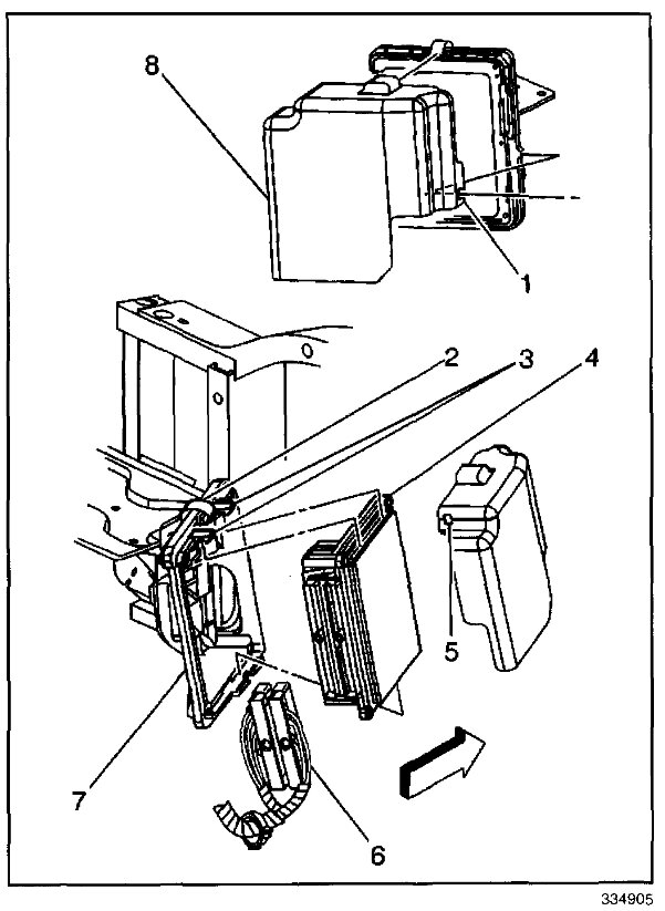

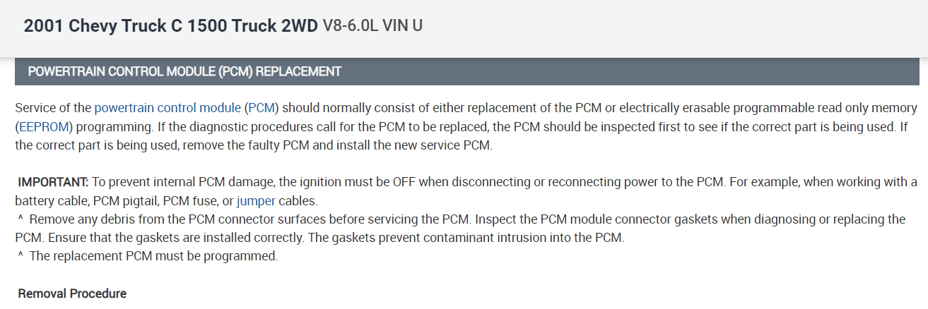

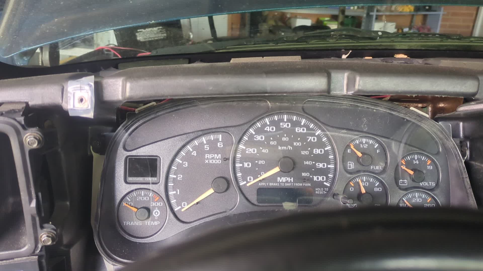

Hi Ken, I replaced the PCM and did the relearn process (10 min, 30 sec, 10 min, 30 sec, 10 min, 30 sec). I had an AC leak in my evaporator core, so I had to remove the dash to get to the heater and evaporator core. So my truck has been in the garage for about 2 1/2 weeks. Now when I start the truck I can hear the starter engage but the truck doesn't start. I need to get it started so that I can pare the new PCM with the crank shaft sensor and replenish my AC. What would make it not start after replacing the PCM?
Ron
Jul 13, 2024 at 8:05 AM
  • 55,222 POSTS
Was the PCM pre-programmed? If not this will be the problem. Also, is the security light flashing?
Jul 13, 2024 at 9:14 AM
RLPETERSON78
  • 147 POSTS

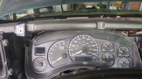

I got the PCM from a automotive junk yard. It is the same one as my old one according to the numbers on it. I have included a video of what happened when I try to start it.
Jul 13, 2024 at 9:33 AM
  • 55,222 POSTS
Yep, the PCM needs to be programmed to the truck (VIN), you can see the security light on which will not allow the engine to start. Thanks for the video, it helps. You can get a preprogrammed unit by searching Google or Ebay.
