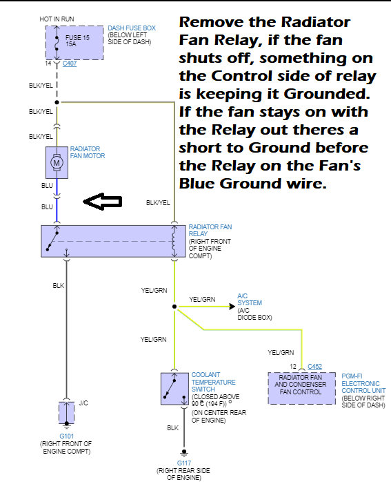

cooling fan comes on right from the start cold after car warms up idle surge up and down never stops.

I have replaced the idle control valve, the coolant fan relay thermostat and heat sensor switch, and relieved the air from the system but nothing stopped the idle surging up and down.

Hello, considering you have replaced the Air idle control valve, which are a huge problem on Honda's, it sounds like you may have a vacuum leak. Does the surging go away when you have your foot on the gas pedal and are at a higher Rpm? And the coolant fan shouldn't come on right at a cold start. Here's the Fan circuit below.

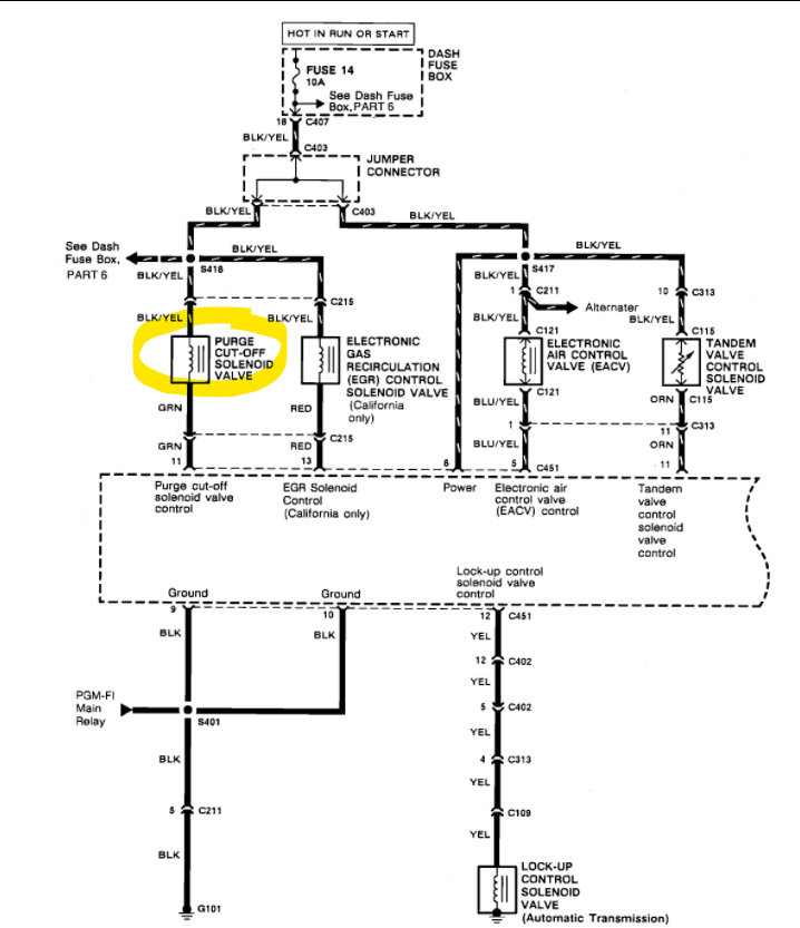

We usually use a smoke machine for vacuum leaks, but here's a guide for diagnosing a vacuum leak. We have limited wiring diagrams for a vehicle this old. but also try unplugging the purge valve and blocking off its tube to the intake manifold, do the same with the brake booster hose.

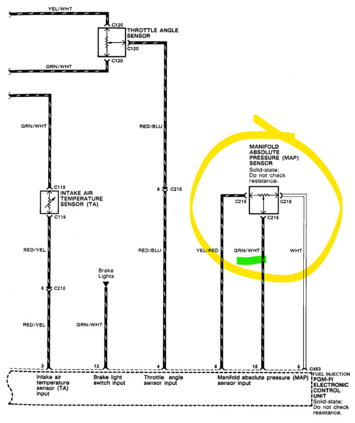

You can also check the MAP sensor, back probe the connector with your multimeter on the green/white wire and see if it changes when you press the gas pedal. A faulty Coolant temperature sensor or Intake air temperature sensor can cause surging on Honda's as well.
