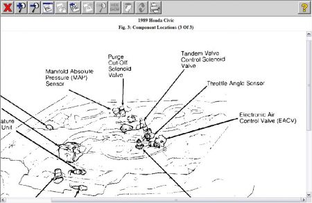

TAS Location
https://www.2carpros.com/forum/automotive_pictures/12900_TAS_1.jpg
Wednesday, October 31st, 2007 AT 1:53 PM
SHSESC
  • 12 POSTS
My brother was driving home from work and the check engine light came on, then when he turned it off and on again it went away. I checked and it just happens to be code 7, Throttle Angle Sensor, however it's too dark to check under the hood. I'll check it this weekend.
Thanks for the diagram
Wednesday, October 31st, 2007 AT 7:37 PM
