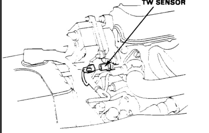

Two things come to mind; First is the engine coolant temperature sensor can be fluctuating causing the idle to do the same. Next would be a dirty throttle bore IAC. Here are two guides to help you see what you are in for when doing the job:
https://www.2carpros.com/articles/how-to-replace-an-idle-speed-control-motor-iac
and
https://www.2carpros.com/articles/coolant-temperature-sensor-cts-replacement

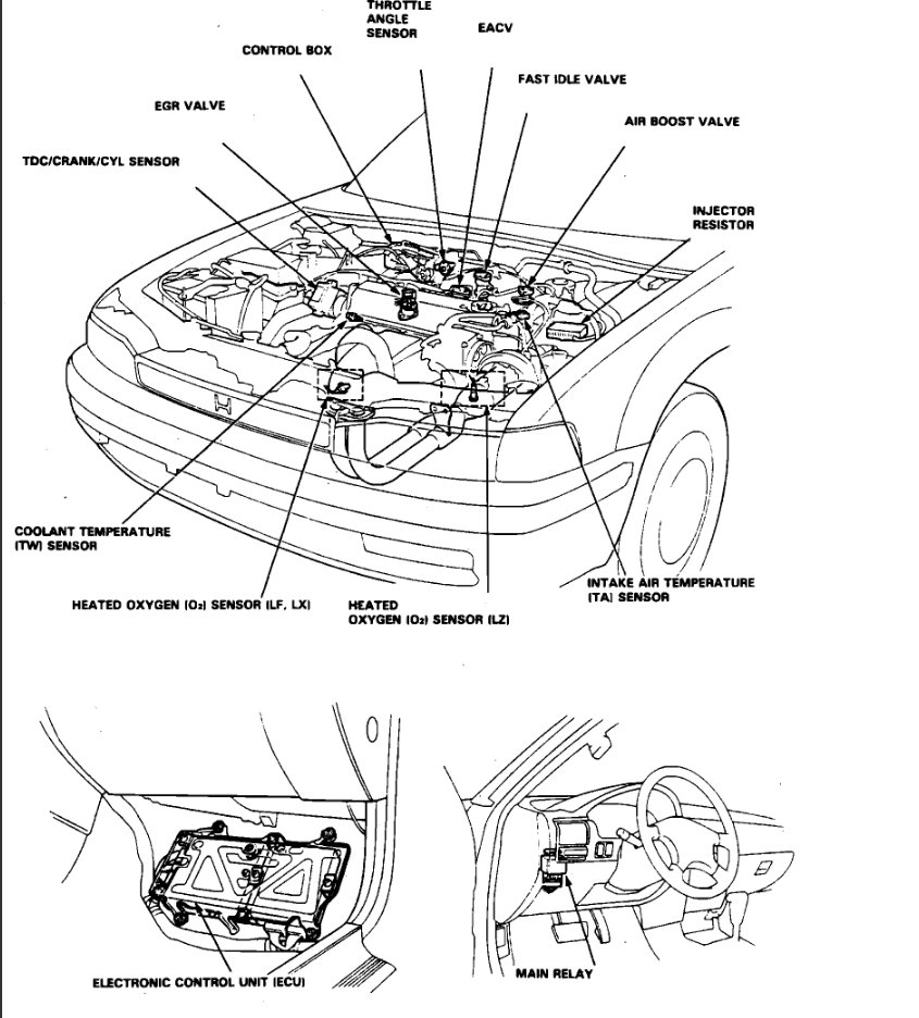

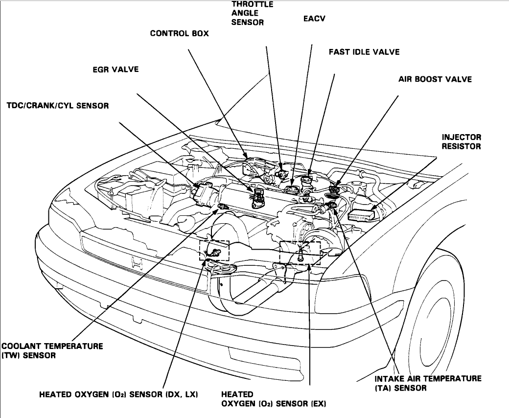

I had a thought that the EGR can be leaking. Here is the location of the valve and a video to help you test it once it is off:
https://youtu.be/DqUCbbKdWf4
Monday, June 11th, 2018 AT 11:26 AM

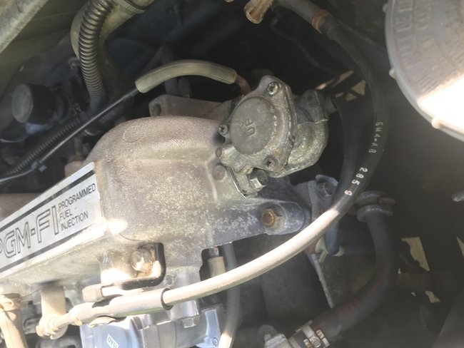

Air boost valve? Do you mean the brake booster? Can you take a picture?
Friday, June 15th, 2018 AT 10:03 AM
NICKL
  • 38 POSTS
Glad it surprised you too! It is to the right of the FIV in the picture you sent me. Honda part number 17340-pt2-000. Funny thing is I cannot find it anywhere, auto stores, web etc. 0 vacuum line goes into control box, not sure if it goes to MAP or canister. I blocked the passages with a soda can, and problem is still there but now only under load and very consistent. AC and any blower speed seems to show surge pretty quickly, with AC and blower off, I have to work at getting it back, blower, lights, rear defrost, etc, sooner or later it returns. I am calling it a "surge" problem, but really it is a high idle. I can notice it in gear also, when I have the problem, idle is about 1,000 rpm's with foot on brake at stop. Without problem idle is below 600 to 800 rpm's. If I put car in neutral idle slowly climbs to 2,000 rpm's, and surge returns. I attached picture of valve.

Yes, getting warmer. That is the air boost valve there is a fast idle valve as well. I would remove them and see if there are working correctly used a vacuum pump to see if the diaphragms are still good and hold vacuum.
Here is a guide of the locations (below) also look inside and clean any gunk that maybe present.
Check out the diagrams (below). Please let us know what you find.
Saturday, June 16th, 2018 AT 11:12 AM

Already done that, air boost valve does not hold pressure. I have it blocked for now until I find other problem. FIV is new and does not have a diaphragm, aicv is also new.

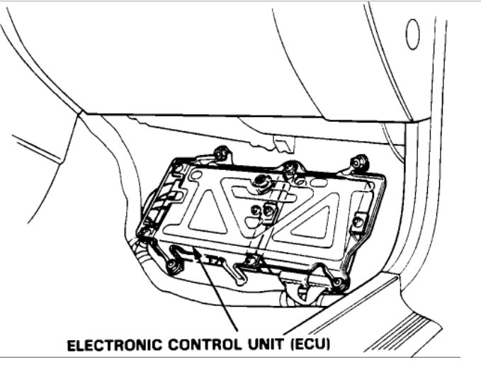

I wanted to see if it was an throttle bore issue or something else was causing it. I am starting to think it is a PCM issue. I would try replacing it with a used unit here is the location.
Monday, June 18th, 2018 AT 10:39 AM

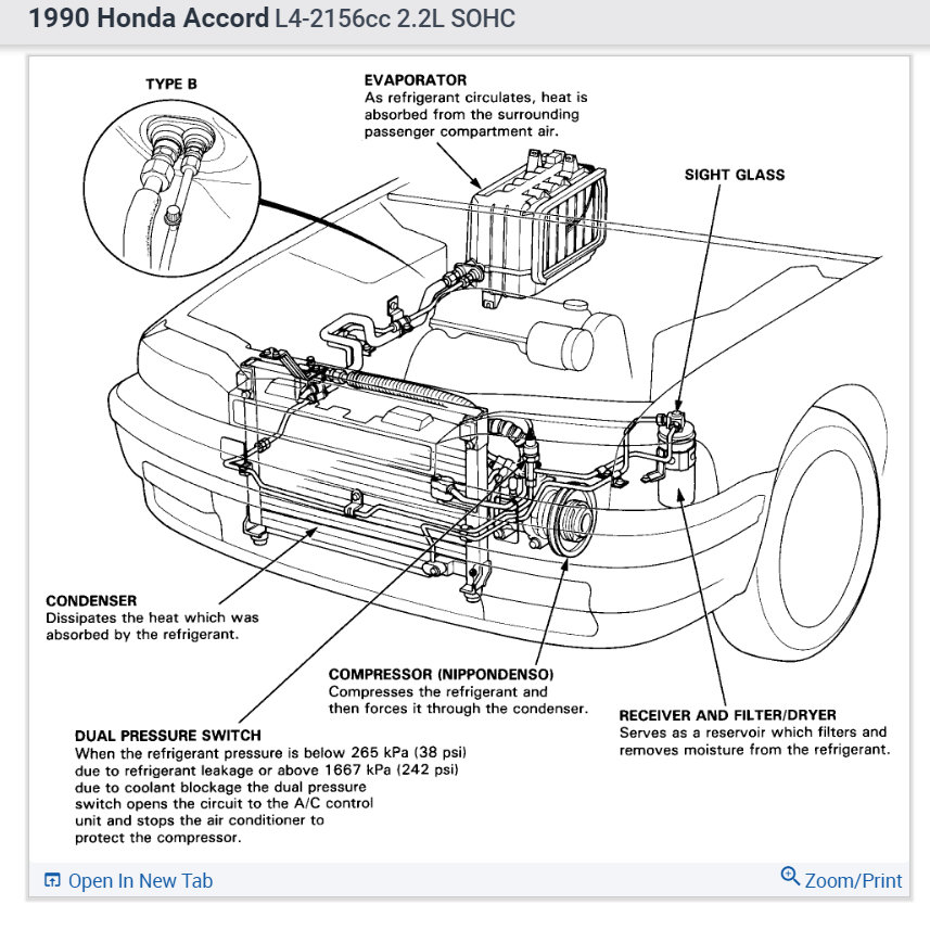

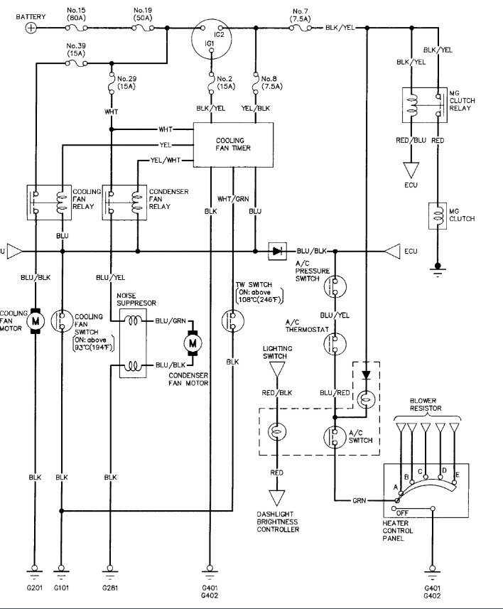

Can you see what is clicking? Lets check the AC system grounds it sounds like they could be back-feeding. Here is the wiring diagrams and a guide to help:
I want to say something might be up with the dual pressure switch, can you disconnect it to see if the idle does the same thing?
