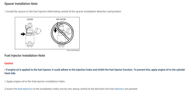

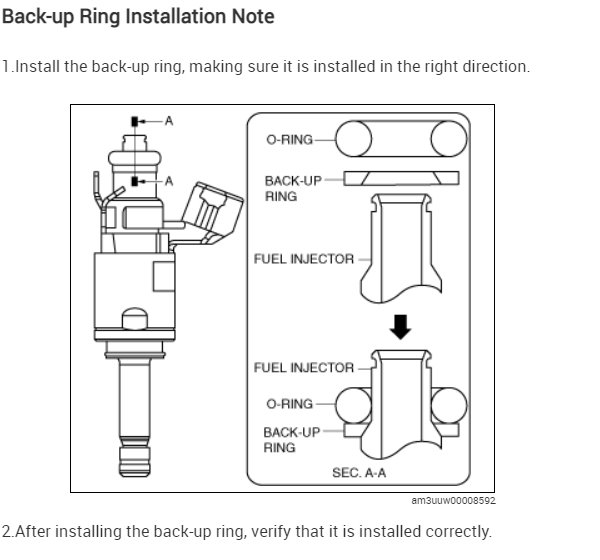

Hi, my car has idle only misfires on cylinder four mainly and to a less degree on cylinder two. There is no CEL. The mechanic has tested for vacuum leaks and compression and there seems to be no issue there. Spark Plugs and coils were changed, and the issue has not been resolved. Keen to hear your thoughts. Is it possible to swap injectors around to troubleshoot possible injector issue on a DI engine?

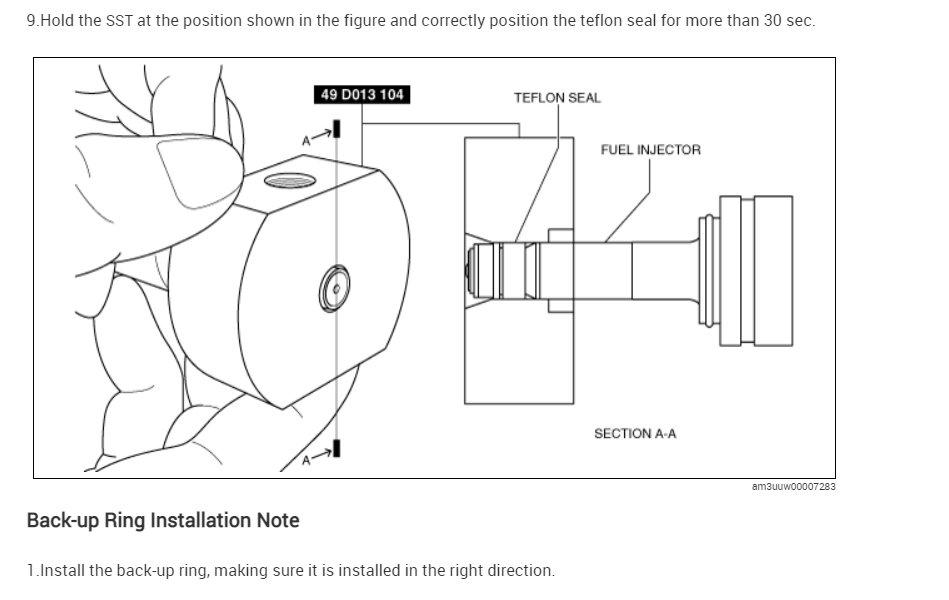

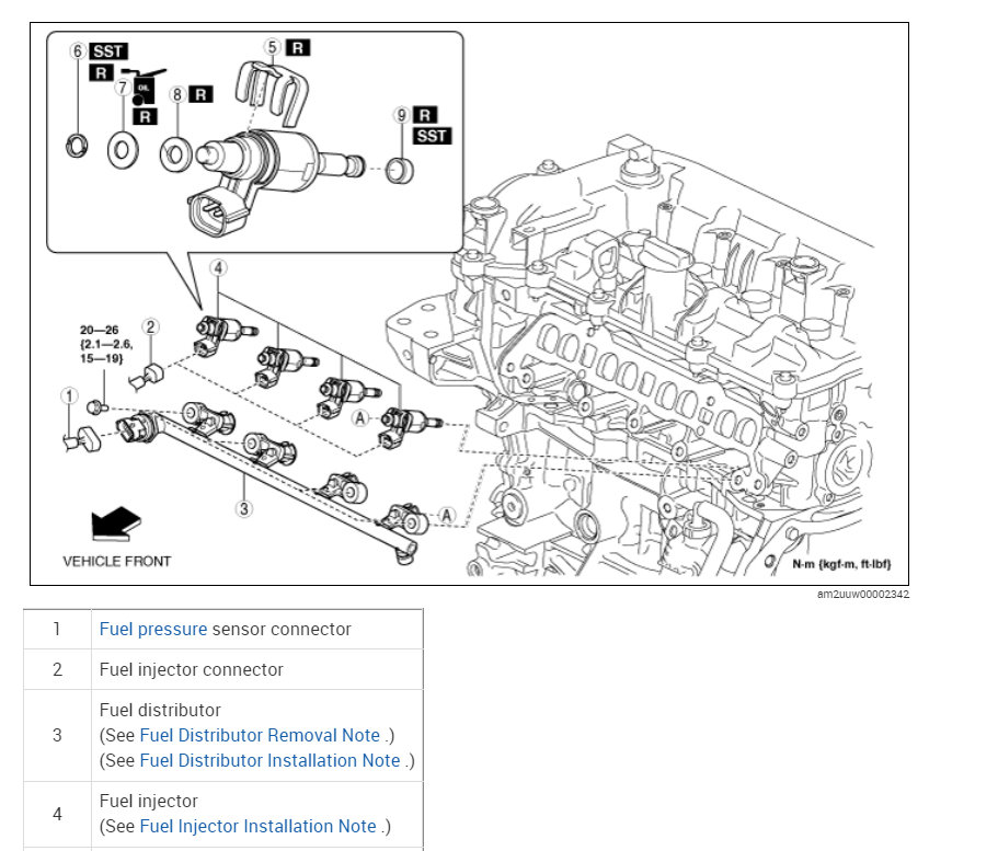

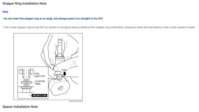

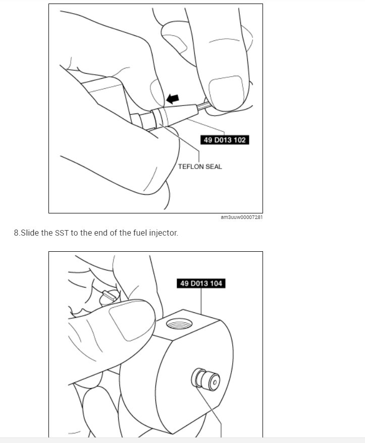

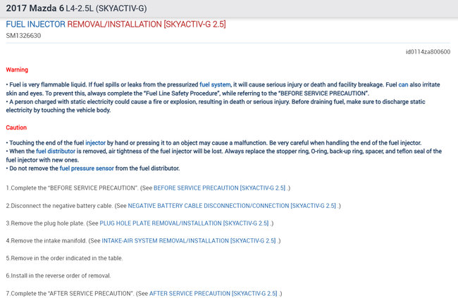

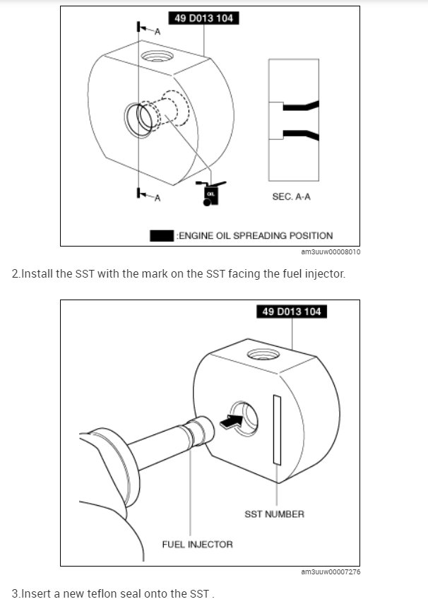

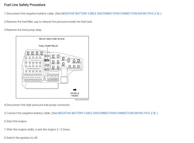

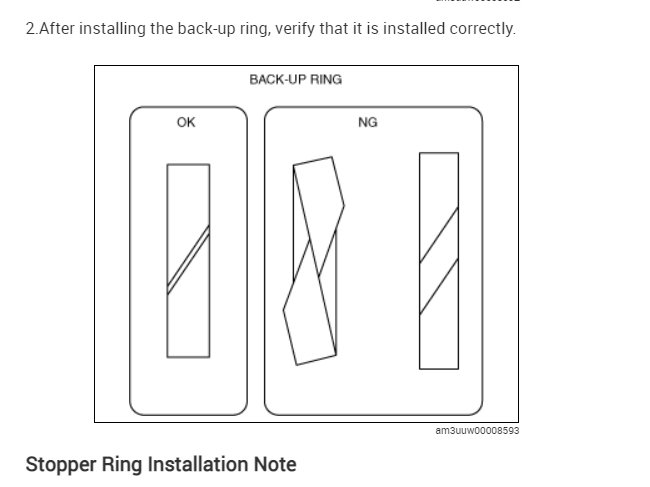

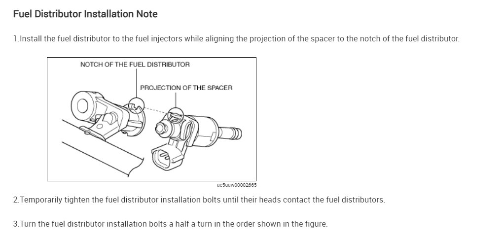

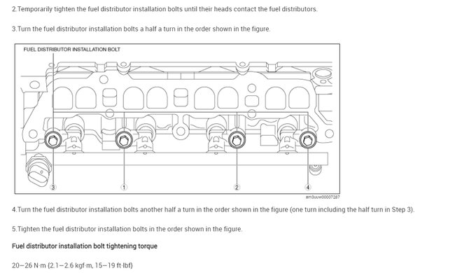

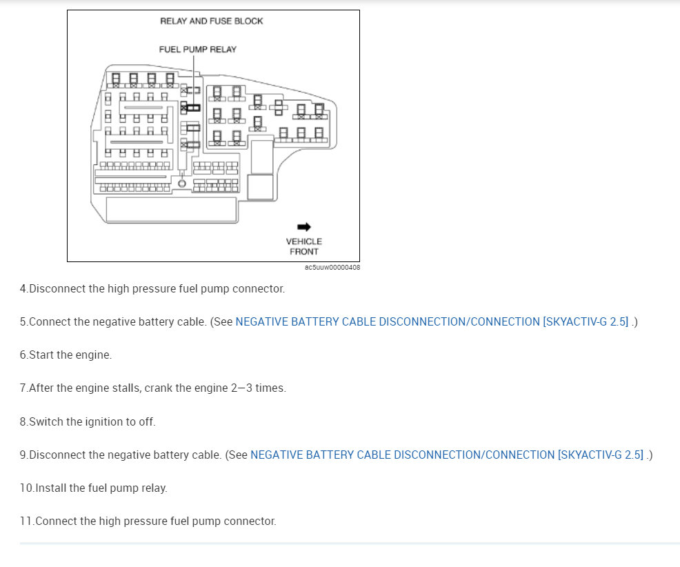

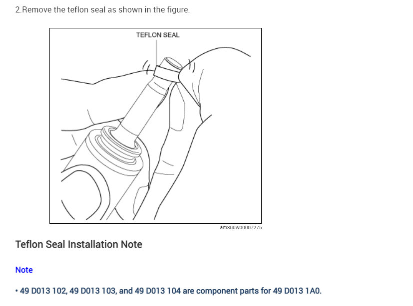

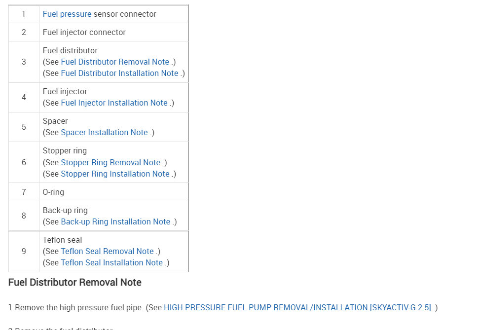

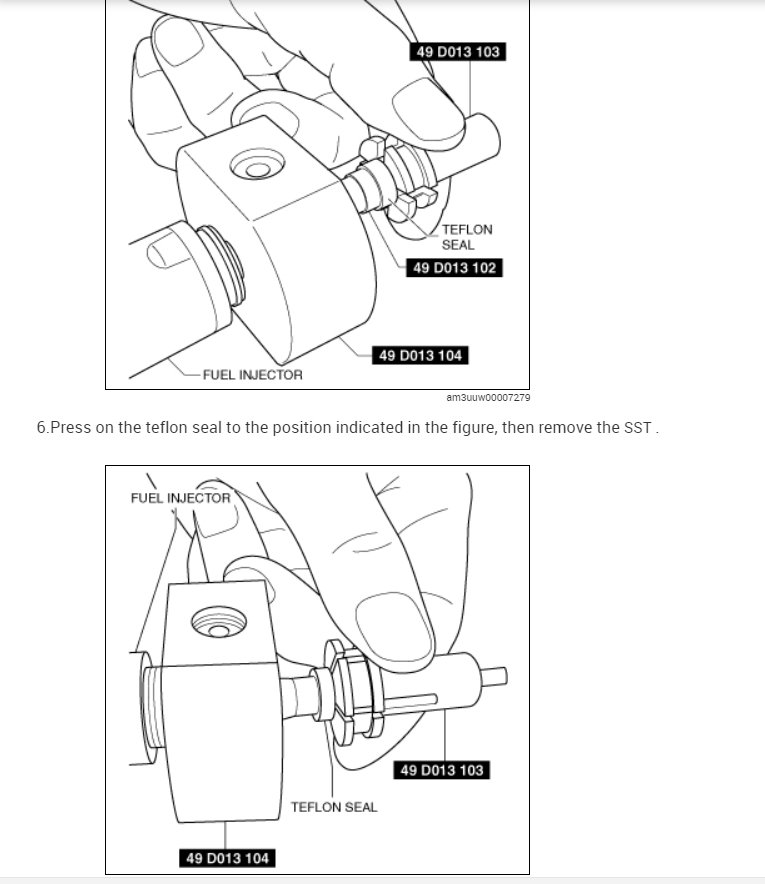

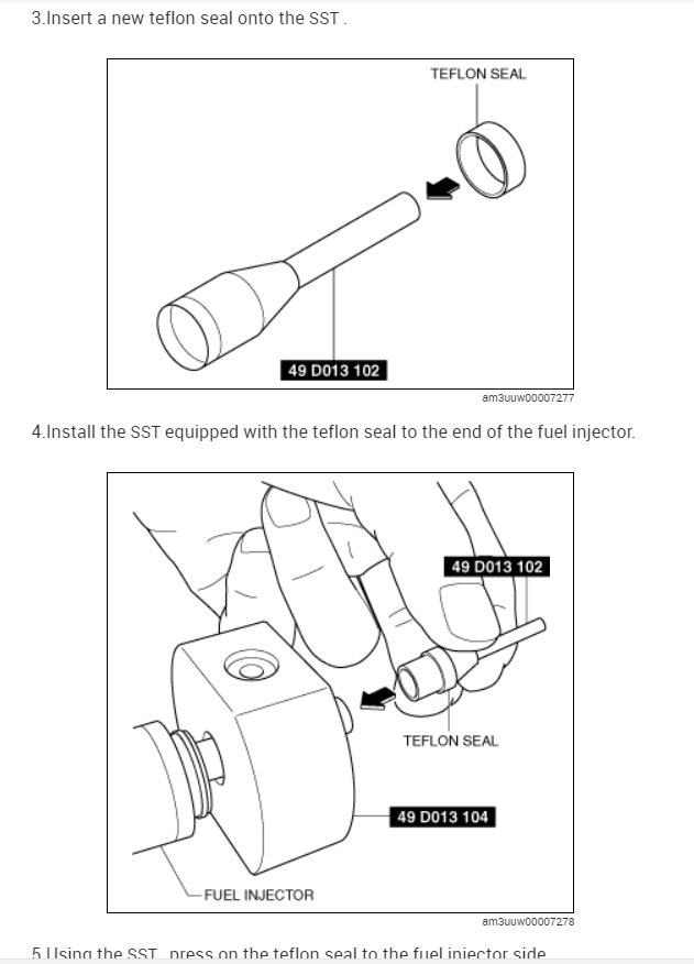

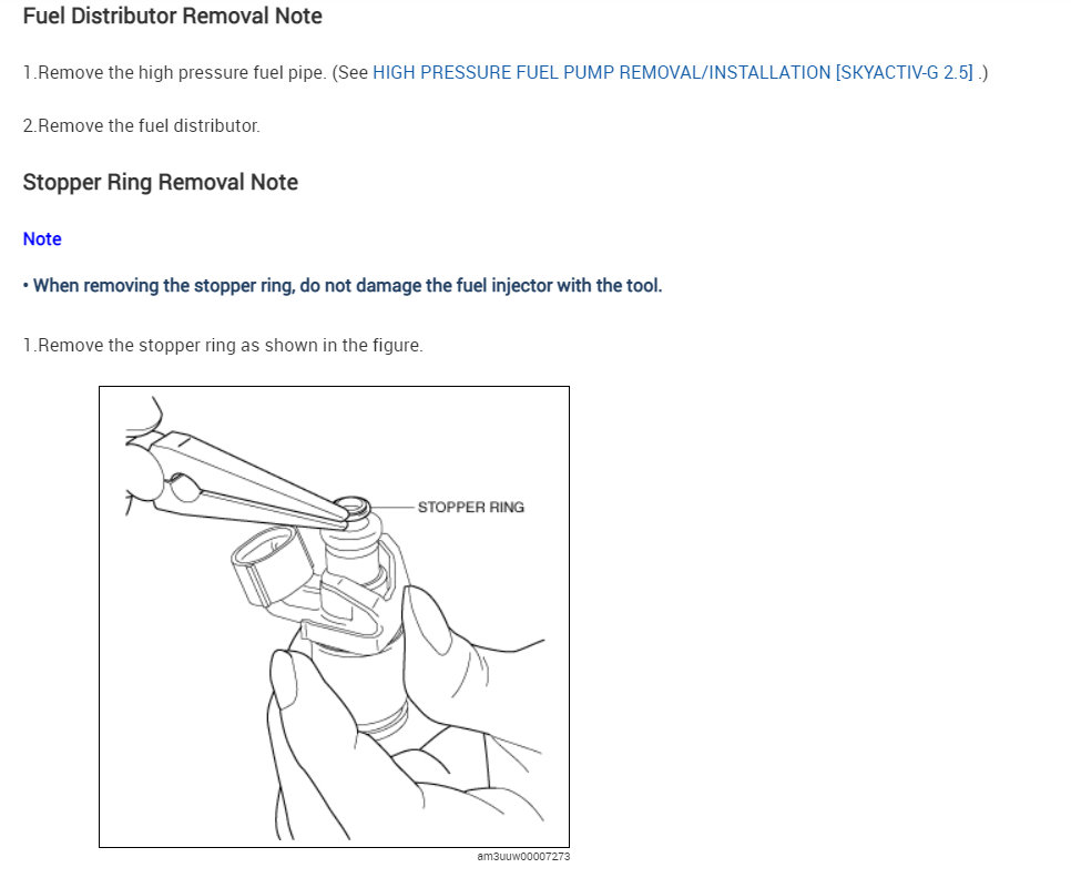

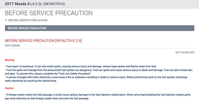

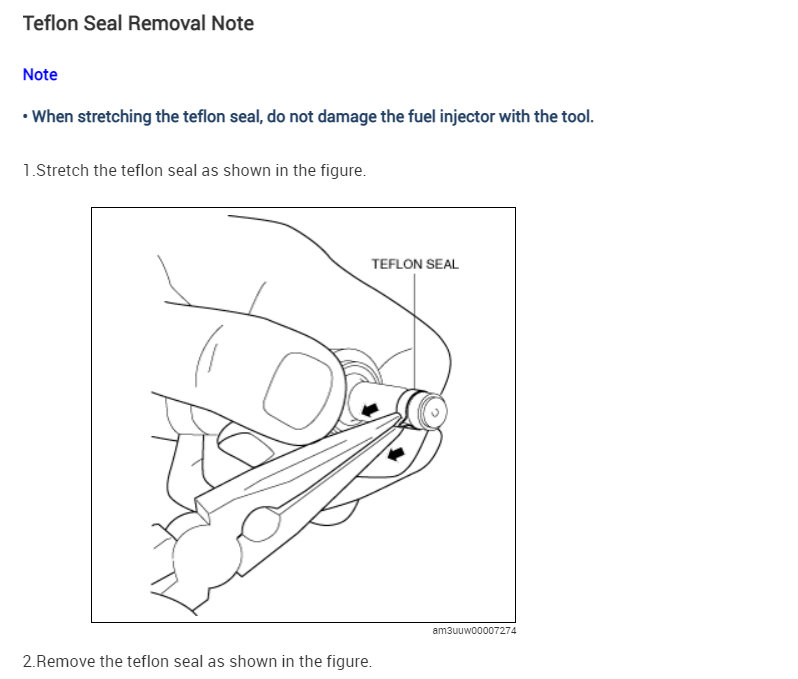

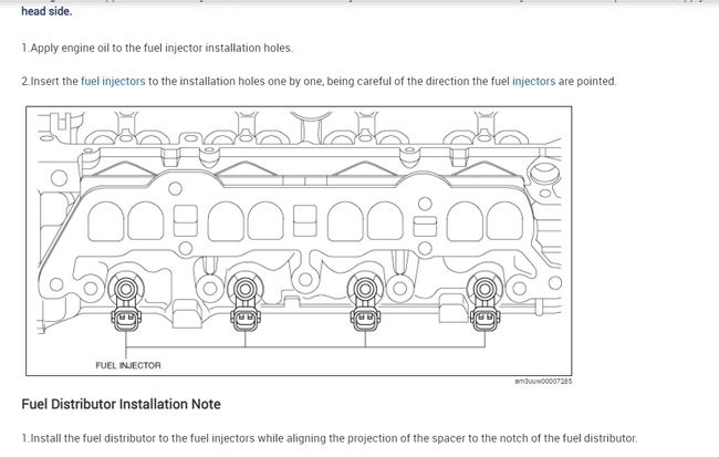

Yep, I would replace the #4 injector, it must be getting clogged which alters the spray pattern which is most noticeable at idle. Here is how to change the injector out in the images below. Please go over all service precautions before you begin, (last three images). Check out the images (below). Please let us know what you find. We are interested to see what it is.

Thanks for your response. It's just that I got a mechanic to move the injector from 4 to 3 and the misfire did not follow, so wondering if it is actually the injector at fault.
