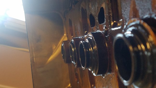

BREVELY710
As soon as I start up my car heavy white smoke comes out. when I continue to drive it still comes out. there was oil in my intake and throttle body so I do not know where the oil is coming from. I changed out my spark plugs and it is still. had no compression on one of the cylinders and the car just smokes when it is idling. it does not smell normal or too good. I checked the head gasket but I did find this.
Jan 4, 2021 at 4:33 AM (Merged)
BREVELY710
In the picture below you can seal the spark plug valve seal is ruined.
STEVE W.
  • 15,349 POSTS
Heavy white smoke and no compression sounds like a failed head gasket letting coolant into the engine. Only real options are to pull the head and either replace or rebuild it. If the body is in good shape and you like the car you might want to just drop a used engine into it. If you have the tools you could tear it down and see what is the problem. Then decide if you want to rebuild/replace depending on the damage.

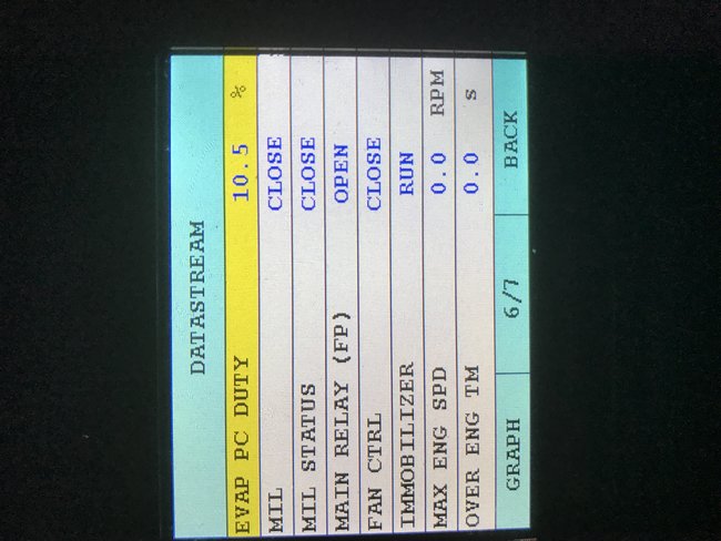

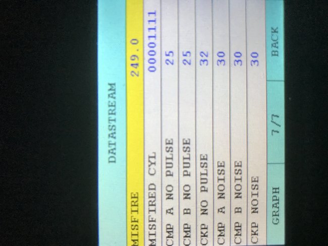

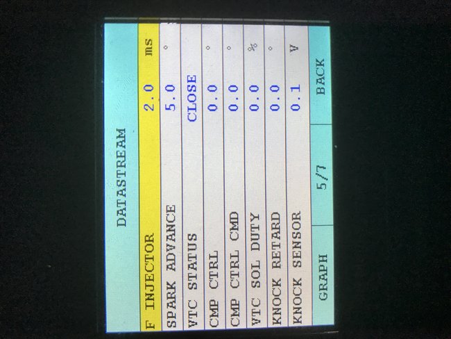

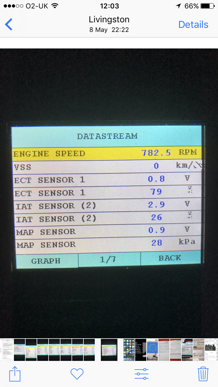

SMIFFSON
My car is misfiring on all cylinders checked the usual plugs and coil packs (Civic type r ep3) my next thought was injectors. I happened to disconnect my IAT sensor and the misfire stopped, I have ordered a new one as it is only £30 but I am thinking it is not the part that is faulty and the misfire is going away due to the extra fuel the engine management is putting in with the IAT disconnected.
Jan 4, 2021 at 4:34 AM (Merged)
HMAC300
  • 48,601 POSTS
if the code is 0300 then it is a random misfire and may be low fuel pressure so check that as well as a vacuum leak like a broken hose/cracked/off etc. See link for fuel pressure.
SMIFFSON
With the IAT sensor disconnected
SMIFFSON
IAT connected
HMAC300
  • 48,601 POSTS
do a compression check and get back with results as well as fuel pressure like I asked the first time.
