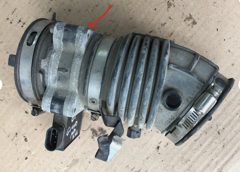

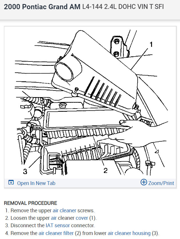

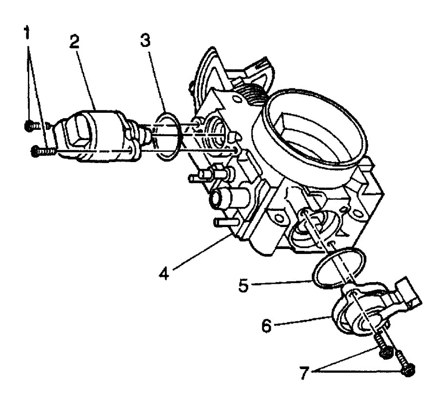

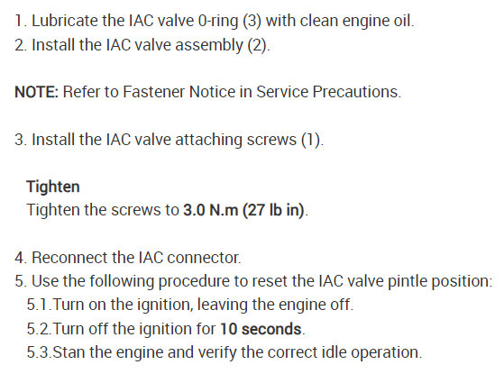

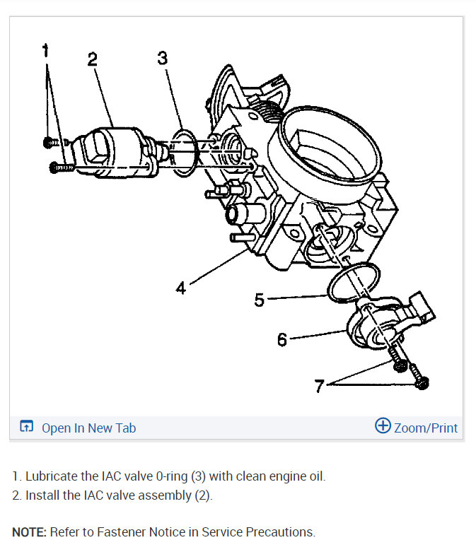

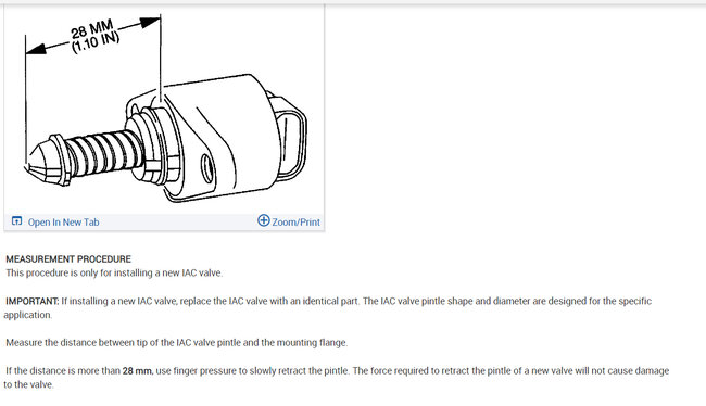

Even though there are no codes you still can have a MAF sensor that needs to be replaced, also I would service the throttle body and Idle air control valve. These are both normal service items.
Can you please shoot a quick video with your phone so I can hear the noise? That way I can tell for sure what's going on. You can upload it here with your response. We need to hear the noise, so we know which direction to go to help you fix the car. It takes time to upload so please be patient. Check out the images (below). Please let us know what happens.
