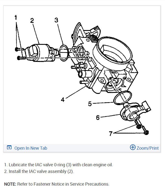

A few months ago, we had an issue with the timing chain. We replaced timing chain and guides, coil packs, coil pack housing, injectors, plug and boots. It ran great for about a month. Now my idles at 500 RPMs when warm. When I stop it seems to sound like it’s going to stall out, but it hasn’t yet, it’s using more gas than normal, and it has lack of power when speeding up on freeway, and There’s a loud rattling noise (only when at operating temperature).My son scanned it and it’s not throwing a code, no check engine light. He checked my oil pressure which is fine when cold but once at operating temperature it drops very low. I’m not sure what to do next.

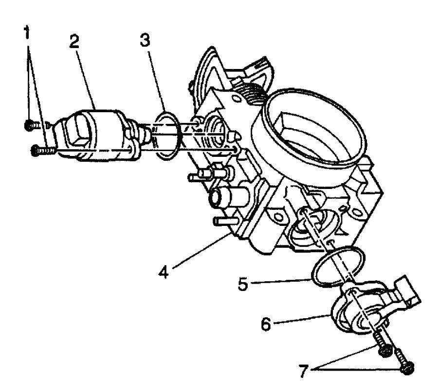

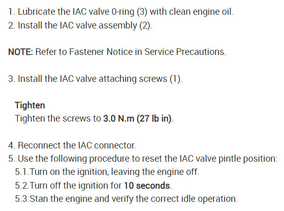

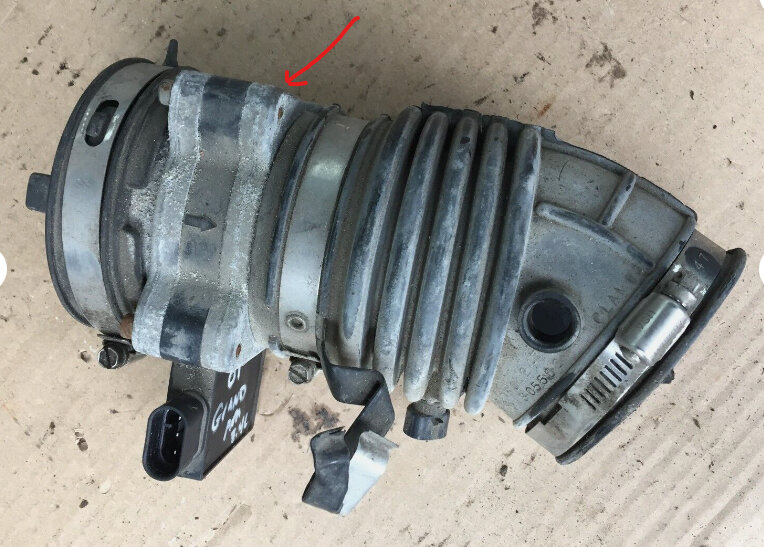

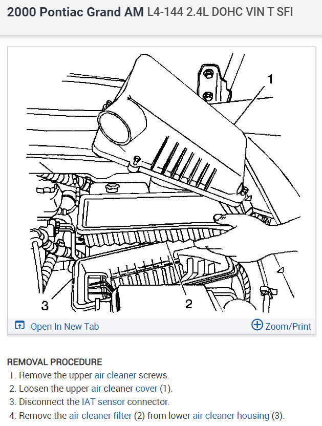

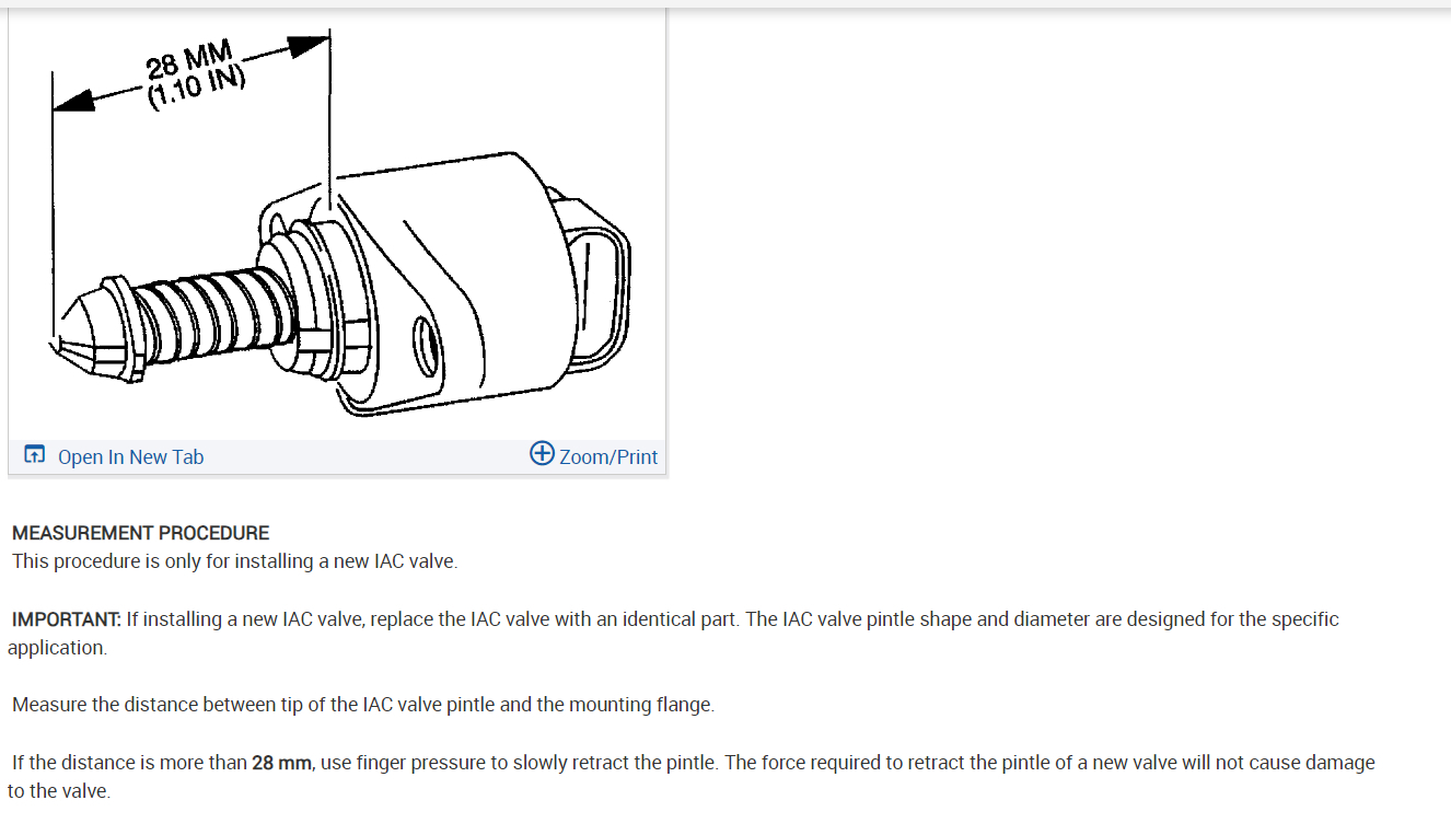

Even though there are no codes you still can have a MAF sensor that needs to be replaced, also I would service the throttle body and Idle air control valve. These are both normal service items.
Can you please shoot a quick video with your phone so I can hear the noise? That way I can tell for sure what's going on. You can upload it here with your response. We need to hear the noise, so we know which direction to go to help you fix the car. It takes time to upload so please be patient. Check out the images (below). Please let us know what happens.
